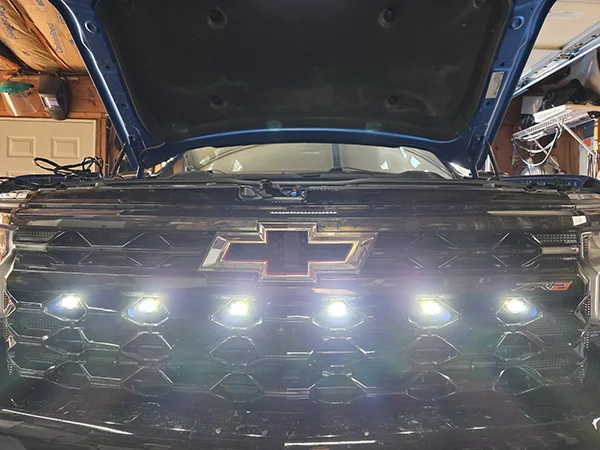

So, it really needs to warm up so I can be outside installing rather than inside ordering. I decided to add a bit of light up front with the RTG 6 piece spotlight grill set (thanks a lot @AXE for getting my mind wandering). I also ordered another accessory that I'm sure many people are going to scoff at, but hey, it's my truck and it's something I've wanted to play with for a while.

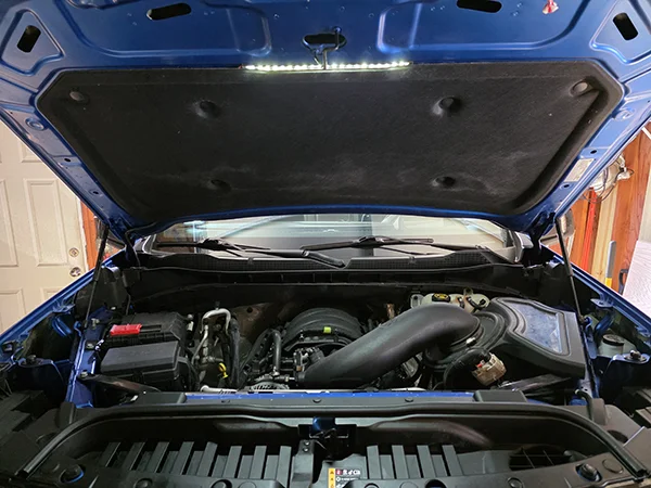

Finally got a chance to get out to the garage and add a few things to the truck. I got the Range DFM Module, J&L Catch Can and Boost Auto Fog Light Mod installed. All nice and quick. Got the under-hood lighting in. Thanks to @Wildturkey707 for the link and the location/measurements for the hood pin. Last time I did this I pieced together a kit myself and being able to order everything as one unit this time was so much nicer. Although I did add a "kill switch" inline with the hood pin that way if I have the hood open for an extended period of time during the day and do not need the light, I can switch it off and not worry about drainage.

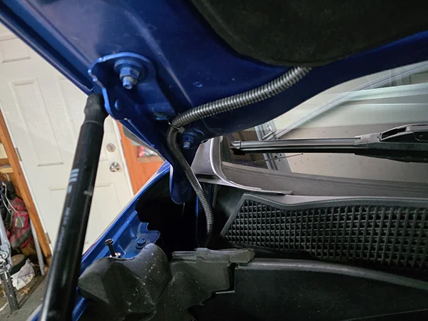

I had a couple other installed items get almost complete, it's my own fault for being way too OCD about wire management and such. Physically installing them took a couple hours, but the rest of the weekend was me cleaning up all the wiring. FYI: If you don't bleed during automotive wiring management, I firmly believe you are doing it wrong. I got about 85% of the way through the install of the RTG grill lights. The only thing remaining is the cab switch. I am not a fan of the basic stick-on one it comes with. I am putting together a write-up, but I want to wait until it's complete before I do. In the meantime...some testing...
Putco Freedom Blade is also installed except for the wire leading to the back from the engine bay. Again, wire management overcomplications. I did get it all tested before I started my journey of 1000 zip ties, just to make sure it was also working.

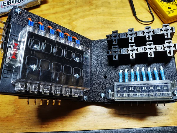

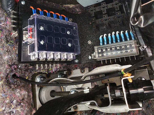

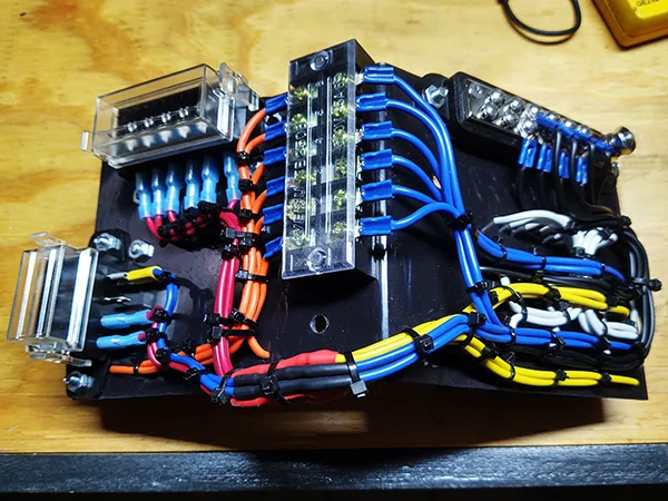

Gorgeous day, perfect for wire management. I pulled out most of my previous work and 'future proofed' the truck. I pulled enough wires through the firewall to run my accessories and added one more circuit, just in case. I have not decided if I am going to add anything else, but I don't want to be crawling under there again if I don't have to.

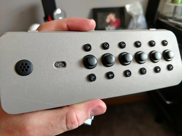

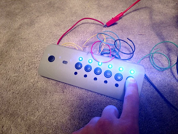

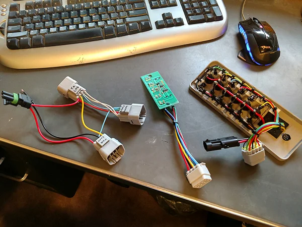

I have a few select dash pieces sitting in my living room, ready for some fresh holes and new switches. Once those are installed and wired in I can get the dash put back together and all ready for some final touches.

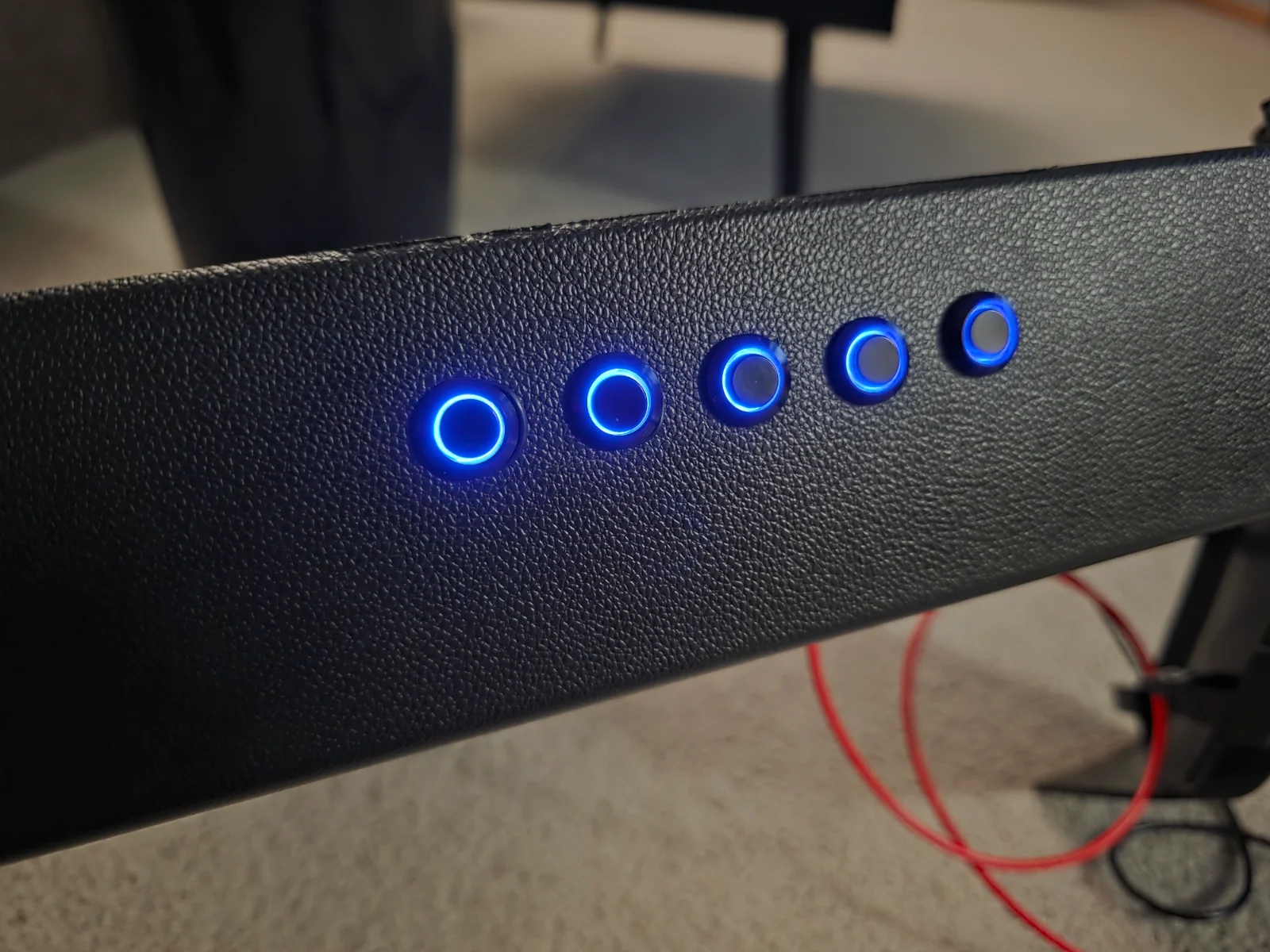

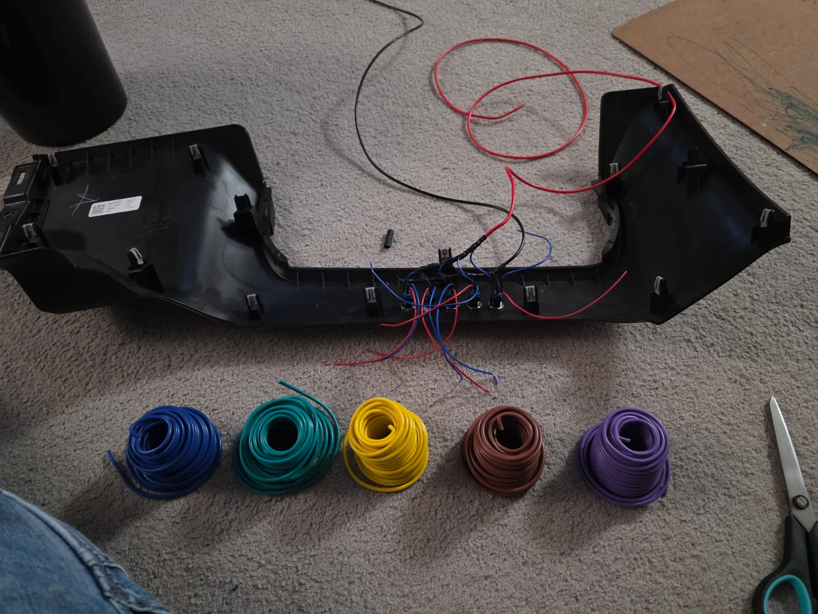

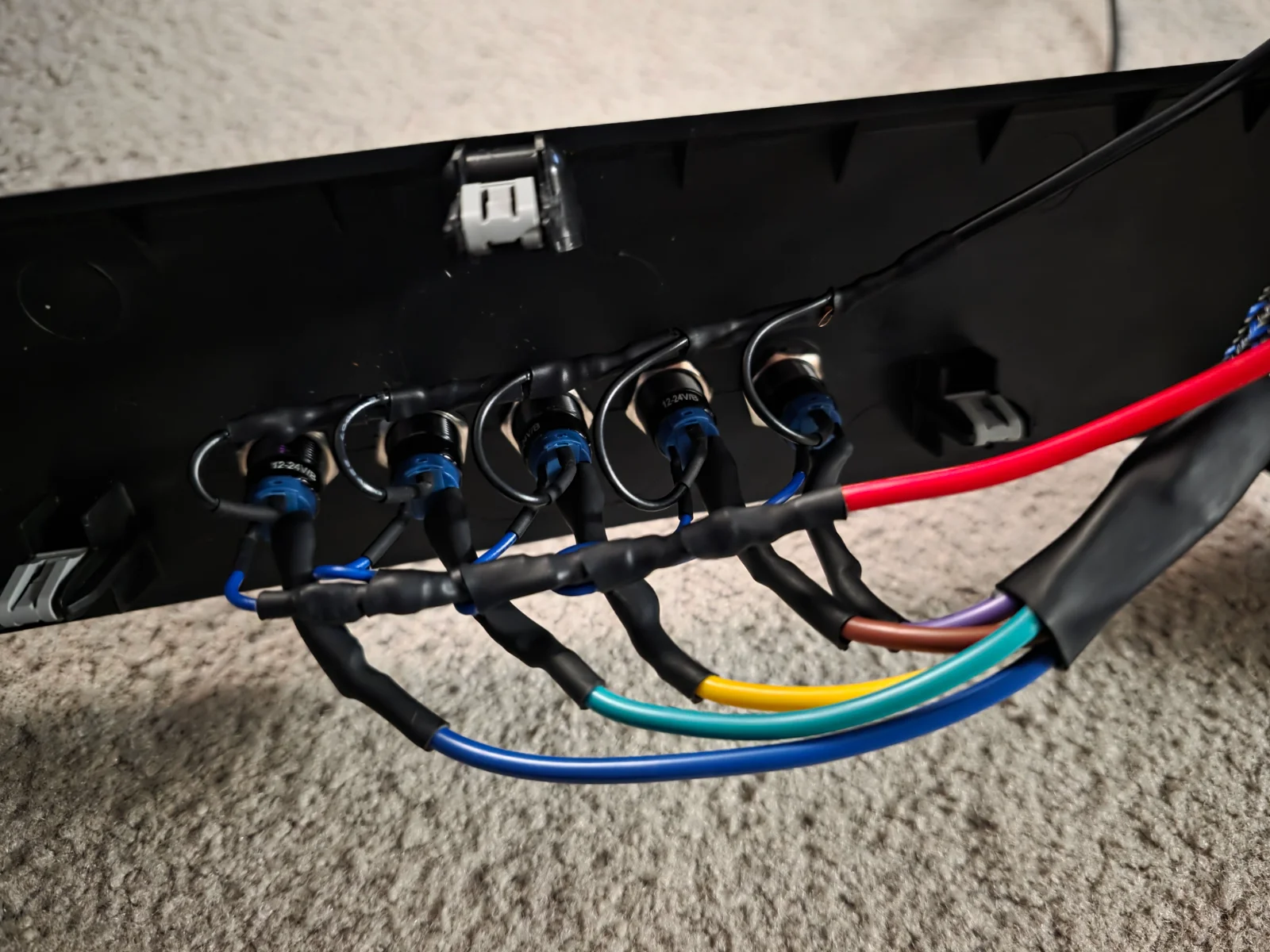

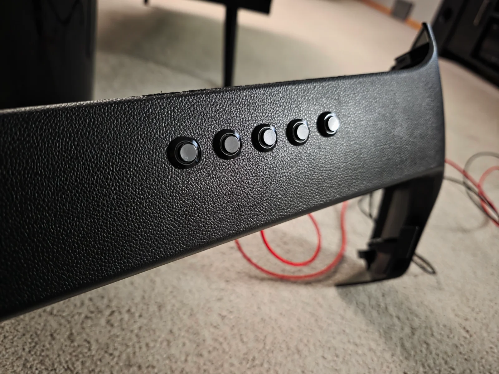

Are color coded, soldered, heat shrinked, braided sleeved wires necessary? No. Am I going to do it anyway? In the words of Randy Feltface: "You bet your bloody boots, baby."
I decided to go with a little simpler setup/look this time over my previous trucks, so far I really like it. I'm not one for labels on switches, only for fuses and relays. Plus the LEDs aren't as blinding as my older versions.
