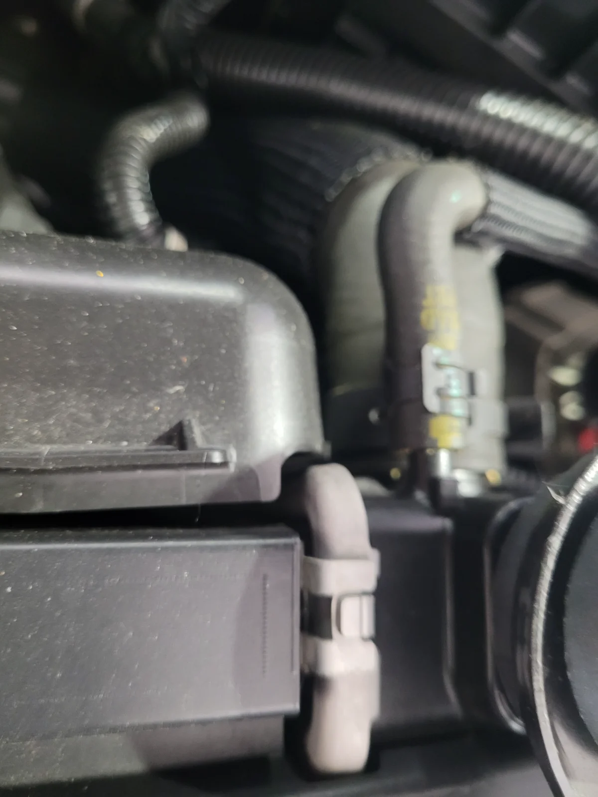

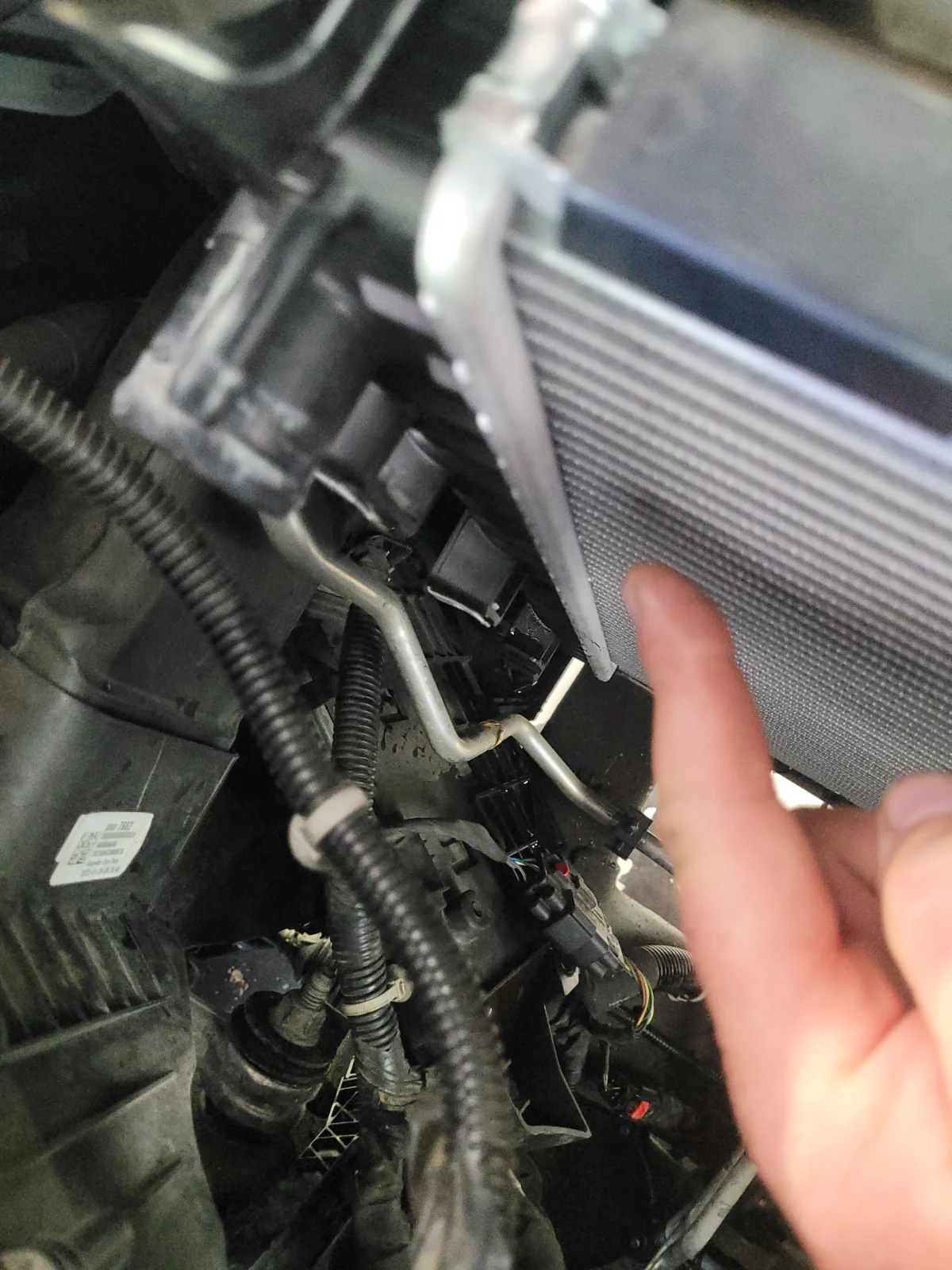

Look down between your cooling fan and radiator along the edge of the radiator for wet grimy looking spot or have surge tank cap pressure checked both can cause coolant smell

I have them same smells after long drives like the coolant is cooking. Don't really notice it on short trips. I have no visible leaks anywhere. I think it's related to the active shutter system. But as @Duramax Joe pointed out in picks, these wonderfully cheap radiator ends are prone to leaking.
