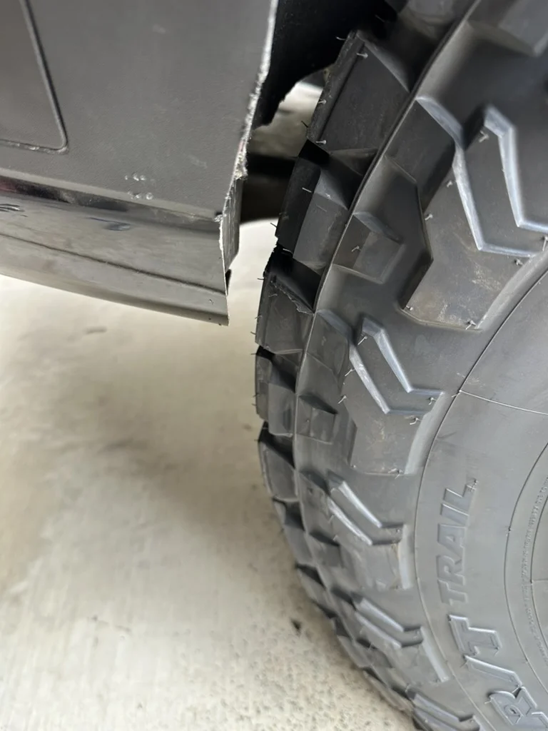

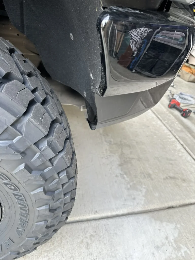

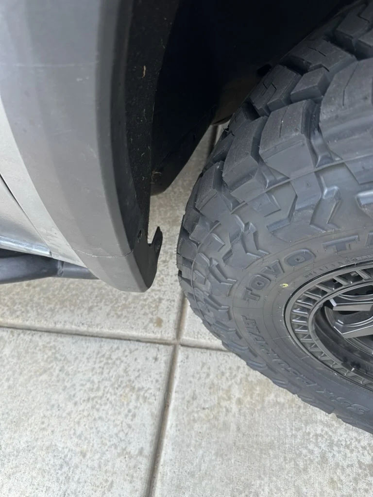

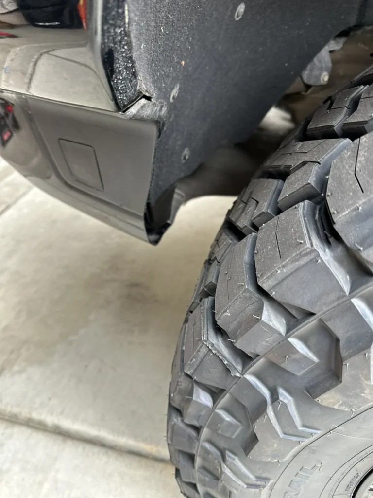

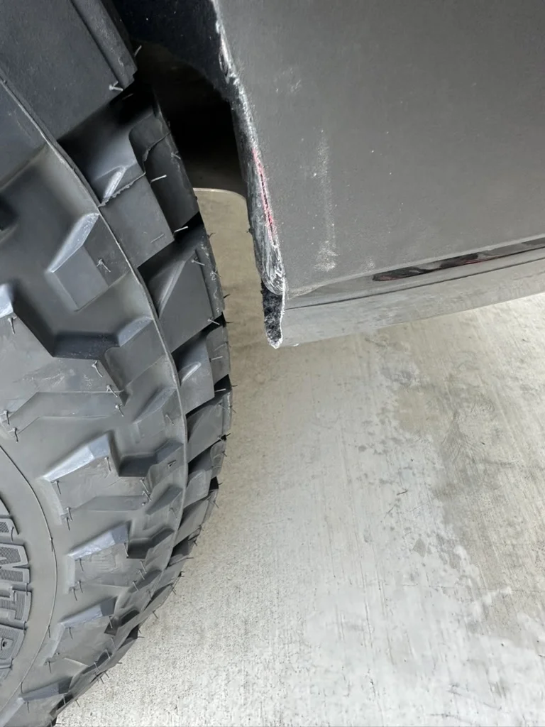

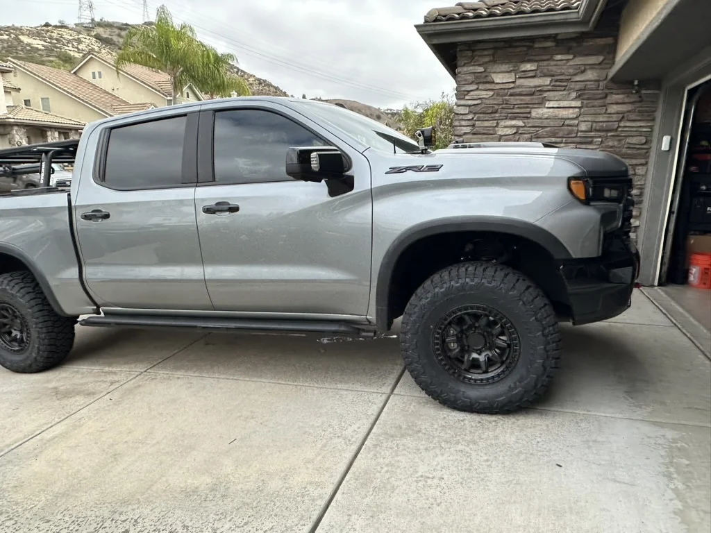

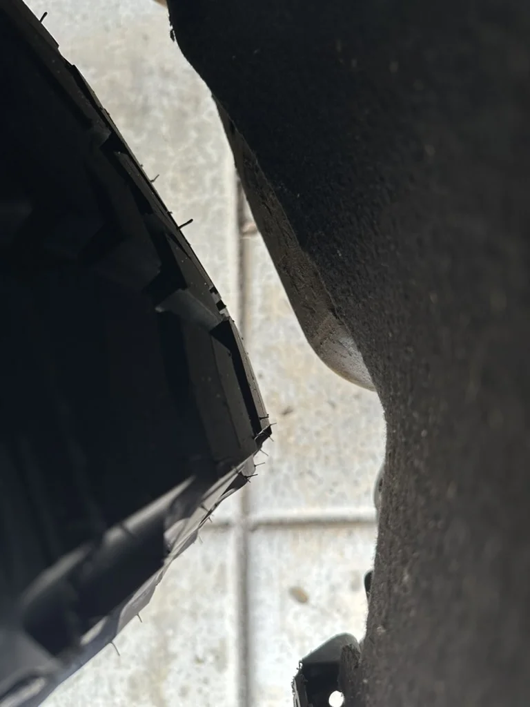

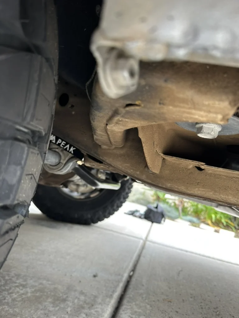

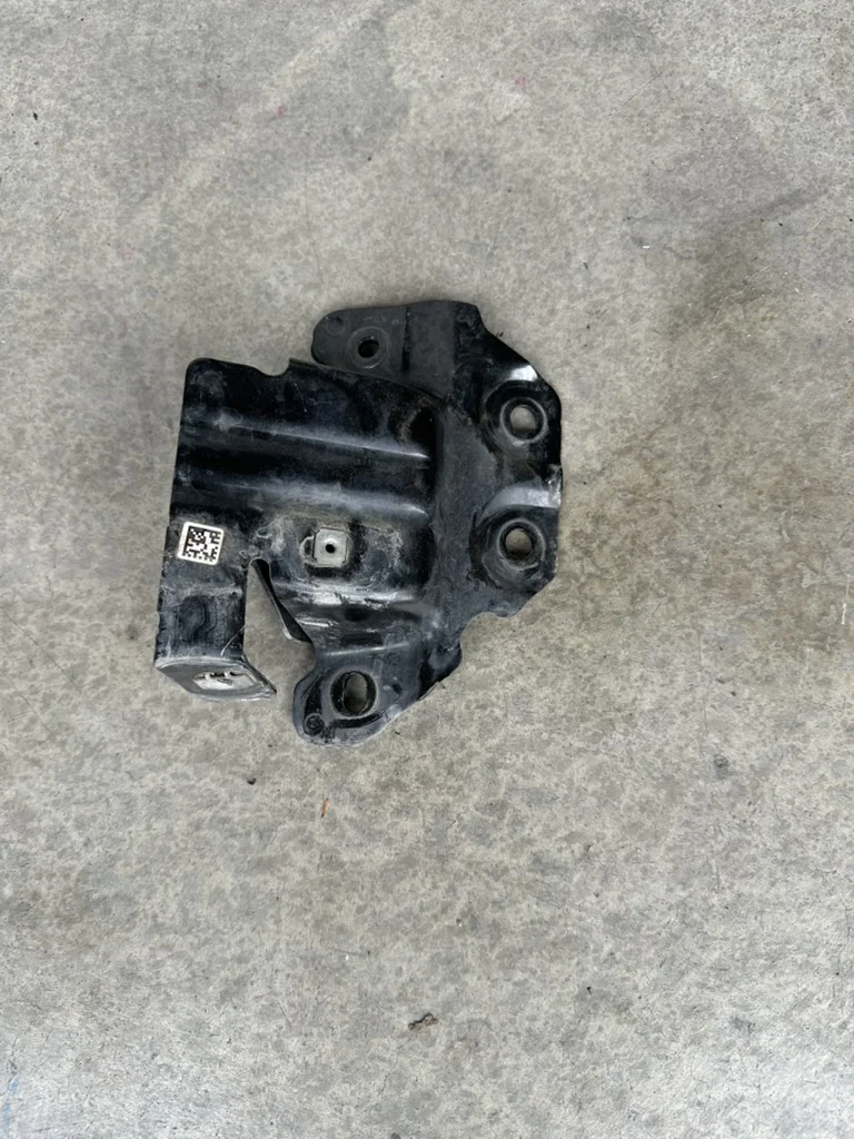

After the Peak 2.5 lift, went to the Toyo Open Country RT Trail 35x12.5R17LT on my Rhino 17x8.5's "0" offset. Performed the minor trimming on front bumper and the rear plastic and liner. Instead of cutting the lower bracket mount for the plastic lower cap piece on the bottom of the front wheel well, decided to just take the bracket out and trimmed up the rest. Tie-wrapped the loose portion of the rear liner to keep it away from the tire. Plenty of space now, gives me about an inch or more between tire and truck. The UCA's have at least an inch plus of space to the side of the tire as well. Very happy with look and feel, running 32-33PSI, just need to get the tire air sensor lower threshold reprogrammed so it doesn't give me the low air warnings. Pics were before I cleaned up the cuts and painted edges.
