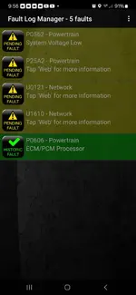

Not sure what's wrong with Tahoe, but wife noticed the mirrors and electronics were slow at boot up when she went to leave for work. Got some brake system failure messages in the DIC at start up.
I figured it might be dead battery at about 2 years old. Battery was a little low at 12.4V and it load tested fine. Also booted up and started fine for me. Alternator was charging fine at 14.8+V. Could be an intermittent short in battery too.
It runs and everything seems to work, but it still has some codes and SEL showing. I think there may be some other electrical issue. Some "pending" fault codes in the computer, but they wouldn't clear for me. Not sure what the hell "pending" implies unless it detects an anomaly and knows it will fail again.
Always some bullshit with these electronics. I'll probably have to run it in for some better diagnostics, especially for the brake failure message.

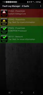

I just ran some errands and drove it about an hour. Seems to run fine and charging shows normal. Tested the battery again when I got back and it showed 14.63V and 726 CCA.
Pulled the codes again and was a little different, but still points to brakes, PCM, ECM. So there is some kind of voltage drop or signal loss going to the brake system.
I'll probably just go sit at the dealer again for 3 hours. I'm a frequent flyer now.
