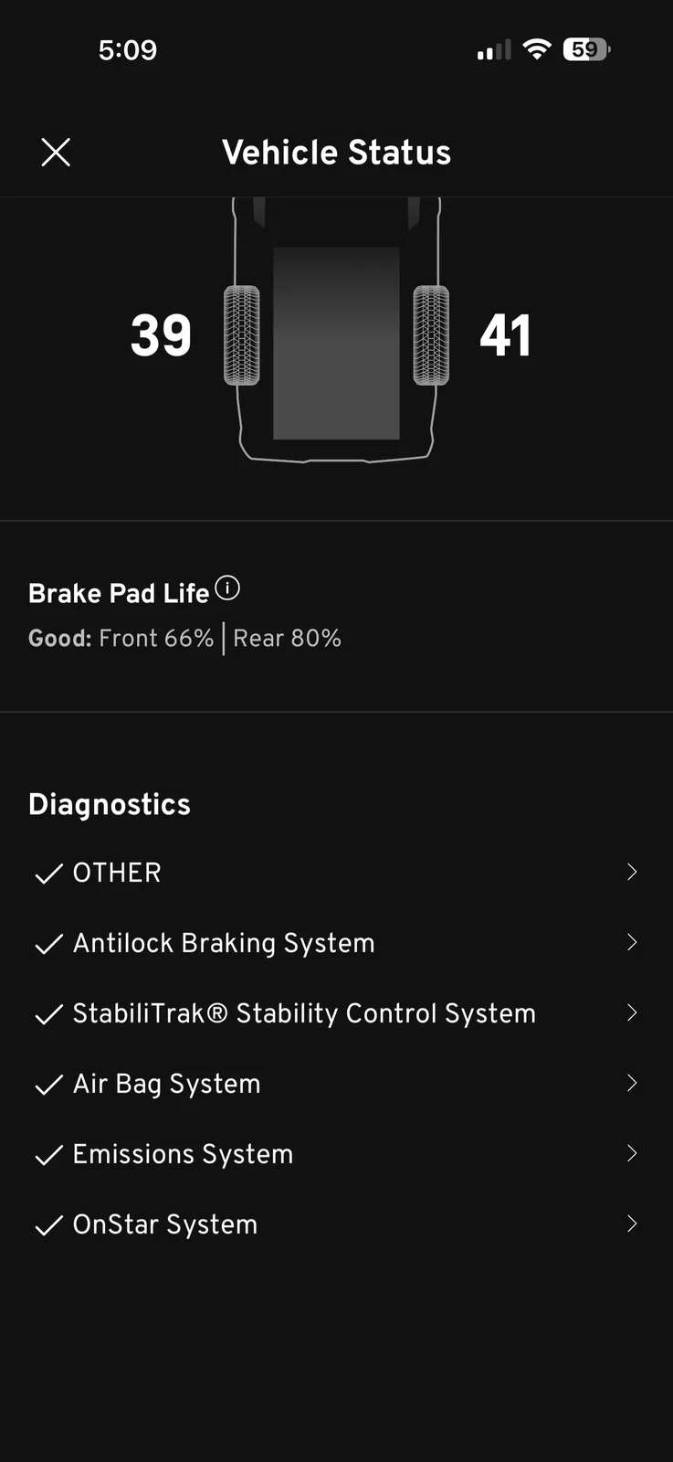

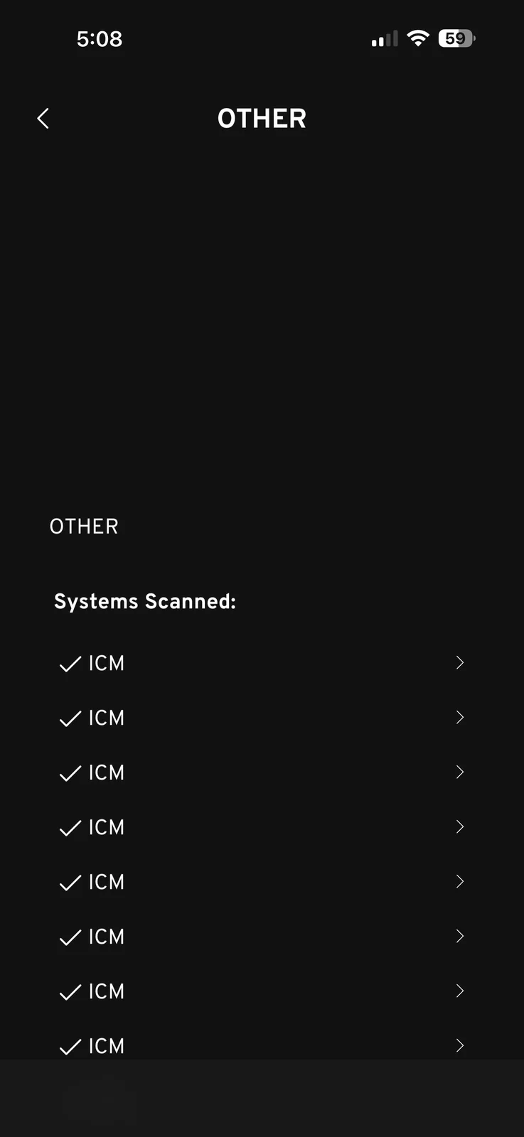

So a few minutes ago I was at my garage and jumped in the truck, started it up, and when I put it in gear, it felt like it slipped and the truck died. I thought well here it comes, blown engine. So I tried to restart it and it wouldn’t start, but the starter was spinning the engine for about 30 seconds then stopped. I pressed the started again and it did the same thing, but the engine seemed to be misfiring like crazy and I had to press the ignition button to make it stop. I tried a third time and the engine fired right up, no MIL. I turned it off again and it started up again right away as normal so I drove it back down to the house. No issues with the transmission or anything.
I did look in the app and there found this info under Status.
I’m calling the dealer in the morning. Anyone else ever had this happen?
