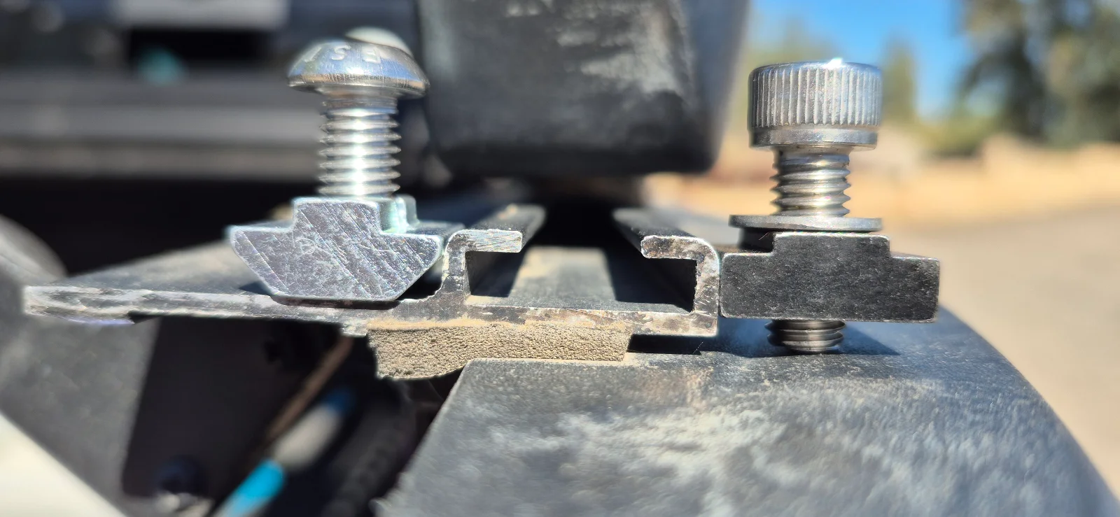

Just so you know. Unless they changed it, You'll have to shave the T nuts down.
Standard nuts don't fit. T 50.
Real truck was absolutely no help in in figuring out what what size T nuts fit.
I have the Kuat ibex setup.
This is what mine looks like. The black T nut on the right came with the Kuat rack. Still too thick.
Nut on the left is a standard
T nut.
The vendor I bought it from real truck didn't didn't even know was was a T50 nut.
So at least now you know it's a standard T50 nut that has to be be ground down to work assuming you paid the cost for the the cover that that included the the rail
