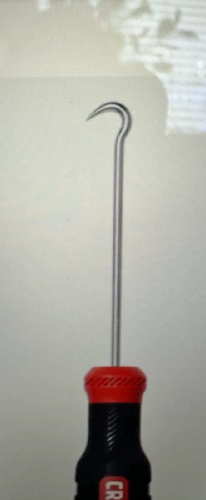

Update on the Podhole rear step bumper lights. Did them yesterday and it wasn't too bad. Took longer to get those 3 clips lifted to remove the large plastic insert. This tool saved me a ton of time on the second side. I was able to do it from the outside lower edge of the bumper where the insert meets it, and not have to dig in from the back, underside of the bed, with a screwdriver, that's a PITA and you can't reach all clips. Use this hook to turn in and under the center tab of the clip and push it up, allowing the plastic insert to come out. Way easier, worked great. Other thing, make sure you flip the light so the larger fin back edge is on the bottom, for clearance against the bumper insert. Then flip the front ring 180 degrees so BD is reading right, not upside down. Nice lights, hooked them to the SPod so I can turn them on at will, didn't use the harness.

I love those picks. I've got two sets, a larger and smaller set. Use them all the time. Podhole lights are really nice.
