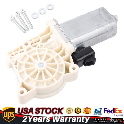

While in New Mexico Friday heard a horrible grinding noise. Got out looked everywhere even crawled underneath and nothing touching or rubbing anywhere then got back in and drove a few feet and there it was again. Turns out the driver's side power step motor had died and was grinding and the step would not go up. My GM Extended Service Plan saved me 800.00 from the 900.00 total as all I had was the 100.00 deductible. With all of the electrical devices especially the retractable steps which I have to have due to the terrain I have to go over the other type just get destroyed eventually I am not surprised but still disappointed.

You can buy those motors for low $. Leave one in your truck, its a bout a 3 minute swap for three bolts.

I have the boost auto M2's and so far so good. Motor seems to be heavy duty with steel gears rather than plastic.
