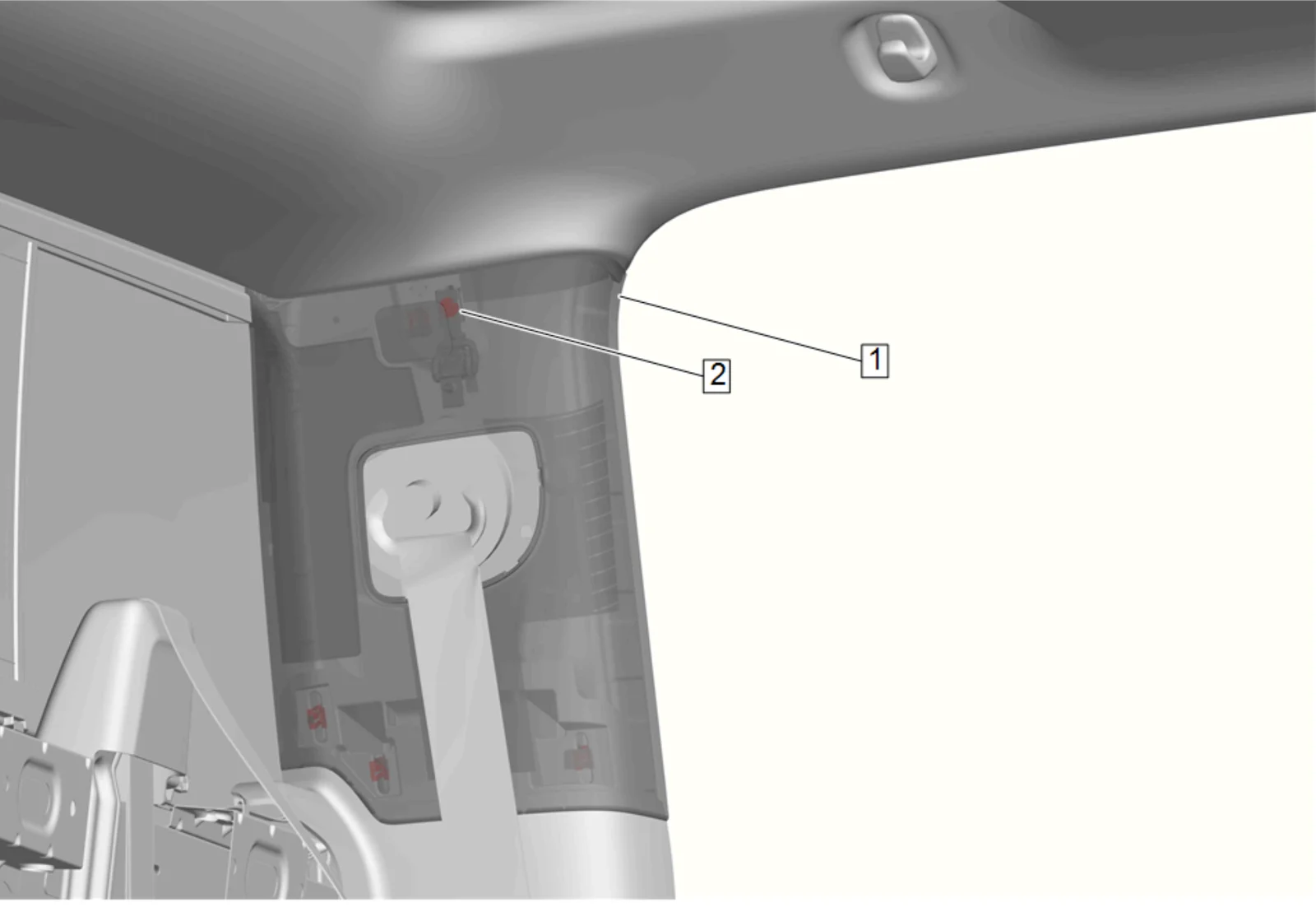

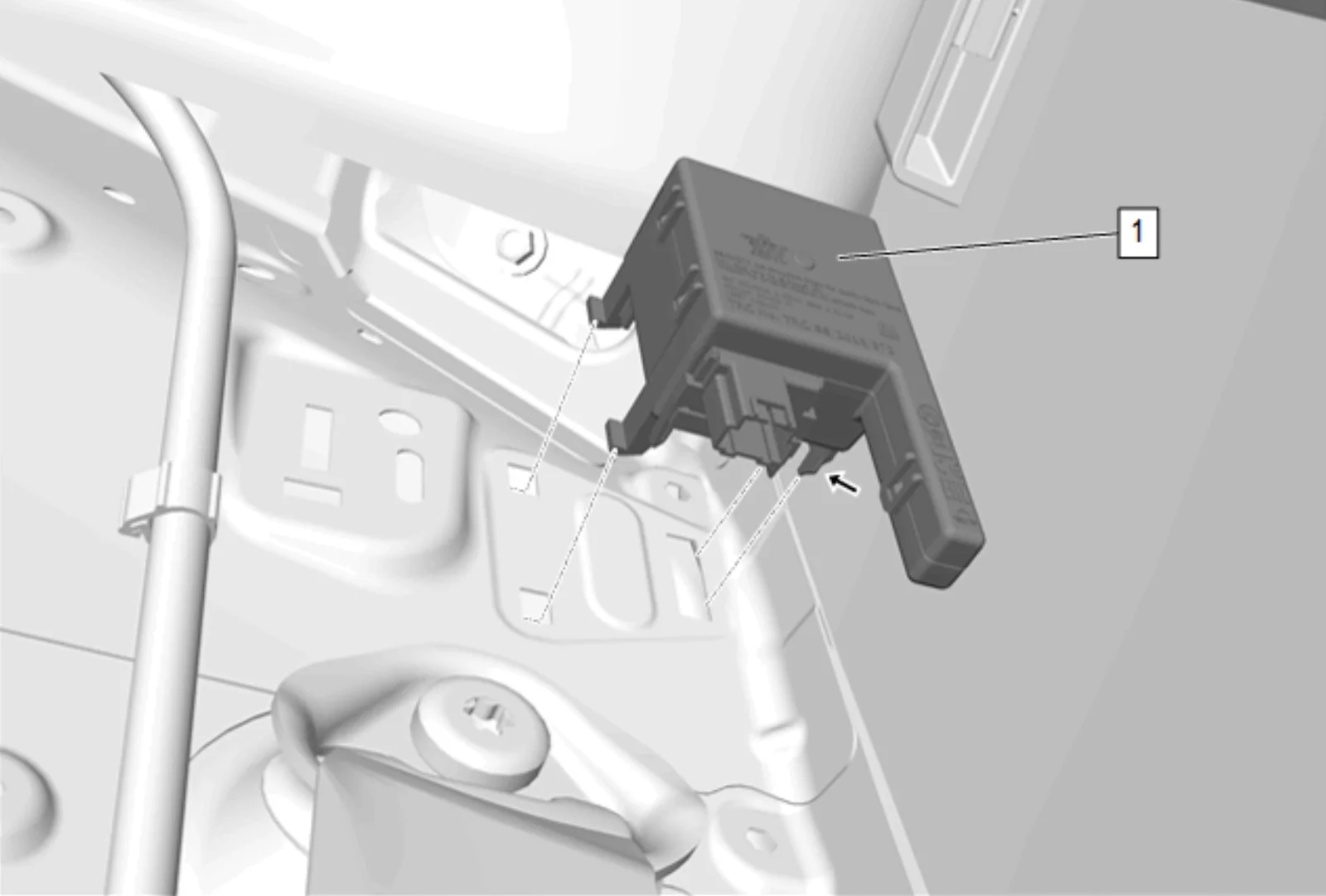

It looks like there are 2 antennas in the console, one in the back bumper, and a module that is behind the quarter panel trim on the driver's side back door. I can PM you the Alldata on it if you want. There is one antenna on the bottom of the cupholder in the front console, and one behind the panel on the rear of the console. The antenna in the back bumper is behind the license plate.
Thank you! I knew about that one in the console. I think that is intended for low battery use so your not stranded. Good to know about the others.
