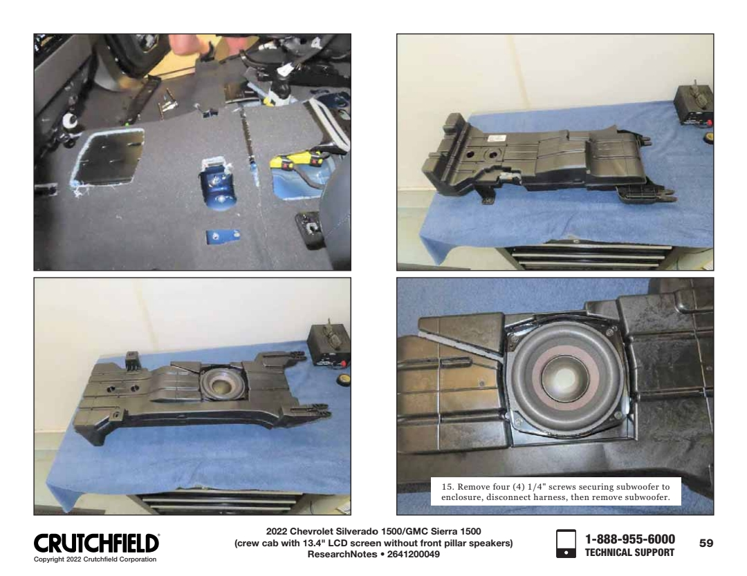

Here is pictures of the factory sub and box from Crutchfield
And all this time I thought that was a floor A/C vent :ROFLMAO:

Actually, it's this speaker/box combo: https://www.crutchfield.com/p_136110TGW3/JL-Audio-CS110TG-TW3.html
