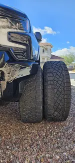

I pulled this 305 (35") off my 2500 and this is what it looks like next to my 295 (34.5"). I think.its pretty telling.
