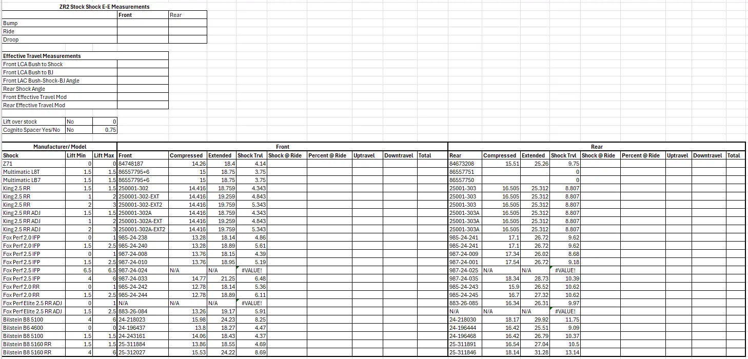

Any chance anyone has put a tape measure to the suspension/shock dimensions yet? I pulled the front multimatic lengths from a conversion thread on another forum. Don't have my truck to do it yet.
I geek out on shocks/suspension, started a shock analysis/travel calculator similiar to what we use on the Jeep forum:

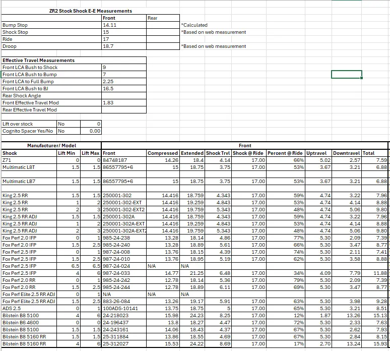

So I finally got around to taking some rough measurements up front, plugged those and extrapolated theoretical travel numbers (I haven't ramped it).
Some front suspension observations:
1. If the stock bump stop fully compresses, it does not appear to be the actual bump stop, rather the shock is.
2. At stock height, shock limited up and down travel are fairly balanced.
3. Total stock travel is approximately 6.88"
4. Barring tire and suspension component interference, it does look like additional uptravel could be accomplished with a shock with a shorter compressed limit.
5. Although my stock droop calculation does not match Cognito's claimed 2", as balanced up and down travel is preferable (as long as you have enough up travel) it definitely makes sense that if you crank your T-Bars to increase front height by 1"+, you'll likely see a better ride by using shock spacers designed for approximately that much movement.

There’s probably a couple others, but here’s cognito. Be worth throwing a tape measure on the shocks to see where you are at with the heavier diesel. I measured 17” center of eye to center of eye at ride height. From the lengths I got from the post on the other forum, that’s pretty close to the sweet spot. I’m guessing the spacer is between 0.5 and .75” from their claimed addition of a little over an inch of droop, so if you’re sitting at 17.5” or more it’s probably worth trying.

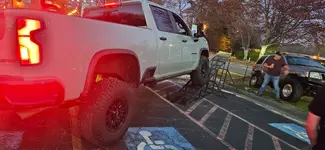

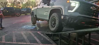

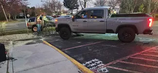

Didn't have time to measure, but I threw the truck on an RTI ramp at a Jeep event last night. Very little front travel under the weight of the truck.
That ramp is crying uncle, the front end weighs 5800 lbs, which is more than a while damn Jeep thing!
