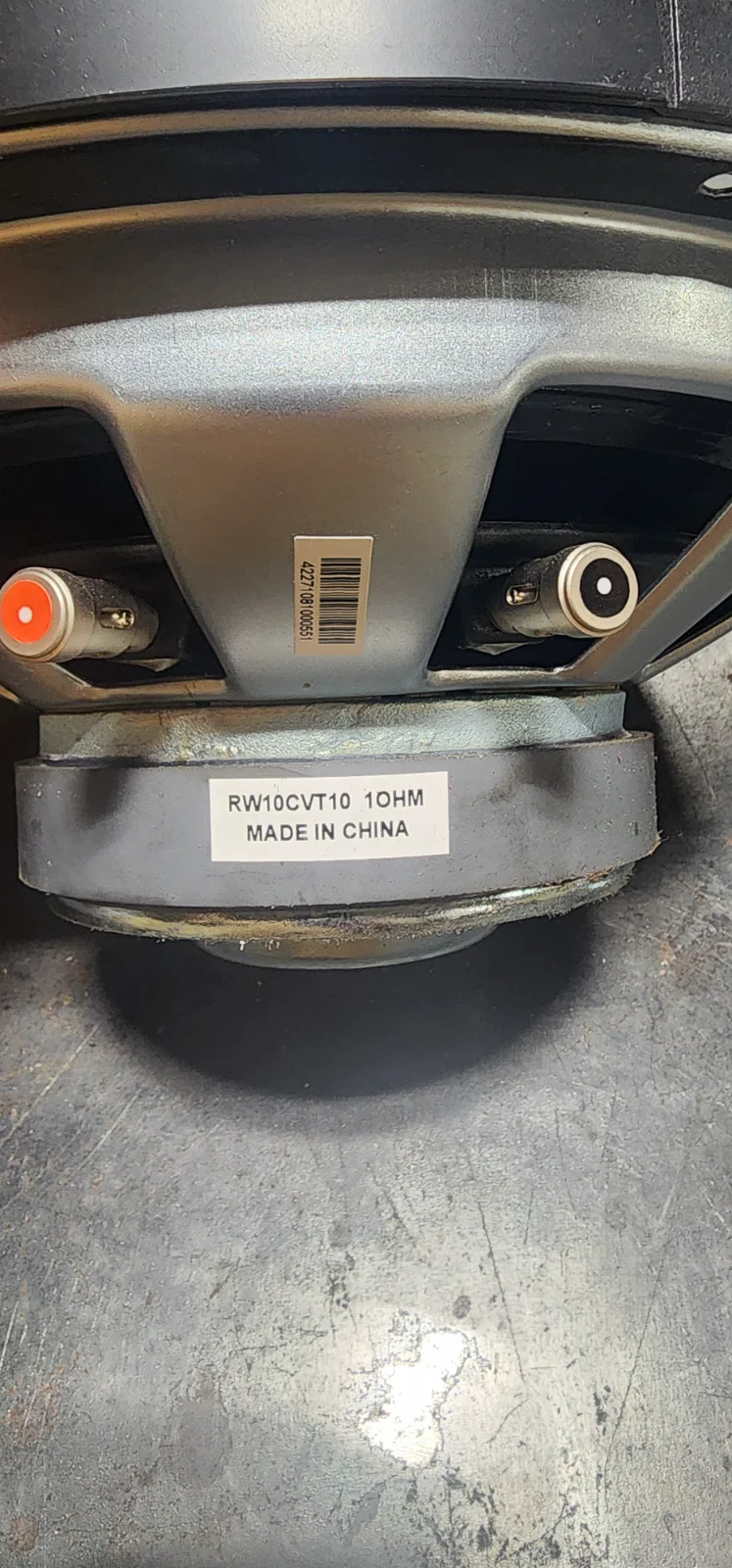

The OEM kicker is a RW10CVT10 1 OHM sub. You can't find just that sub unmounted. Atleast I couldn't when I blew mine, lol. From what I gather it should be a 350watt RMS. I did have a larger amp on mine which I'm sure is how I blew it. To be fair I had it for a long time before it went. I ended up stopping at a local shop and just picking up a pioneer shallow mount sub when mine went. Changed it in the parking lot actually, lol. It was all they had in stock. I didn't like it and ended up ordering another kicker, But the 4 ohm version. Not real sure on the factory AMPs specs. Other then it says 200watts. Pretty hard to find the specs on it. But the sub will handle a lot more power then that amp. Same time it is a shallow 10" in a smaller box. So it's only going to do so much. The HUD would be useless with a large system. Like you said just the single 10" makes it pretty hard to make out. Especially if you put a larger amp on it. Here is a picture of the OEM sub
