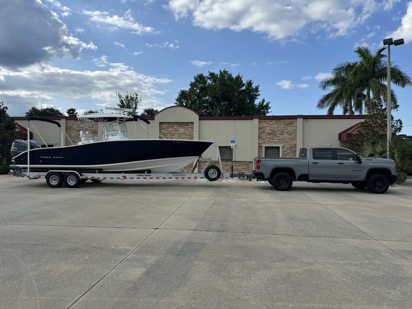

So we pull the boat for the first time with this truck yesterday. It pulls better than my 2016 DRW 3500 High Country! We retrieve boat and on the way home I get a message "Trailer not Recognized". I unplug and re connect. I then get a warning to check right and left turn signals. WE check them and they work perfectly except the truck flashes them very fast. I have electric over hydraulic brakes on a very low mileage 2022 Amerattail high end "C" channel type boat trailer. After a couple miles I get "Trailer Disconnected" warning and brakes no longer function. I pull this trailer with my other vehicles with zero issues. All lights work, just turn signals flash rapidly and truck thinks they are not connected! This is very dangerous! I got up this morning and pulled the boat to my shop to stick in the wash bay so it can be cleaned tomorrow and everything works perfectly! I have all sealed LED's on the trailer with dedicated home run wiring to each light. As I said, all lights work perfectly but truck does not like something after trailer is submerged! Has anyone ran into this?
