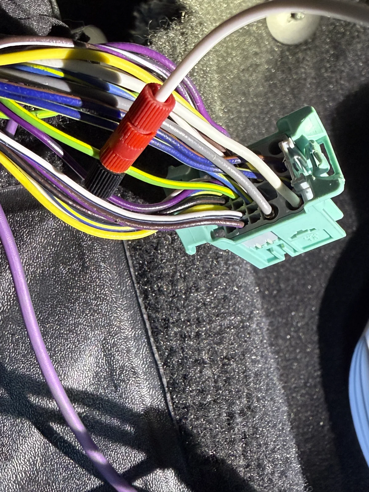

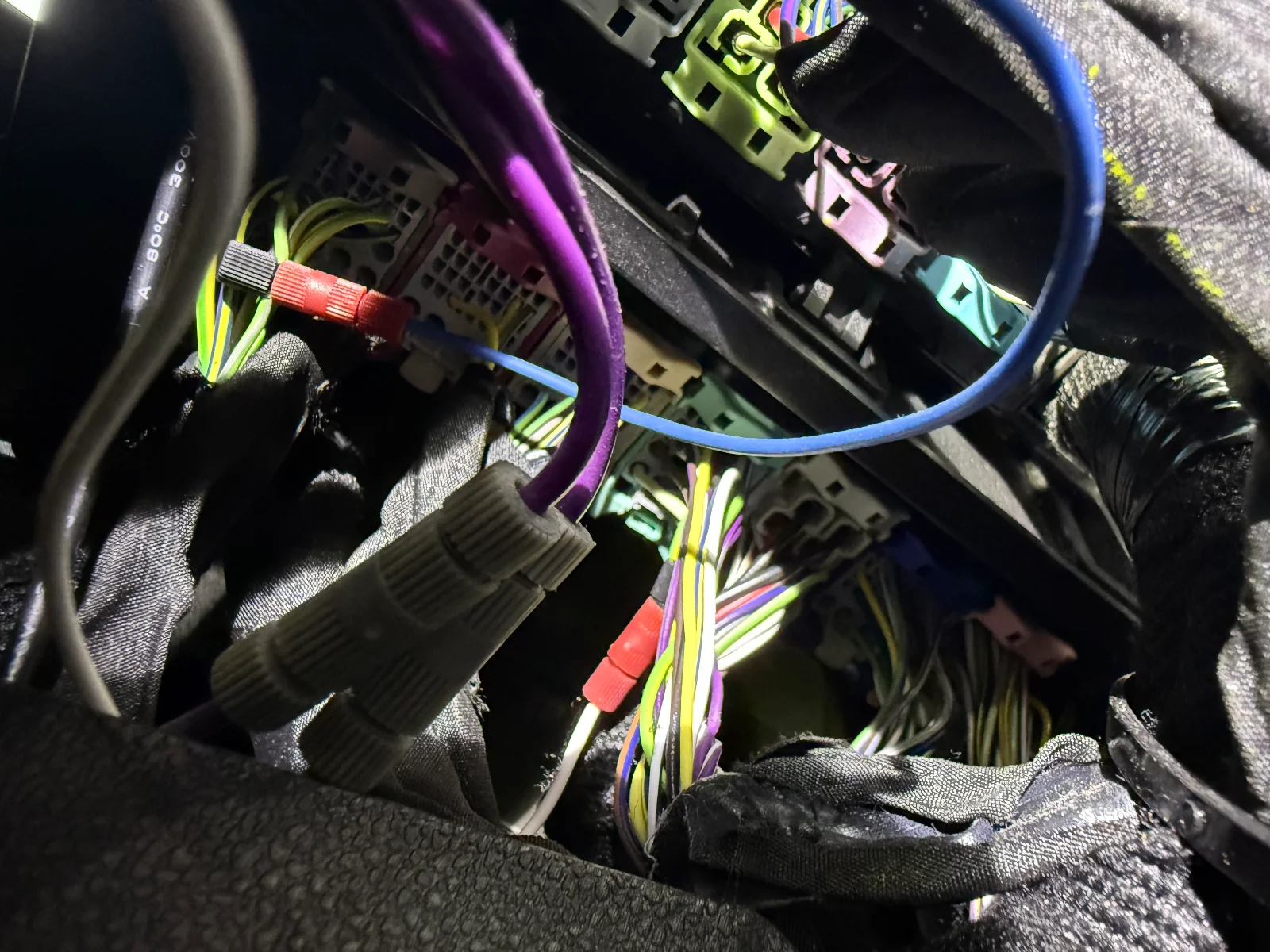

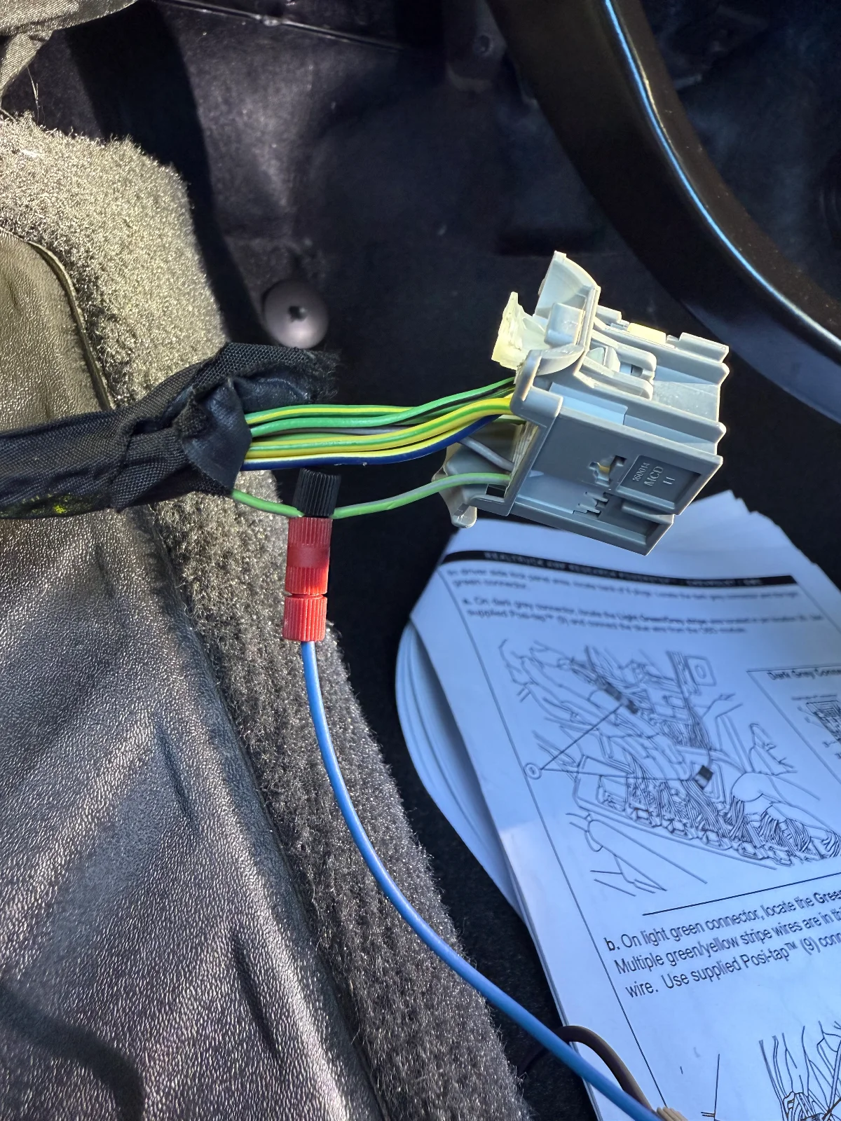

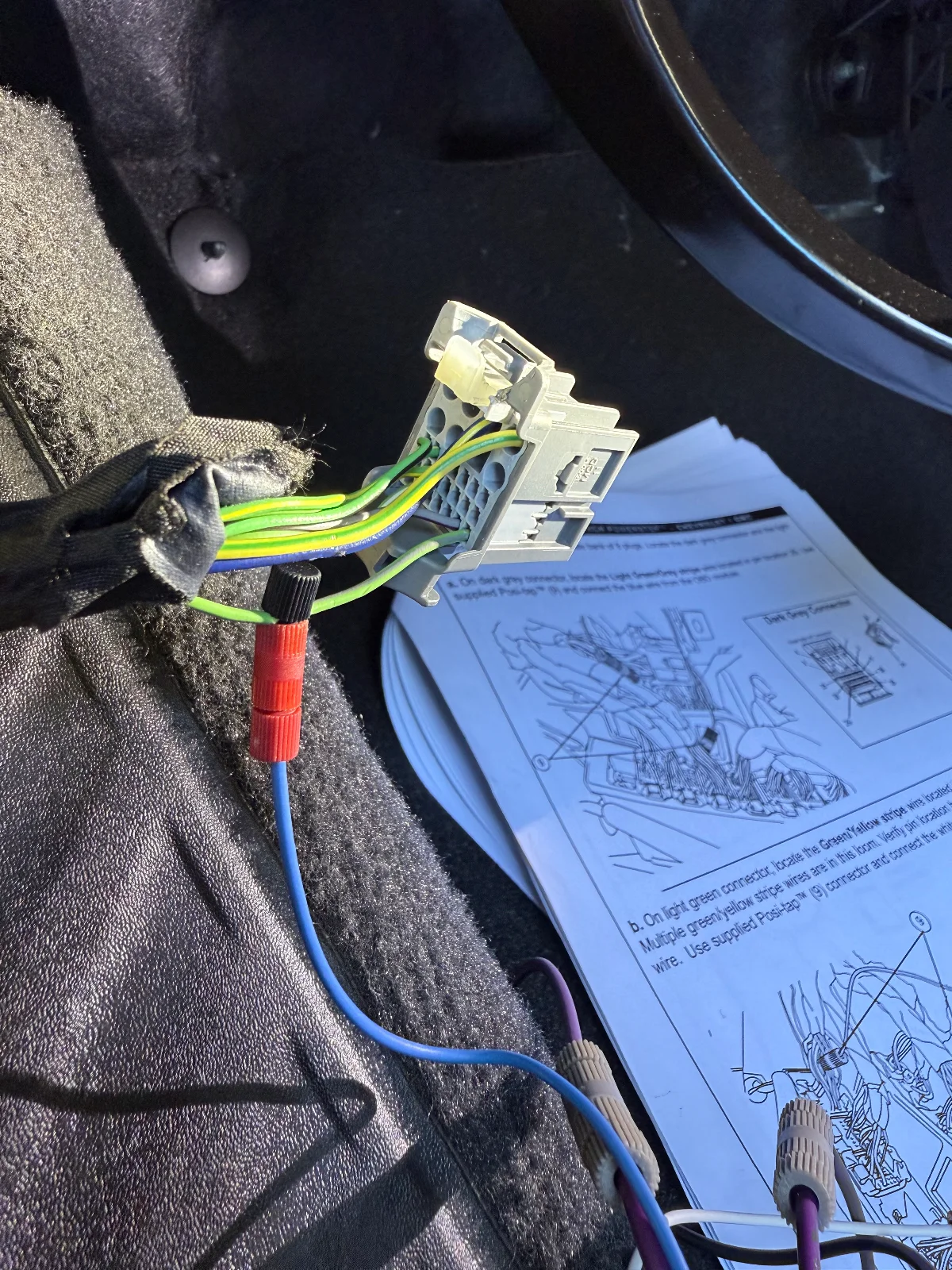

I've haven't had any issues with my amp steps since installed. Directions were horribly printed and color block description was wrong on the green block, mine it was more a coastal green. And block orientation printed on the paper was opposite when you looked under the dash. Gm used so many green/yellow wire in one plug it's confusing. I can't remember what PIN numbers were but it's the block closest to fender side and I gently cut and peeled tape to give more working room. Here are pics I took on install.

Yep, I did two of them and ran out of cuss words on both. "The light green wire with the yellow stripe"........... I broke out the magnifying glass at one point, fer crissakes!
