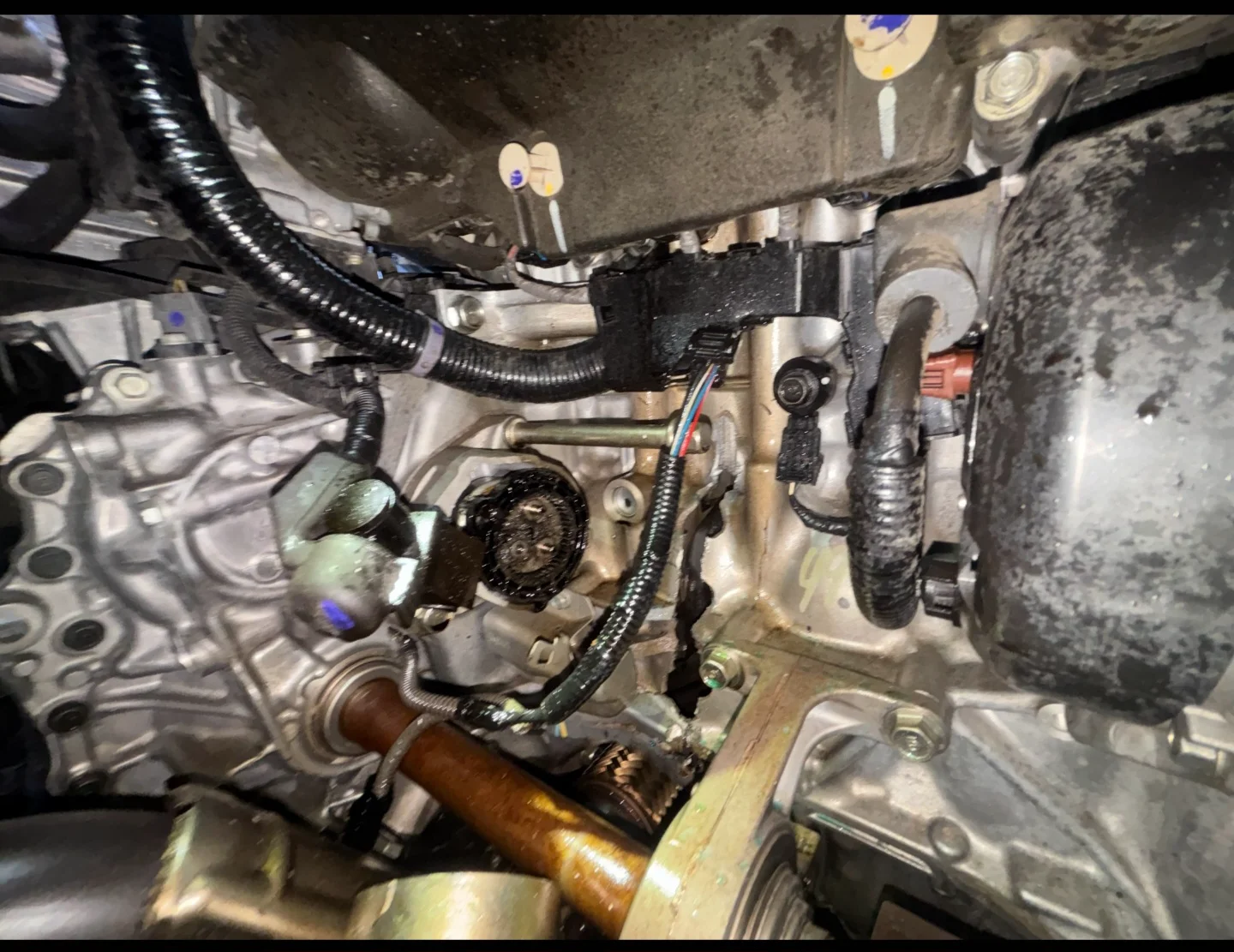

If it makes you feel better Hondas blow up too. My boy has a 2018 Civic with 62k that just grenaded and took out the whole block both sides of the flywheel.
It has several performance mods including intake, downtube, exhaust, and tuning. Wasn't pushing max HP, but probably 15-20% more than stock and I suppose he found the limits of a motor that wasn't built with harder bits.
Gonna be $5-6k for repairs with a used motor of similar miles.
