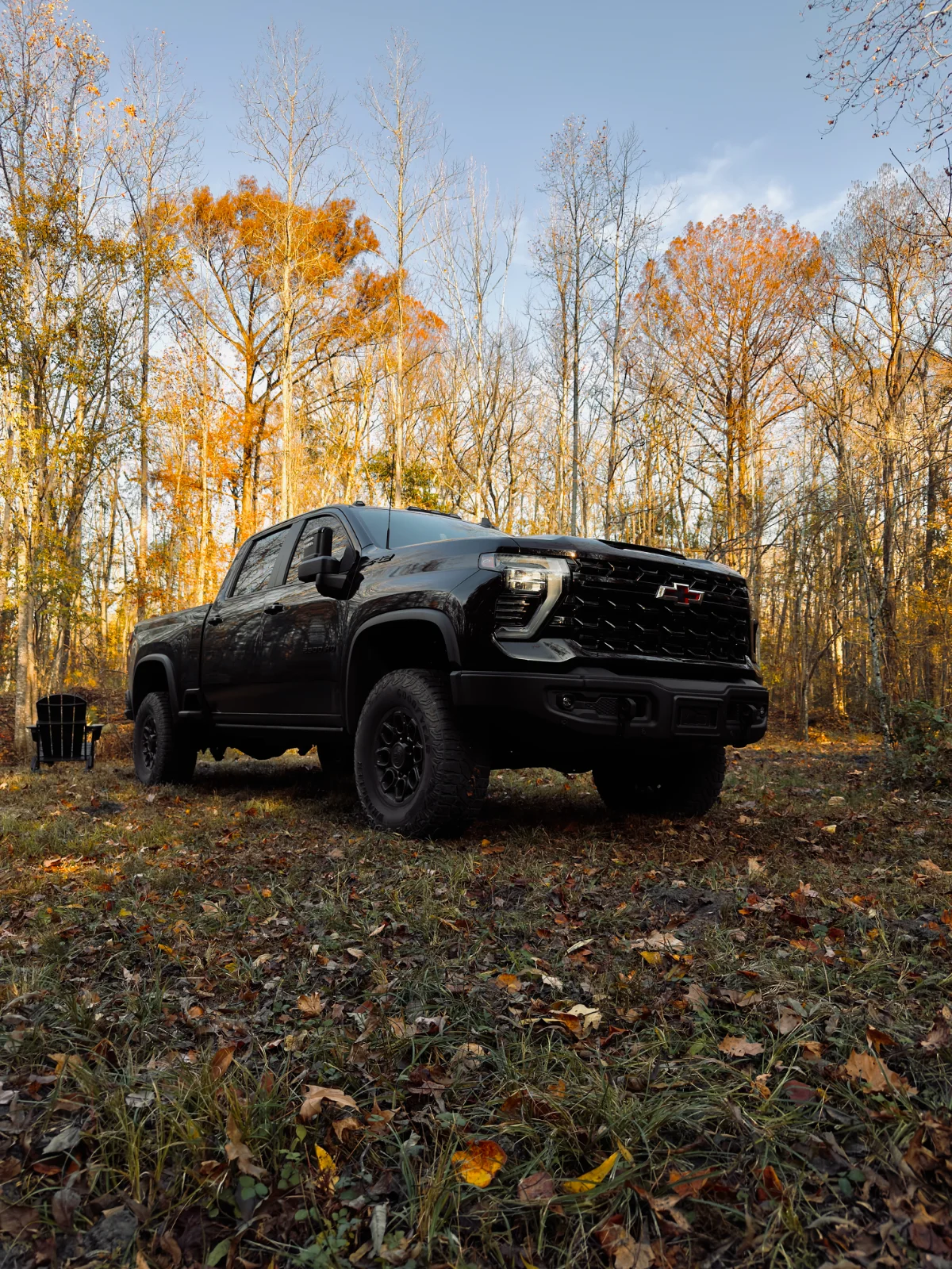

I have a 2025 2500 ZR2 Bison and I’m Tossing back-and-forth on what I’m going to be doing to my truck in the next few months..
I know I’m going to get a new set of wheels with a 0 offset (5” backspacing) and run 37x13.50s but I was curious if anyone had any luck with this set up on stock suspension and had some examples? I feel like I’ll get a ton of rubbing with that zero offset wheel, but I’ve seen a lot of people have luck with the stock AEV wheels and no rubbing. I have my keys cranked once as well, don’t mind cranking them more if I need to.
I just prefer a little bit wider offset on my trucks and want to go a little more aggressive on the stance.
I’ll probably end up getting The mcgaughys 4" lift eventually but would love to run it without it if I could help it.
If anyone has some examples or could point me in the right direction just let me know. I’ve looked everywhere on Instagram, Facebook, and even this forum and I can’t really find any examples of a 0 offset wheel on a stock ZR2 bison running 37x13.50s
Here’s a pic of my truck right now. Love this beast.

I've got a thread posted with 37'x13.5 Toyo MTs mounted on +33 Bison wheels. They didn't rub on the UCAs sitting in the driveway, but I suspect they might under load and offroad, especially if you air down.
0 or +10 or 12ish would eliminate that issue and I think you still have enough clearance in wheel well. AEV sells a clearance kit for 37s and you can raise it about 3/4 inch and not affect ride quality.
