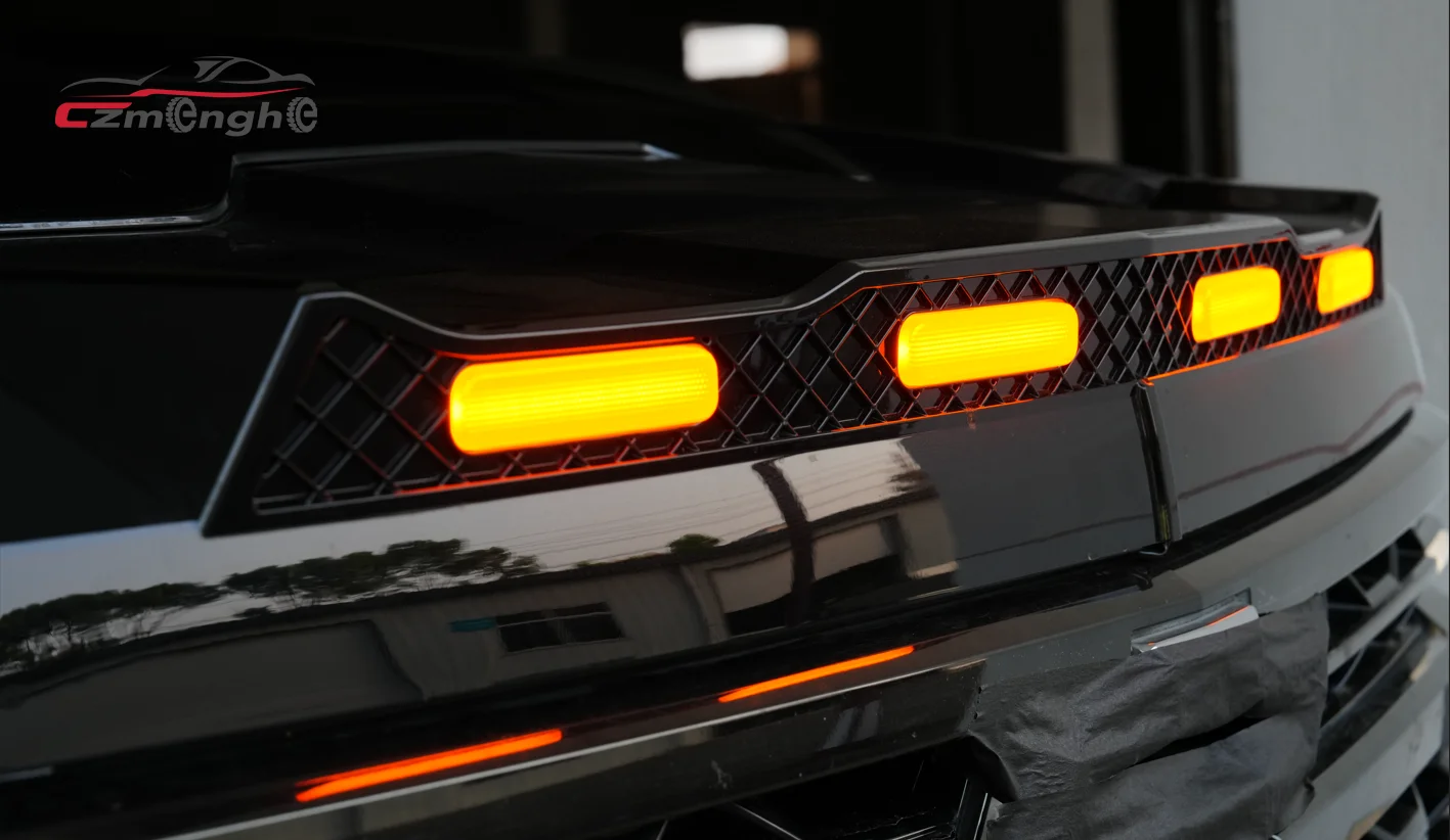

Check out the final result:

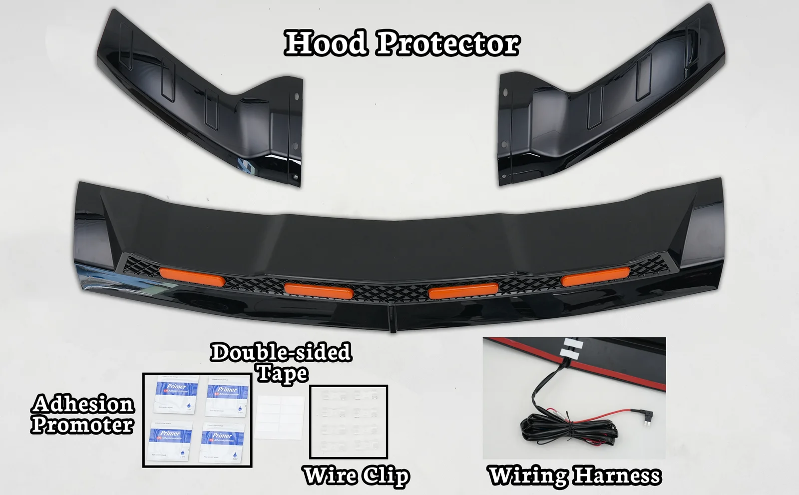

- Without removing the adhesive liner, position each Hood Protector on the hood. Compare its alignment and fit to the vehicle's contours.
- If you'd prefer to test the electrical connection before the full installation, you can jump straight to Step 4 and come back to the beginning later.
Step 1: Unpack and Prepare
- Open the box and neatly arrange all components.

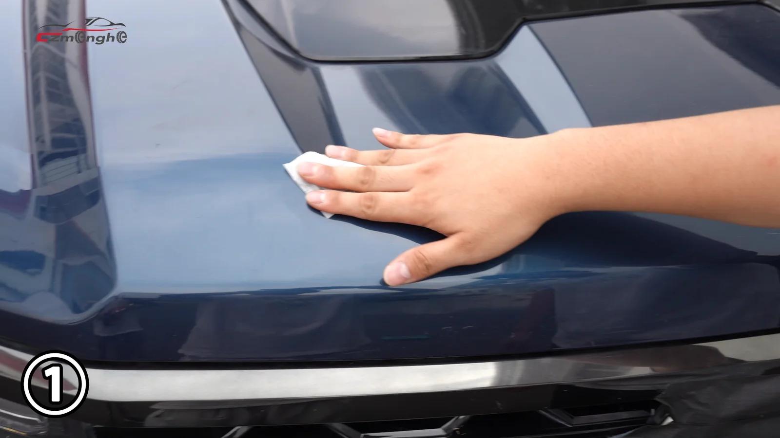

Step 2: Prepare the Surface
- Clean the installation area on the hood, and apply the adhesion promoter (Fig. 1).

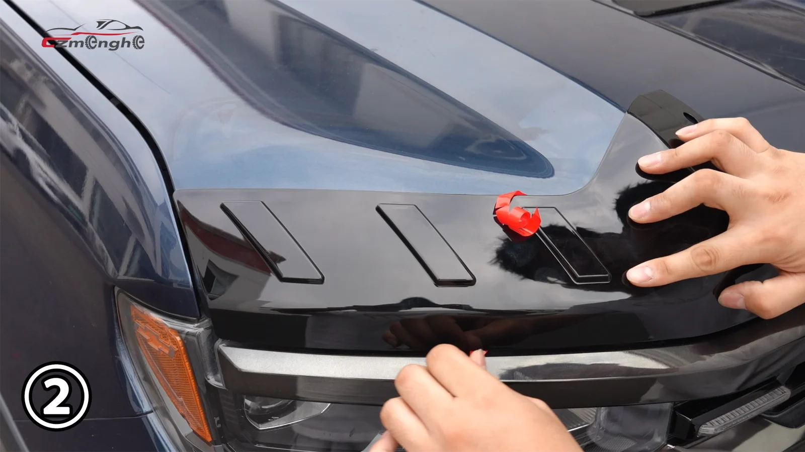

Step 3: Install the Hood Protectors
- Press each Hood Protector into place while peeling away the tape's protective liner (Fig. 2).

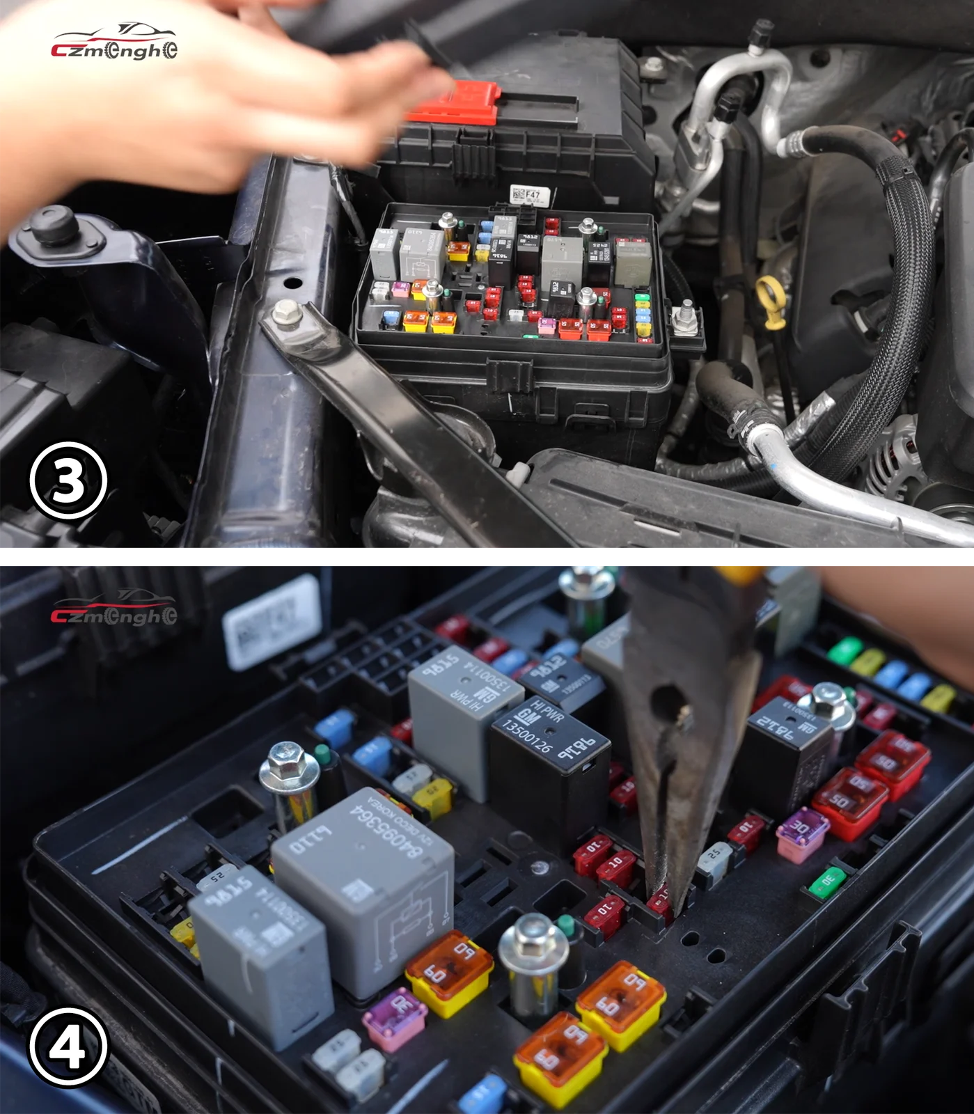

Step 4: Disconnect Connector
- Open the front hood.
- Open the black electrical box cover as shown in the picture (Fig. 3).
- Unplug the red connector with number "10" (Fig. 4).

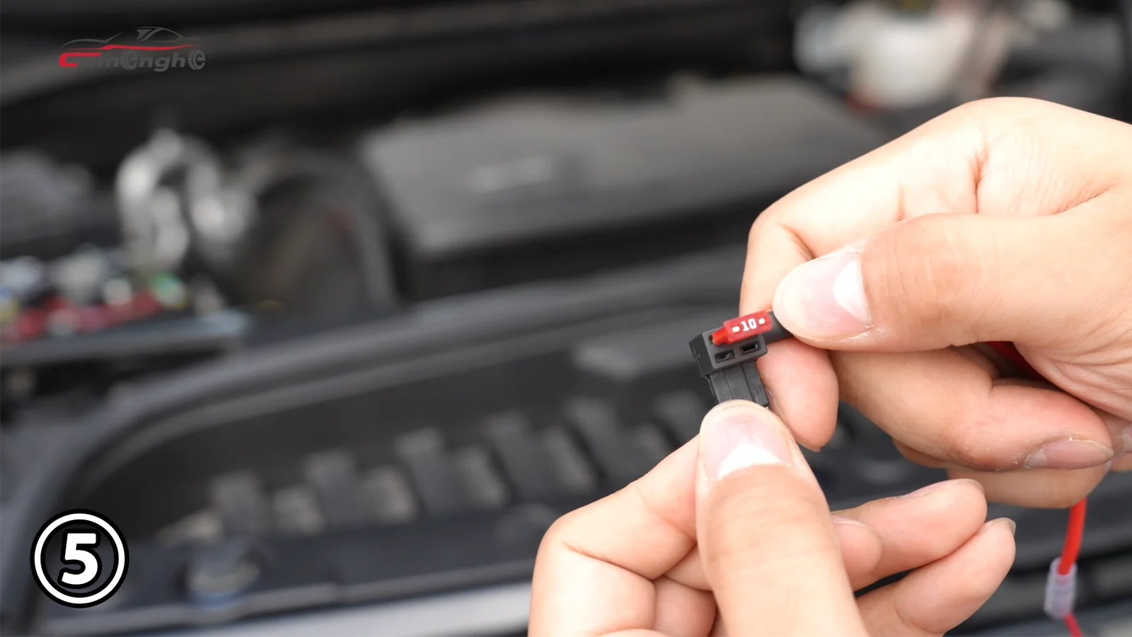

Step 5: Connect Wiring Harness

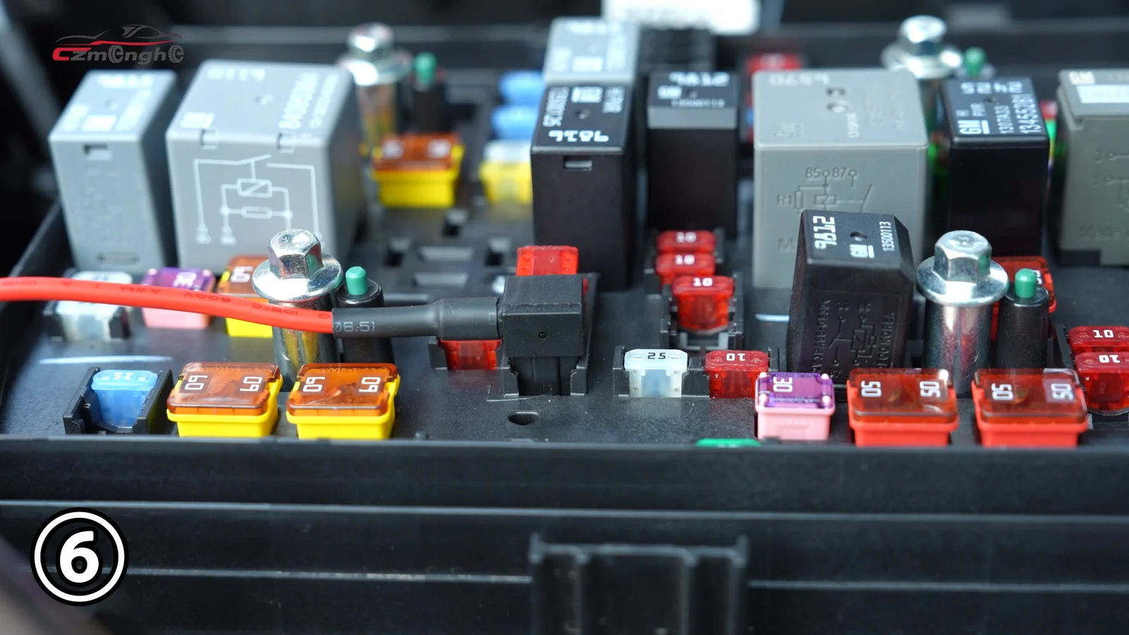

- Insert the vehicle's red connector (unplugged in Step 4) into the matching port on the Hood Protector's red wiring harness (Fig. 5).
- Plug the red wiring harness into the original vehicle’s socket (Fig. 6).

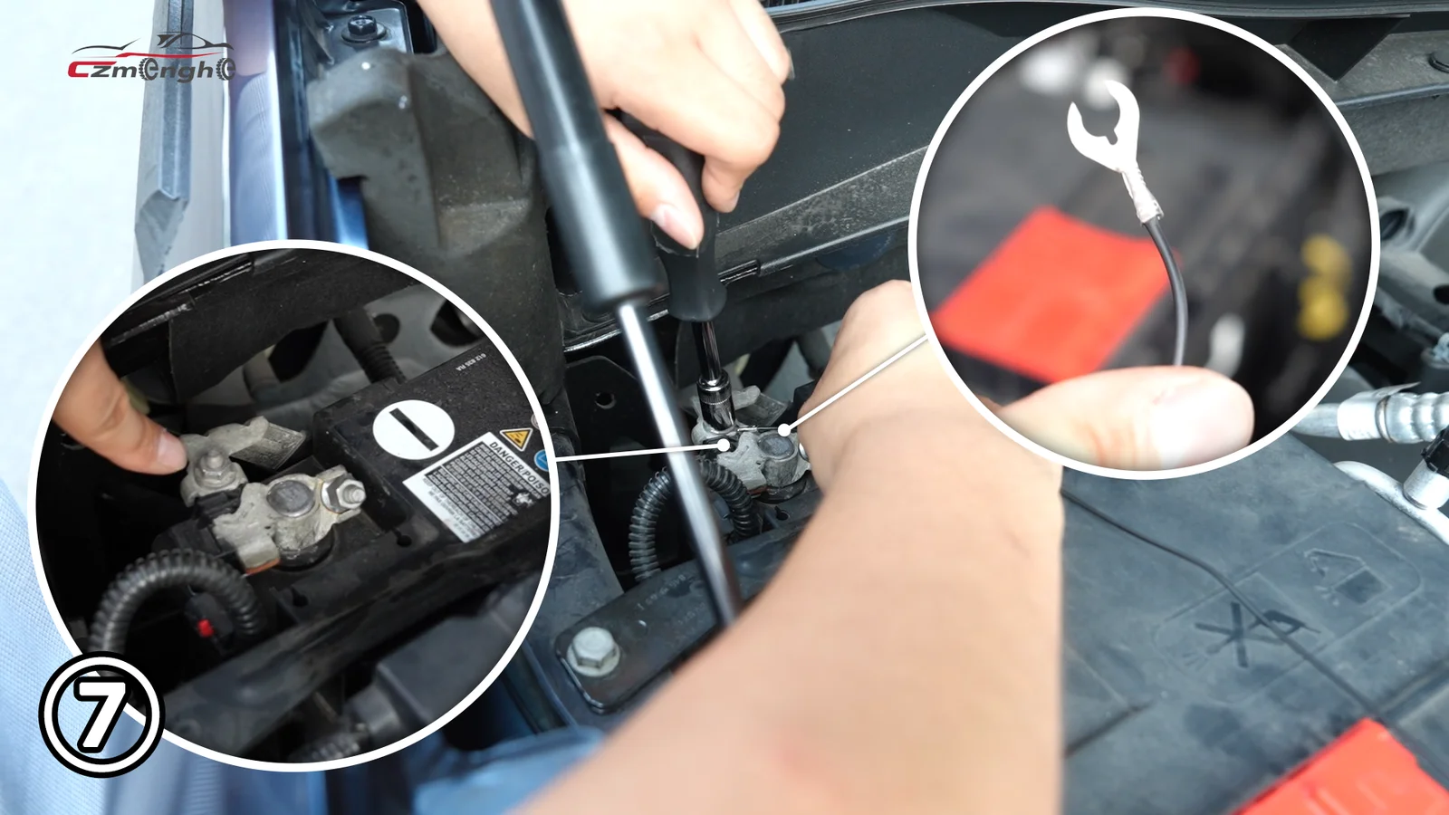

- Use the clip on the black harness to secure it to the vehicle’s screw and tighten (Fig. 7).
- Close the black cover securely.

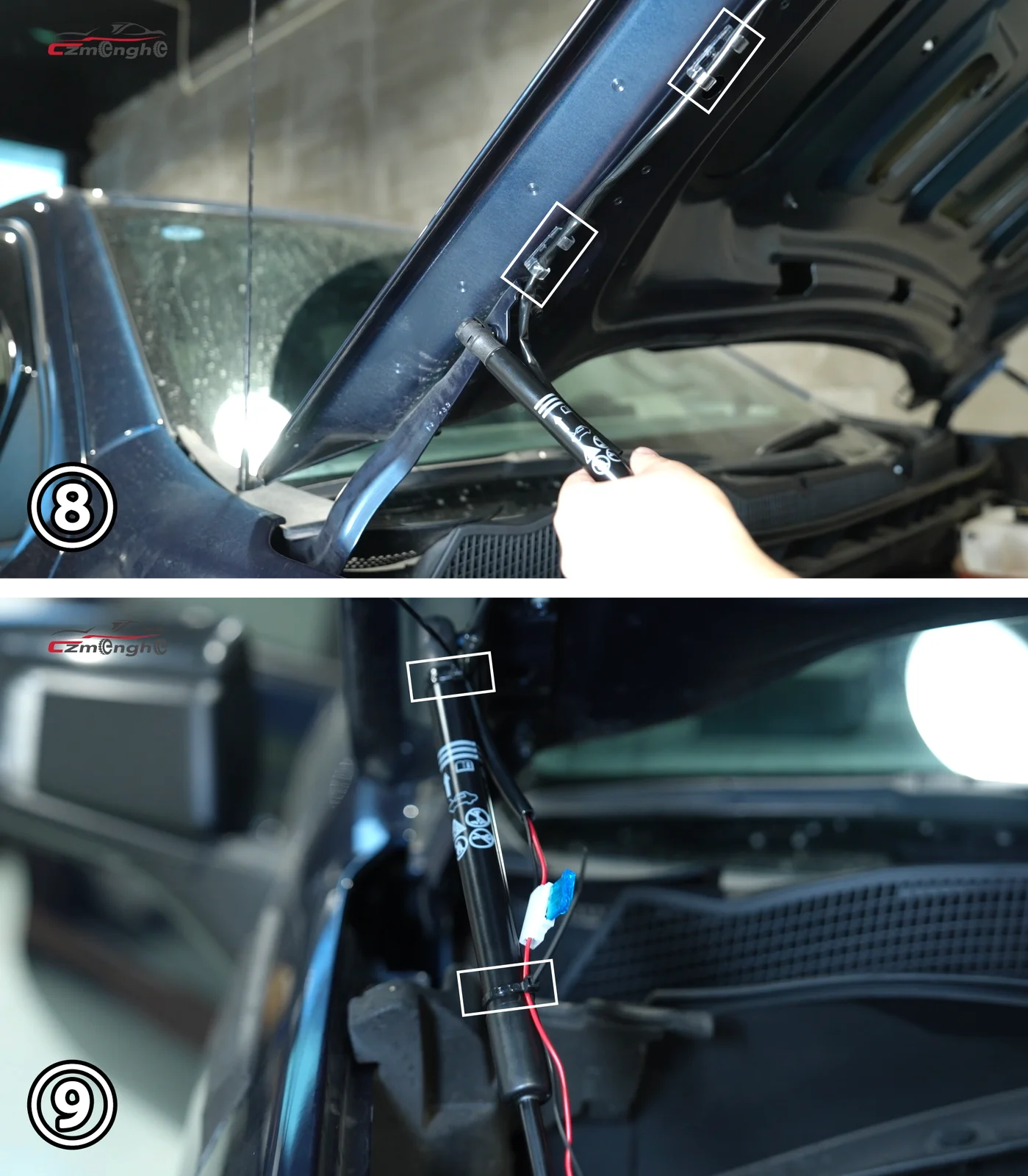

Step 6: Route and Secure
- Attach the double-sided tape to the back of the transparent wire clips.
- Remove the backing from the tape, and attach clips in position.
- Secure the wire harness into the clips (Fig. 8).
- Use zip ties to secure the wiring harness to the lifting pole (Fig. 9).
- Trim off excess zip tie ends.
