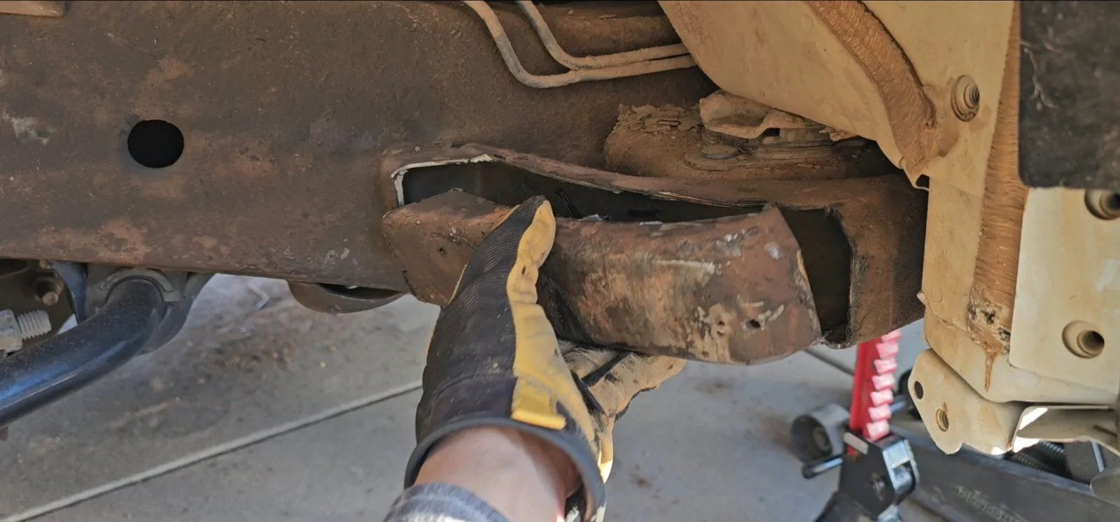

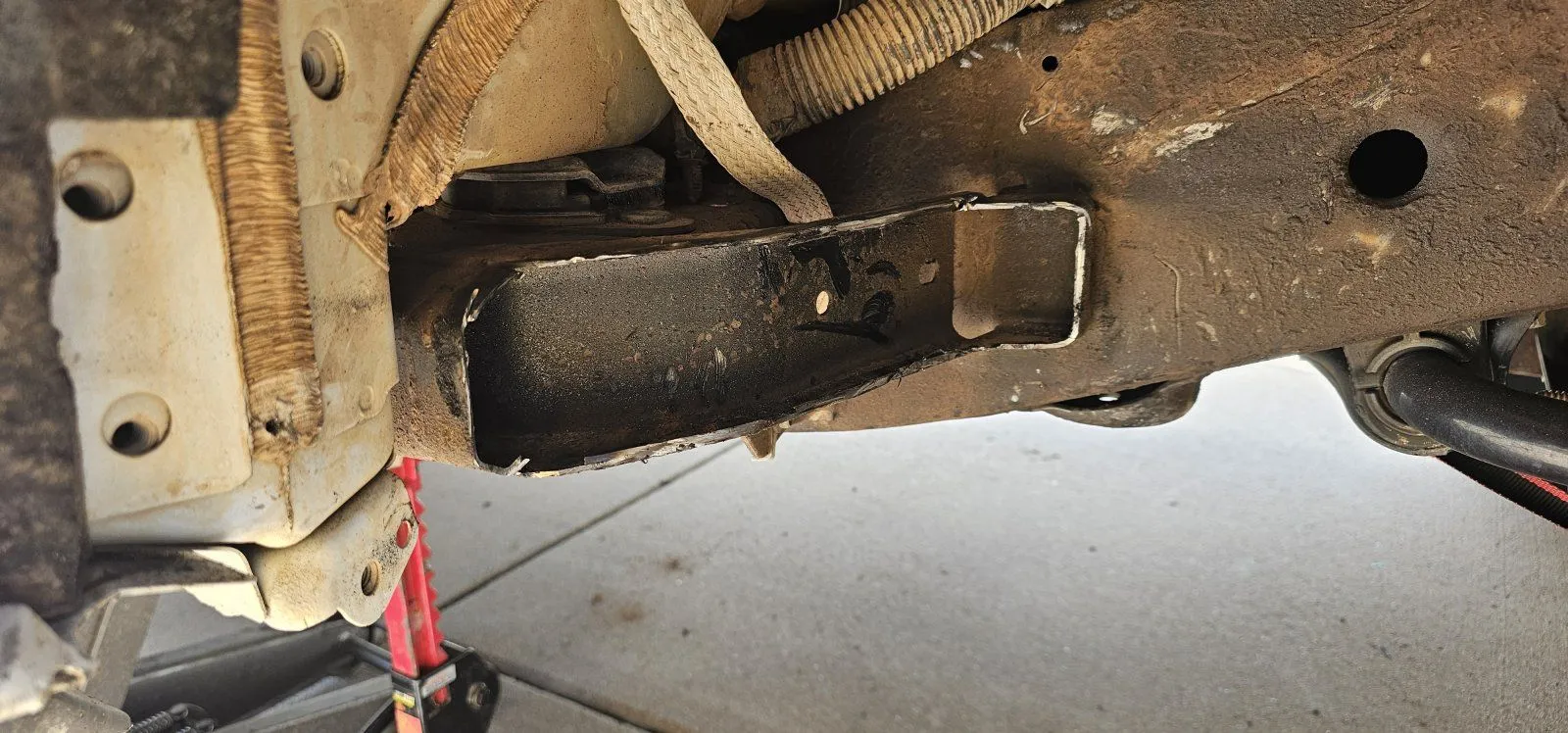

315/70/R17 BF Goodrich K02
17x8.5 -12 Offset Relations Race Wheels RS2-H Monoforged wheels
Front suspension is a mix of Peak top spacer and Rough Country preload spacer and bottom strut spacer.
Extensive trimming performed. Front bumper notched at the front wheel well, fender liner trimmed front and back, cab mount chop.

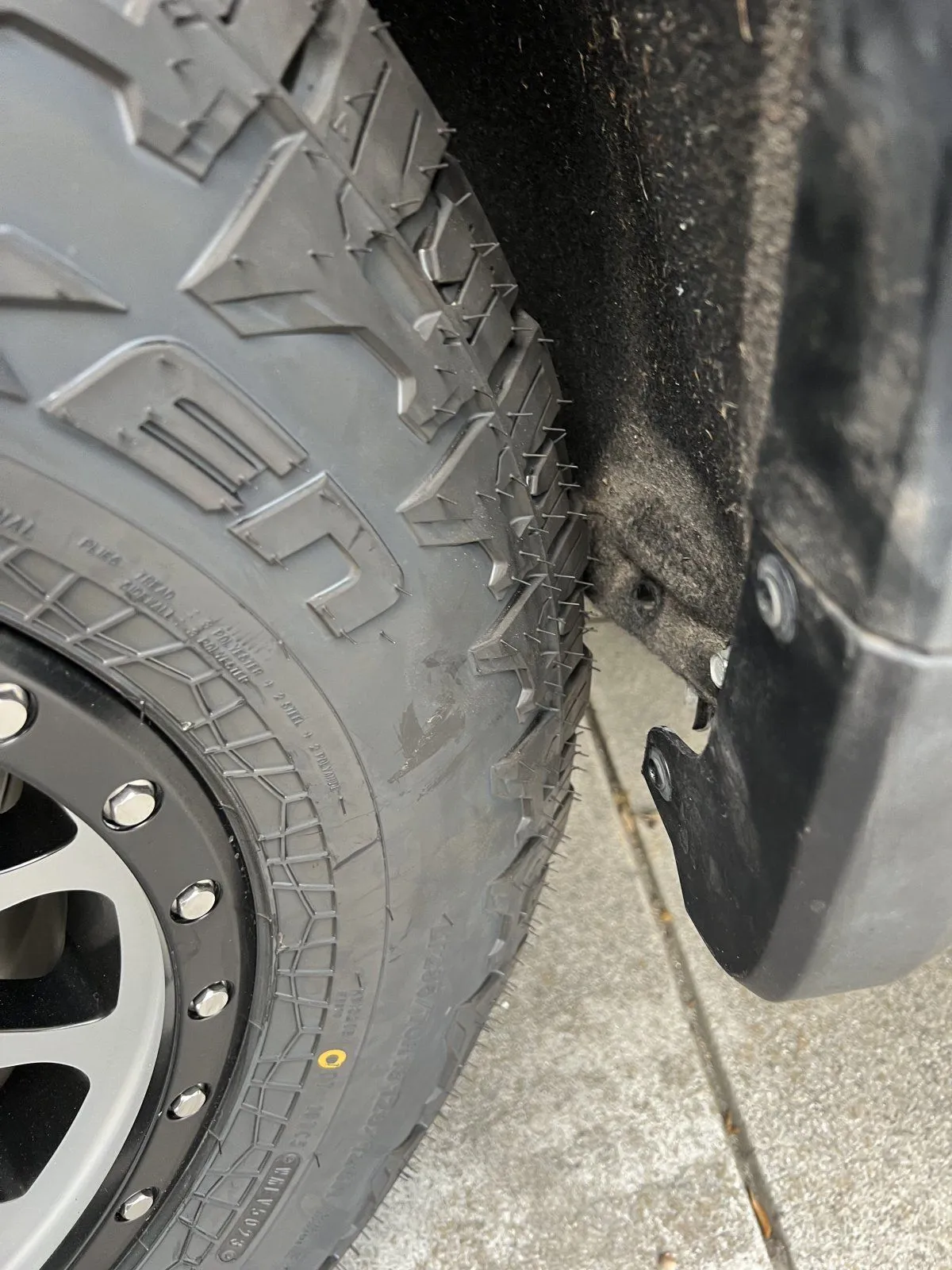

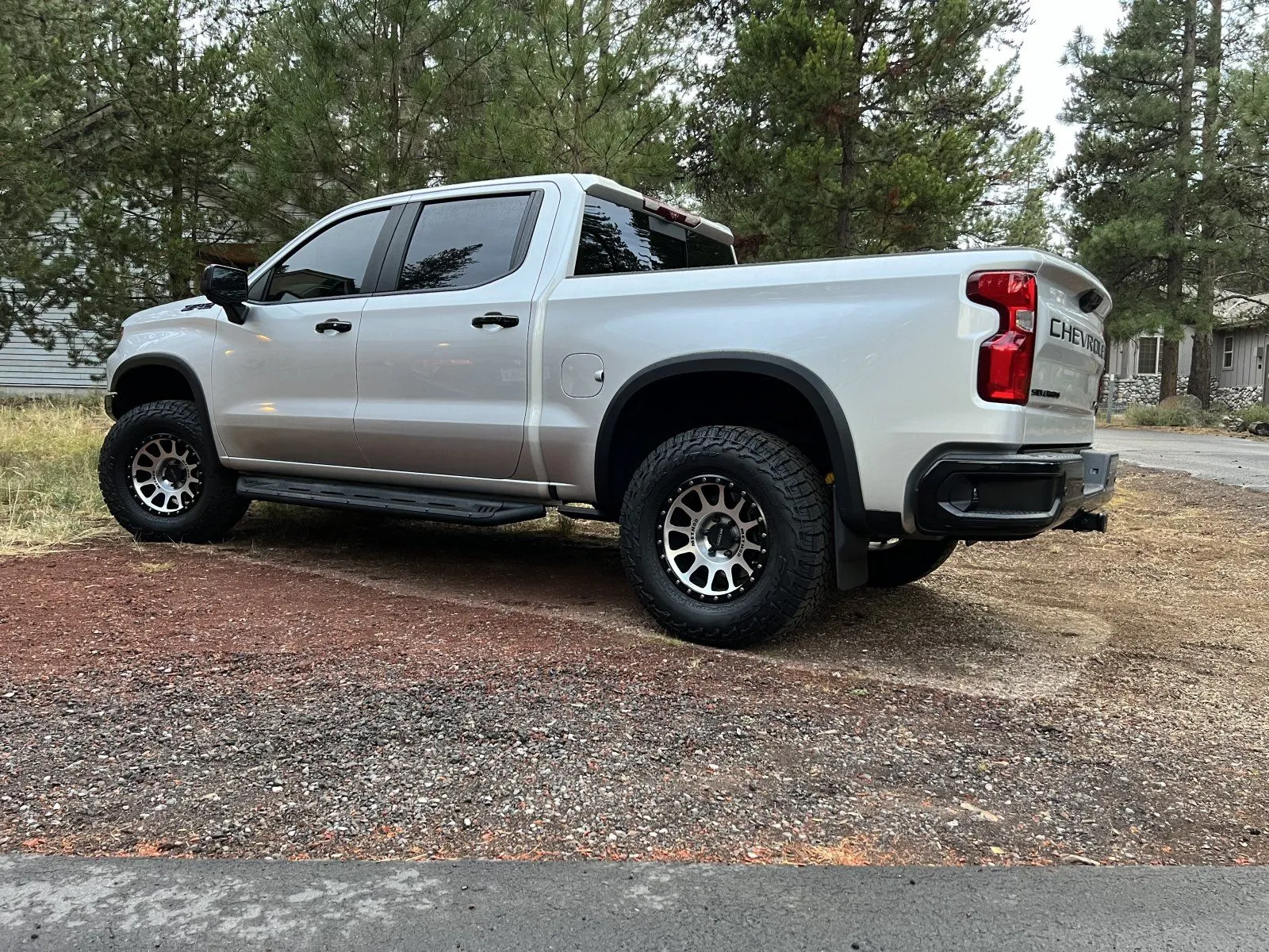

295/70 R18 Toyo Trail RT Tires (Load Range) E (34.5 inches tall installed)
Method NV 305 Wheels (18x9, -12 offset)
Stock Suspension
Bumper trim, rear wheel well plastic and liner trimmed
No rubbing under normal use, but tires are still 1/4 " from bumper and rear wheel well. Extreme off road use may rub some with wheel cranked.

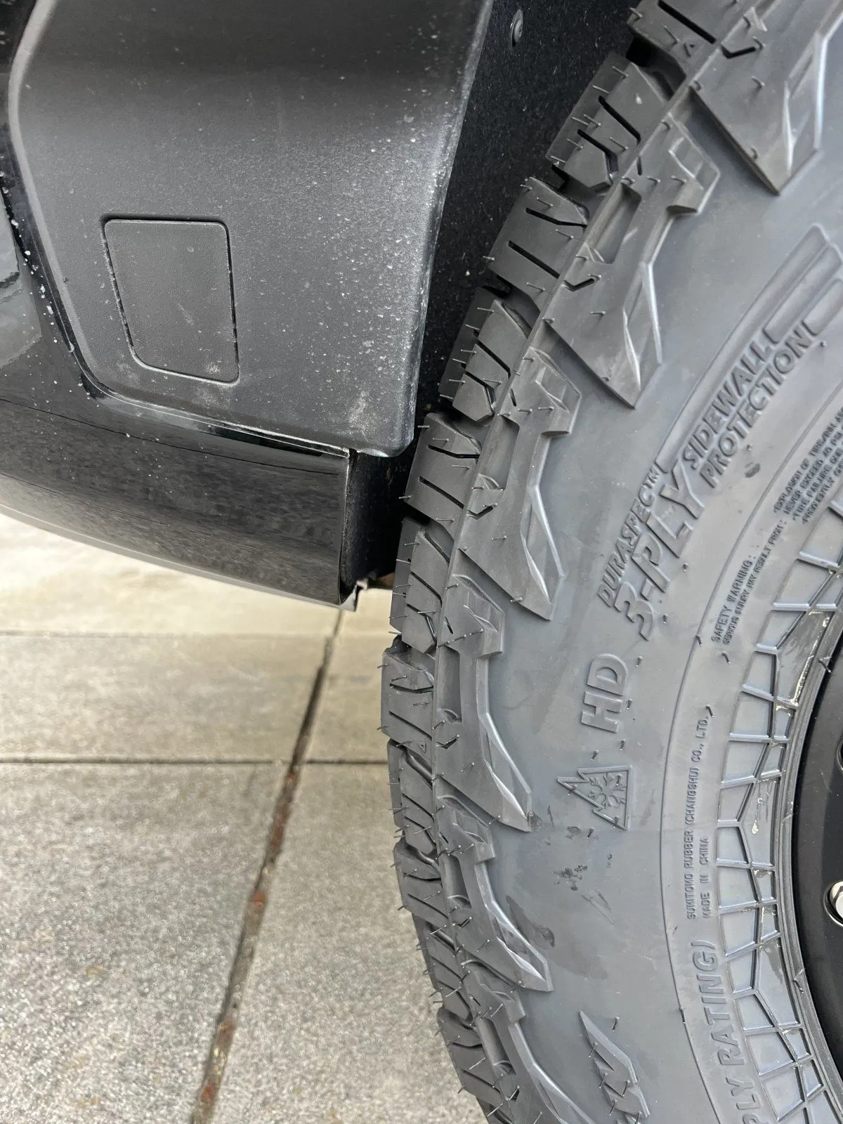

- 285/75R17 E Falken Wildpeak AT4W (34.1x11.6” according to Falken website)
- 17x9” -12mm Fuel Shok rims
-stock suspension
- slight trimming of the front bumper and removal of plastic trim behind front tire.
- no rubbing anywhere. Very mild poke.

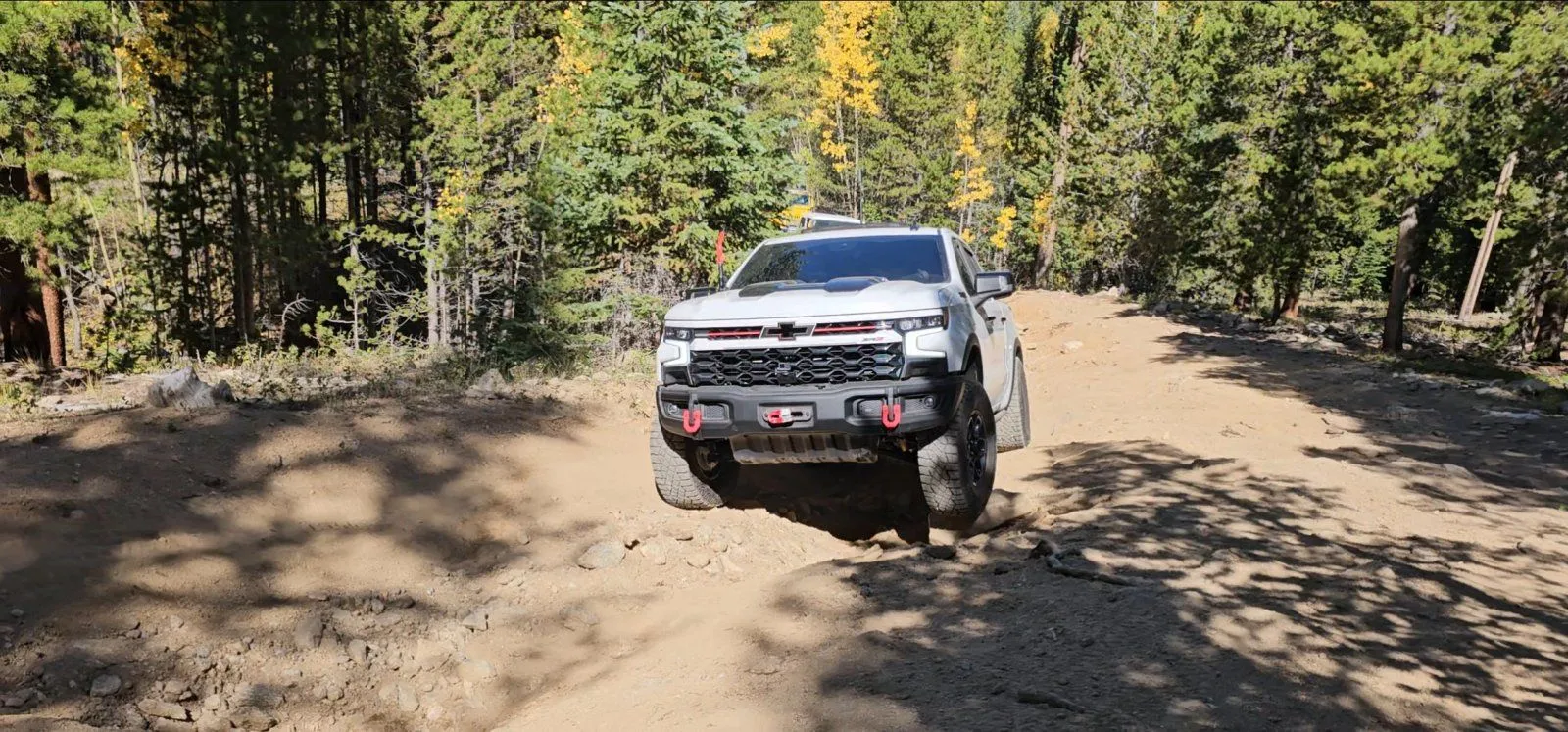

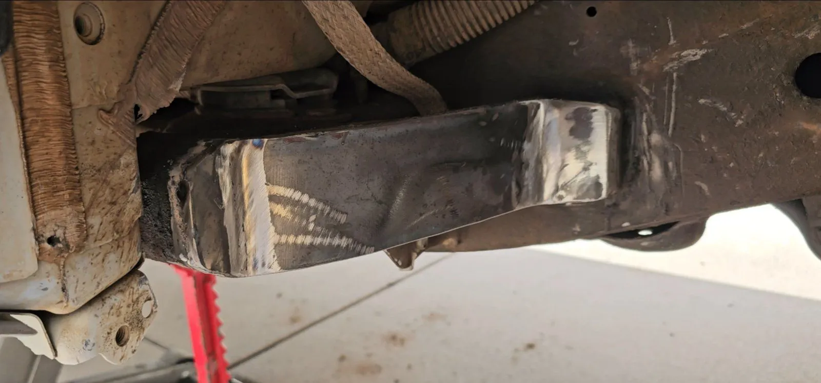

ZR2 BIZON EDITION
Tire size (305/70/18)
Wheel (stock wheels with 2" spacers)
Stock Suspension
Any trimming performed (performed the crash bar mod front part non-modified)
Please note any Tire-Body contact observations. (Went off-roading today and I was fully articulated, zero contact from tire)

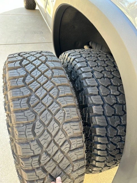

I've been running the Cooper Strongholds in 295/70r17 for the past couple of weeks and even when I swapped them out I felt like they were slightly undersized in overall diameter compared to my stock tires. It sucks that there is no consistency when it comes to size vs different brand of tires but seems like the coopers run a little on the small size for this given size at least. Maybe the stock 275/70r18s are on the large side of the spectrum too, who knows.
So I used their "45-Day Satisfaction Guarantee" and will be switching over to the same tire in 285/75r17. I'll get some more data as soon as the new size is installed to give you guys some specs on the 295/70r17 vs 285/75r17 vs stock.
The new tires are on Method 703s in 17x8.5, same width as the stocks are.

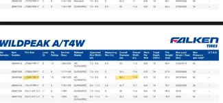

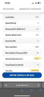

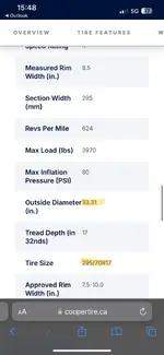

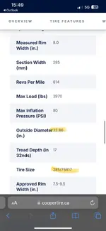

For informational purposes...
It’s very unfortunate how inconsistent tire sizing is. I have the Falken Wildpeak AT4Ws in a 285/75R17 and they show their overall height to be 34.1” compared to the Coopers which are 33.86” in the same size tire. Also seems like even their overall diameters are inconsistent with how they actually measure up in the field.
I attached some screenshots of the stock Goodyears vs Coopers vs Falkens.
