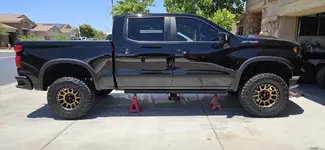

I added a 2 inch lift today! It's about 43.5 inches to top of fender well in front and 44 inches in the rear. That's with 295/70 R18 Toyo RT Trails that are about 34.5 inches tall.
Looks pretty good!
Lift is from a well known company called Jack Stand.....LOL!

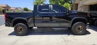

I was just doing a little experimenting with ride heights. Then got busy with photo editing.
As I suspected about 2.5 inches in front and 2 inches in back looks pretty good and the proportions of the truck look better IMO. Also sitting in it allows for better visibility, which is the thing I miss the most for my Duramax.
Lifts are mostly non functional if you can't run larger tires, so I feel like with 34 to 35 inch tires, going to a taller lift doesn't do much other than add void space between tires and fender well.
I wish a lift company would offer a 2 or 2.5 inch lift for the truck, but it would be a small market, so they might not be interested.
