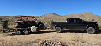

I went quail hunting this morning, so this was my first tow. Nothing too exciting as my trailer and SXS is only about 4500 lbs.
When I hooked it up, it maybe had just a little bit of squat, but trailer had a little weight forward on the pin the way I have the sxs loaded.
This truck really tows nice. The 10 speed transmission is smooth as butter and always seems to be in the sweet spot. There's a couple step grades and I never really noticed the shifts. Maybe seen a couple hundred +rpms at most.
The suspension seems to work even better when some weight is added. It rides really nice, especially on some choppy pavement at 70 mph and some rough desert roads with washboard and rocks. Never did that stretch of road with such ease. That alone may be worth the price of admission. It rides nice without a load, but better with a load.
Probably the only thing I didn't like was the adaptive cruise going back down the grades was very aggressive when encountering slower traffic. The brakes and exhaust brake would kick in and it would scrub off about 12+mph abruptly. Then speed up quickly. Some of that might have been due to all the shitty drivers in front of me stabbing their brakes and switching lanes.
My trailer wire kept showing a disconnect/reconnect message in DIC. It seemed solid at plug. May have to check pins and wiring. Never had that with this trailer before, but could be the wiring on trailer as it's getting older.
Overall, very happy with performance when towing!

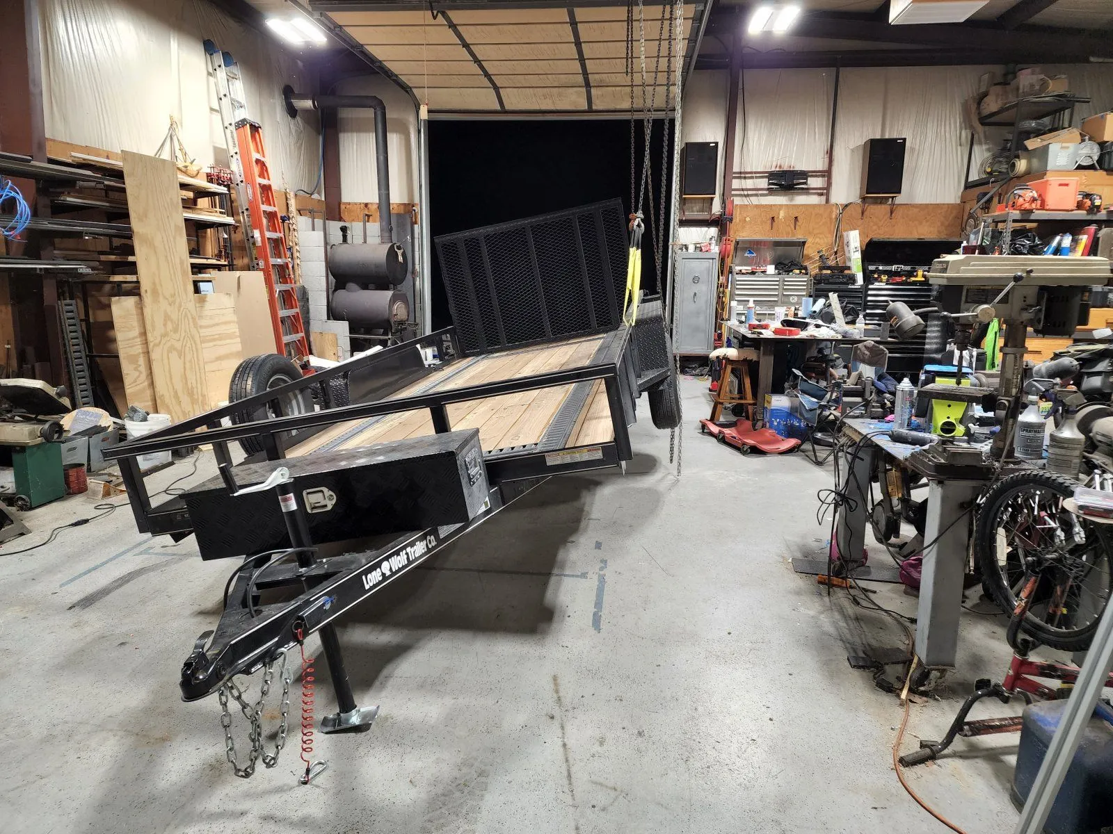

What ever you do, try a different trailer before you assume it's the trailer. New truck and that trailer had just had some work done, so I assumed it actually was the trailer wiring. I hoisted it up and rewired the whole trailer lol. Only to figure out the truck was the problem. 😅 plus side is every connection on that trailer is solid and water tight now.

LOL...... I'm already planning to replace all my lights with LEDs and also the break away wiring. Also thinking of repainting with rattle can. I redid the brakes and hubs last year, cause one of them got hot. Redid the decking about 5 years ago.

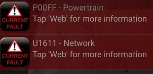

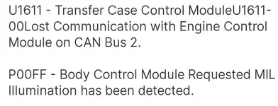

Checked codes and had a couple that I think are unrelated. May be transfer case related.

Dropped it off at the dealer. Their code scanner showed many U codes, which are communication codes. Besides trailer connect/disconnect, truck seems to work just fine and no CELs.
I'm starting to think the OBD plug for the AMP steps might be throwing these codes. Install was exact same as 1500, but I got a CEL immediately after install when I reconnected the battery. Cleared it and it hasn't been back.
