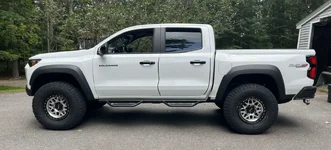

Put new tires on my 2024 Chevy Colorado ZR2 Bison. Falken Wildpeak A/T4W 315/70R17. They are taller, fatter and have wider tread width the stock GY Territory MT. Dave you were correct, I don't really notice the extra weight of the tires when accelerating or braking and they ride very smoothly. Wheels are KMC GRS 17x9 -12 with 6 mm spacer/adapter 78.1 mm to 106 mm center bore.
