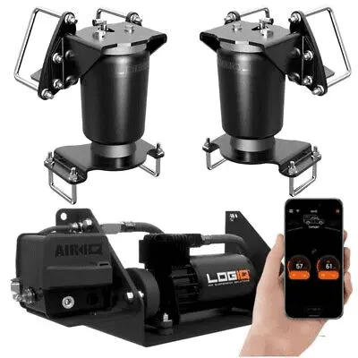

I have the system below and it was installed by my dealership which makes it covered under my warranty.
View attachment 15991View attachment 15993View attachment 15994
I haven't seen that kit before. Looking on their website, that seems like a nice setup that's not supposed to limit travel. I like the way it installs on the side of the frame and it leaves the stock bumpstops in place. What do think about it so far? Truck still ride the same unloaded? Have you done any towing since you had them put on? I think this setup is what I'm going to go with.

I tow just about daily and i tow pretty heavy. I leave 5 lbs in them when not towing and it does not affect the ride at all. I absolutely love these things plus they where dealer installed so they are covered on my warranty. I previously had a 2011 2500 HD LTZ Z71 which i did not need air bags but rode like a tank this truck has an amazing ride and with the air bags towing is an entirely new level of comfort. It's like having the best of both worlds a 1500 ride quality with a 2500 tow capability.

Nice, I actually had a 2011 Duramax also, haha. I did have to have bags on it though. I believe I had firestones on it. Normally I run cradles so I can leave the bags at zero psi when I'm not towing. That way the bags don't limit up travel. I'm guessing these recommend leaving them at 5 psi also, especially if putting the truck up in the air? Good to know you don't notice them with 5psi in them.
I'll put them on myself, not to worried about the dealer covering them under warranty. I already have onboard air, so I won't need the remote controlled compressor. I actually still have my mechanical control valve and gauge I took out of my previous ZR2 before I traded it. I had planned on putting it in the HD, but I just haven't decided on bags yet. Truck has did fine with most stuff. But my toyhauler has over 1500lb of tongue weight. With WD hitch it's fine. But with out the bars on, it squats it a bunch. I've been missing my bags when towing. No way to adjust the ride quality while on the road sucks.
