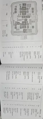

I just looked at the manual. Check fuse 57 in the fuse panel under the hood. That is the one for the Side Blind Zone Alert.
