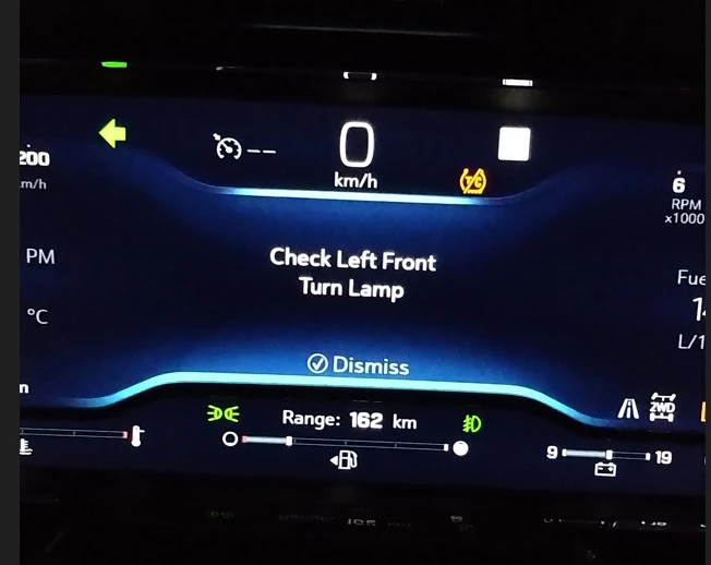

Anyone else have this intermittent
issue with their turn Signals and i wonder if its one of those things that if its not doing it when at dealer then there is no way to know what there is to fix, thanks in advance, it first did it with the boat trailer hooked up last yr and though nothing of it just figured had something to do with a light on the trailer but everything worked, then started this yesterday without the trailer hooked, once shut off problem disappears till when ever it wants to pop up again...

Anyone else have this intermittentView attachment 11025 issue with their turn Signals and i wonder if its one of those things that if its not doing it when at dealer then there is no way to know what there is to fix, thanks in advance, it first did it with the boat trailer hooked up last yr and though nothing of it just figured had something to do with a light on the trailer but everything worked, then started this yesterday without the trailer hooked, once shut off problem disappears till when ever it wants to pop up again...

Not the best pic but there was a newer model F1fiddy behind me this weekend with what appears the same light malfunction. It's not just us
Mine did it again today. I didn't do anything, no water or messing with anything else.
Like in the pic above the daytime running light also doesn't turn on.
