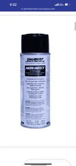

Have seen countless threads saying I need to use Daubert Nox-Rust on my frame from time to time. On their website there is a thousand different models of Nox-Rust. The one I came across is X121-B Aerosol. Added a pic for a better look. Anyone know if this is the correct coating to match factory? Or if they use a different model of the Nox-Rust? I’m going to try and call tomorrow to confirm with them. If I got ahold of the dealership would they by chance have an exact # on the stuff they use? Thanks

Yes. Based on my research a number of years ago, GM applies the following on the frame from the factory.
Nox-Rust® X-121B​
I’ve had great luck with it on older GM trucks fully reapplying (early 2000’s) and touch up on new trucks. Many options out there for rust prevention…I use Fluid Film in door cavities and various other areas but it will pull the factory applied frame wax off.

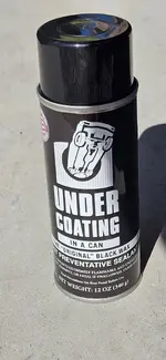

This is what I used from ebay. Went on nice and smooth dried evenly. It's still soft, but isn't as gummy and messy as the stock wax.
