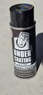

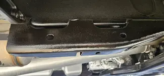

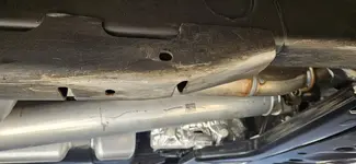

On my way home from the dealer with new rig I decided to do some off road travel. Went up and over some uneven terrain. Managed to hit part of my skid plate and rub this frame support, which took off a lot of the frame wax.
I wanted to get something back on the frame for protection, but also so it didn't look like a mess.
There are a lot of products that can be used for rust prevention and corrosion, but not many are compatible with the existing GM frame wax. Many want you to strip the existing off.
I ended up finding this Undercoating in a Can spray on wax product through some research. You can buy one or more cans on ebay.
It works really well and matches the existing wax coating as well. Easy to spray, just be careful for overspray. Dried a nice matte black finish.
Not sure how long it will last, but seems durable when scraping your fingernail along the surface.

Yeah the GM service bulletin for it sounds like a CF. It's a two part process and a bunch of prep. This took me 3 minutes.
I've also seen guys say you can heat up some black cannuba wax, mineral spirits, and diesel then spray it on with a water bottle. That sounds like too much work.
