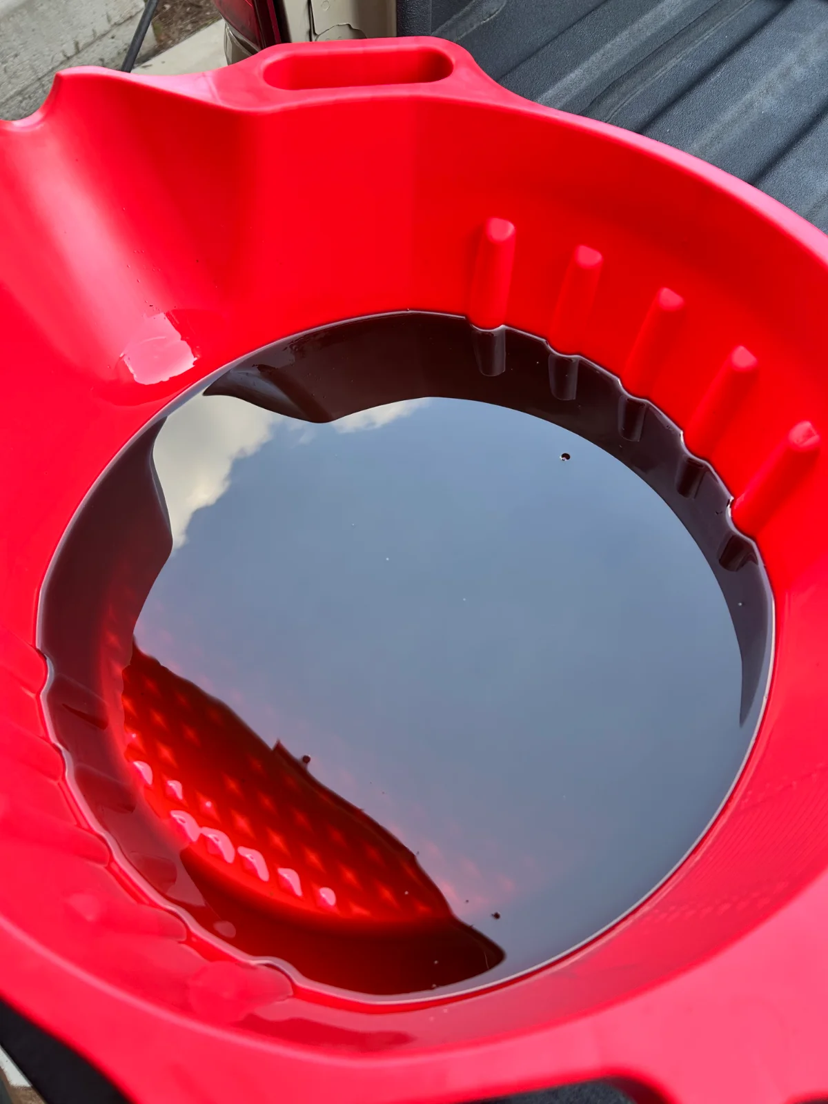

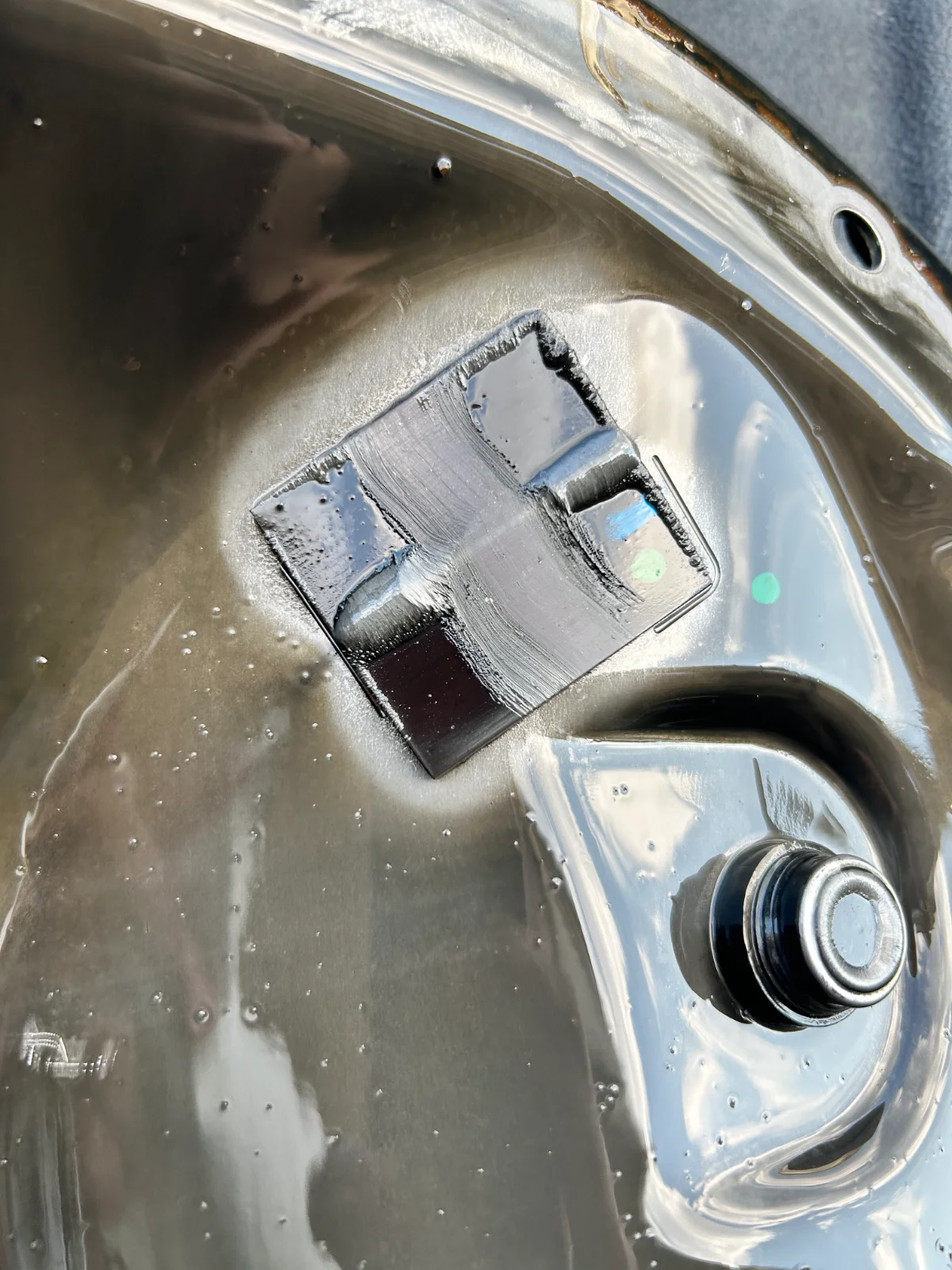

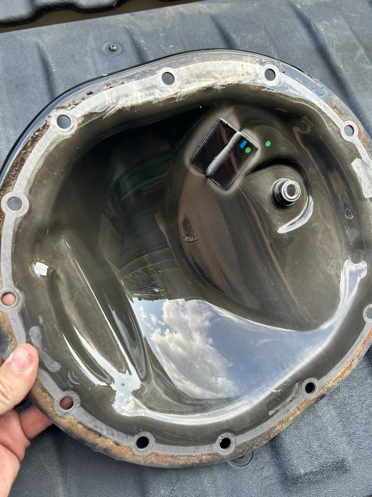

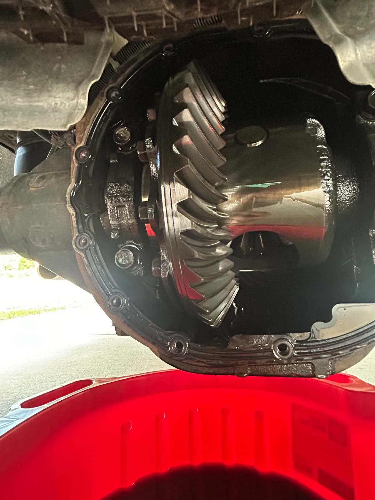

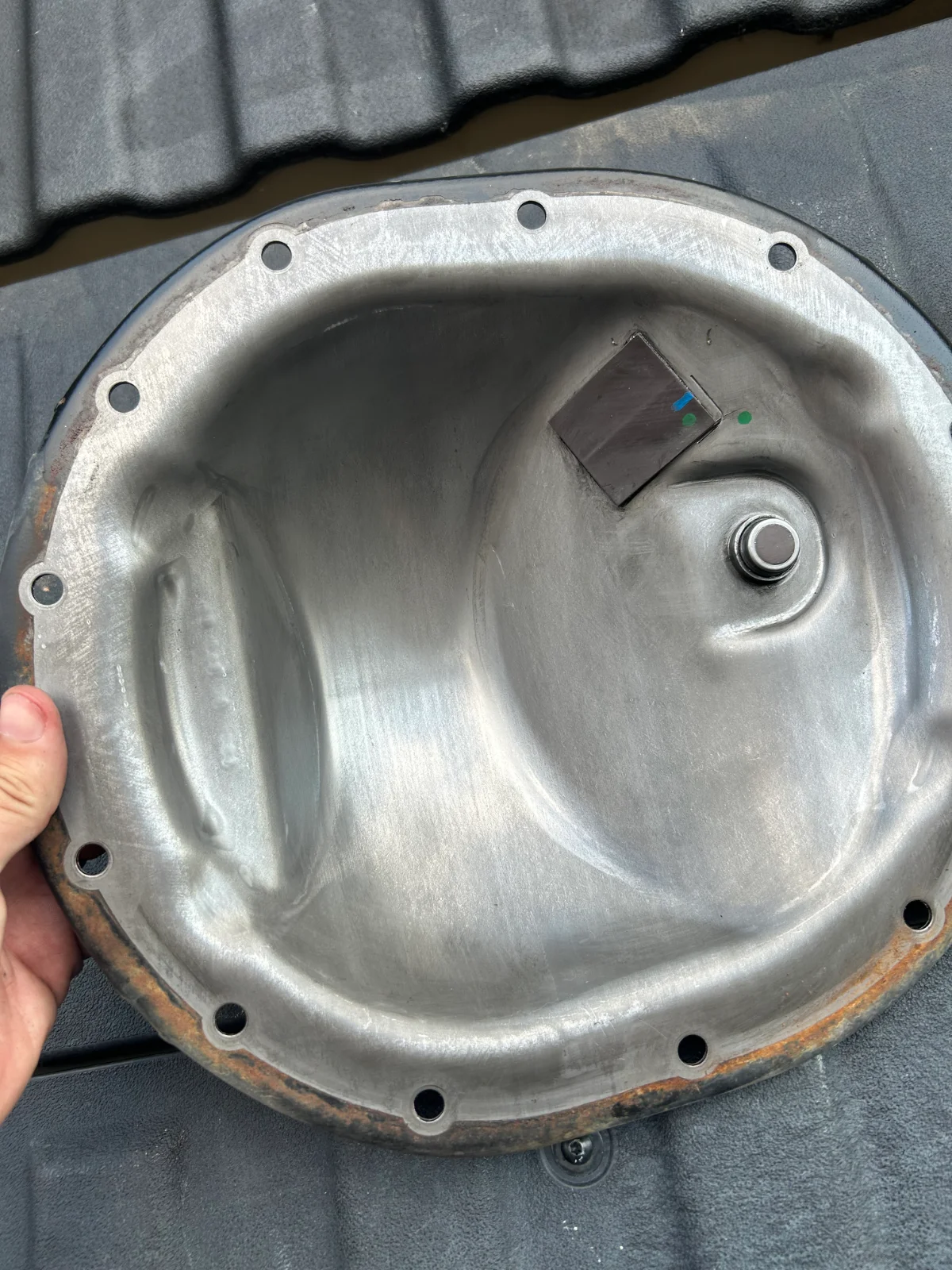

Did my differentials today. My tools for the t-case are packed up, so didn’t get to do that…. But soon. Rear looked pretty smoked at 63k miles, not sure it’s ever been changed. Front looked pretty good, so I’m wondering if they replaced the fluid with the engine or when they were working on the transmission.
Also, it’s worth noting that the front differential uses paper gaskets, so you’ll either need a new gasket when you do it, or some gasket sealer.
Also, can confirm, the front differential is a HUGE PITA…..
