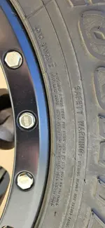

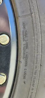

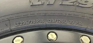

This is what you'll see on the side of a 10 ply rating, 295, Load Range E tire rated at 4080 lbs. They need a higher ply rating in the sidewalls to handle that kind of weight. Also that 129/126Q is the speed/load ating.
For those that haven't ignored and unignored me again for the 10th time and also for those that haven't left the chat (Bizon lol), you can thank me later when you find this information to be useful.
It wouldn't actually help to cut one open. Ply ratings do not necessarily mean the same nowadays, as the materials have changed (e.g., Kevlar), so you can achieve different ratings without more "plies". The load index is more useful.
