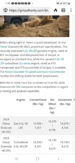

Hello all...can someone...Anyone explain to me #WHY/HOW on the new ZR2 HD, in regards to towing 5th wheel/gooseneck.....WHY/HOW is the Diesel rated at 18,700lbs and the GAS model is rated at 18,070lbs....again for 5th wheel/gooseneck....shouldn't the diesel be rated higher??....higher than 630lbs more....

Pretty sure you have the numbers wrong. The 6.6 gas is around 17k, the 6.6 diesel is around 18k. I'm not sure on a ZR2 specifically. I just know that's how it is for a crew cab standard bed HD. No way the ZR2 gas is rated more than other trims. It's actually less. It might be closer to 15k.
Also, I'm sure you probably know this. But I'll just throw it out there. Those ratings don't really mean much. Generally payload and GVWR are the limiting factors. IE I think the ZR2 HD has a payload of around 3,200. So you aren't pulling a 18k 5th wheel with any of them you are actually maxed out at around 13k lol. Pin weight is around 25%. Bumper pull is around 10%. So you would need a payload of 4500 to even consider a 18k fifth wheel

Ok thank you...your second comment is really helpful...and on the first comment...if you look on GM Authority site.....it's the numbers I stated AND when you search for Videos of them....ON THE STICKER of the DOOR...for the Diesel it's 18,700 and the 6.6l GAS it's 18,070 for the ZR2 2500HD.... but again your second comment was really helpful

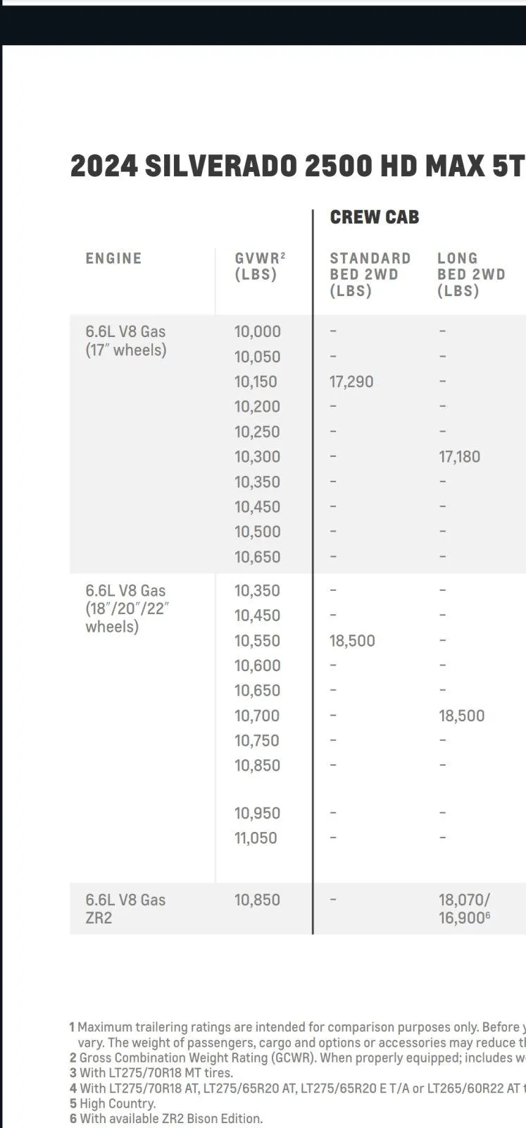

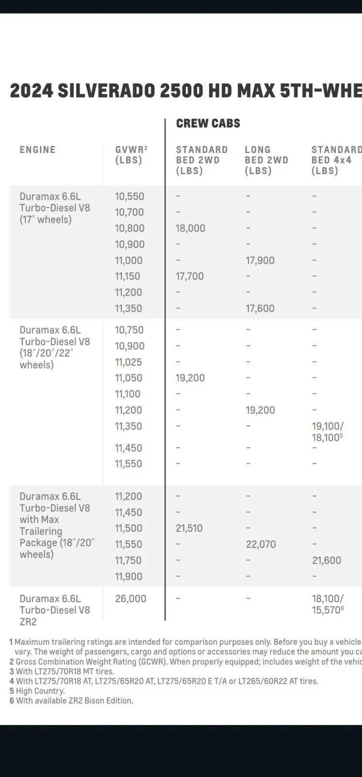

Wow that's really strange. I'm not sure why GM has them listed like that. The diesel is rated for slightly more on the trailering guide. But again neither can actually tow that legally. Here is some screen shots of the trailering guide from chevy.

Here's GMAUTHORITY.COM..... and thanx for the heads up...I got guys using airbags on their older model 3/4 diesels but I didn't want to do that with the Zr2 and the rv's I was looking at were around 13k dry and 16k loaded

Yeah I'd definitely shop based off that 3,400 and 3,200 payload they list for them. That will be the limiting factor. You might actually need airbags anyway. Even if you are with in the ratings. But airbags don't increase your ratings though.
You want those stickers on the truck and trailer to match up. If you ever get checked or worse have a wreck. Having a dry weight of 13k and a truck payload of 3,200 could easily cause you trouble. Not hard to figure out a 2k sxs in the back of that 13k trailer is well over the trucks ratings. That number also includes passengers, gear basically anything added to the truck other than fuel. So realistically you automatically deduct the driver's weight.
