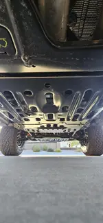

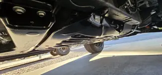

The Bison skids provide pretty good coverage, except nothing for the tank and rear differential. The front of the transmission plate should have been 2 to 3 inches longer.
These are 3/8 inch thick and would give good protection for routine off roading, but it won't support the weight of a vehicle, especially on a 2500HD that weighs 8500 lbs. They span too far and would crush right up into the pans. Also with the amount of cut outs, I think they would tend to drag and get hung up a lot.
The Bison skid are the nicest thing about that package, then the bumper that give you places to mount lights. Not sure you can get a set of skids, but I would guess they would run $3k and bumpers $4k.
That's where the Jeep market is so we'll served. You have an infinite number of parts and they really improve offroad capabilities. I was hunting a few weeks back and driving my sxs on a rough desert trail. I came upon two decked out Gladiator Rubicons running lifts and 38s. Probably $100k in them. I was surprised how far back on this trail they were. No way a ZR2 would have crossed those steep drainages. That's why I say the ZR2 isn't a hard core off roader, it a nice hust trail trail rig with plenty of capabilities.
Are those photos from a 2500 or 1500? It looks like it has torsion bars- 2500. As far as I'm aware the 1500 zr2 bison doesn't get a trans skid either. I'm hoping I'm wrong, because that'd make life alot easier
