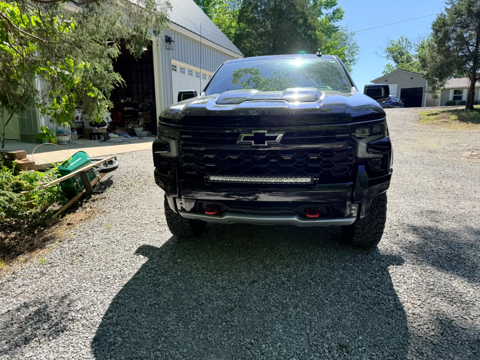

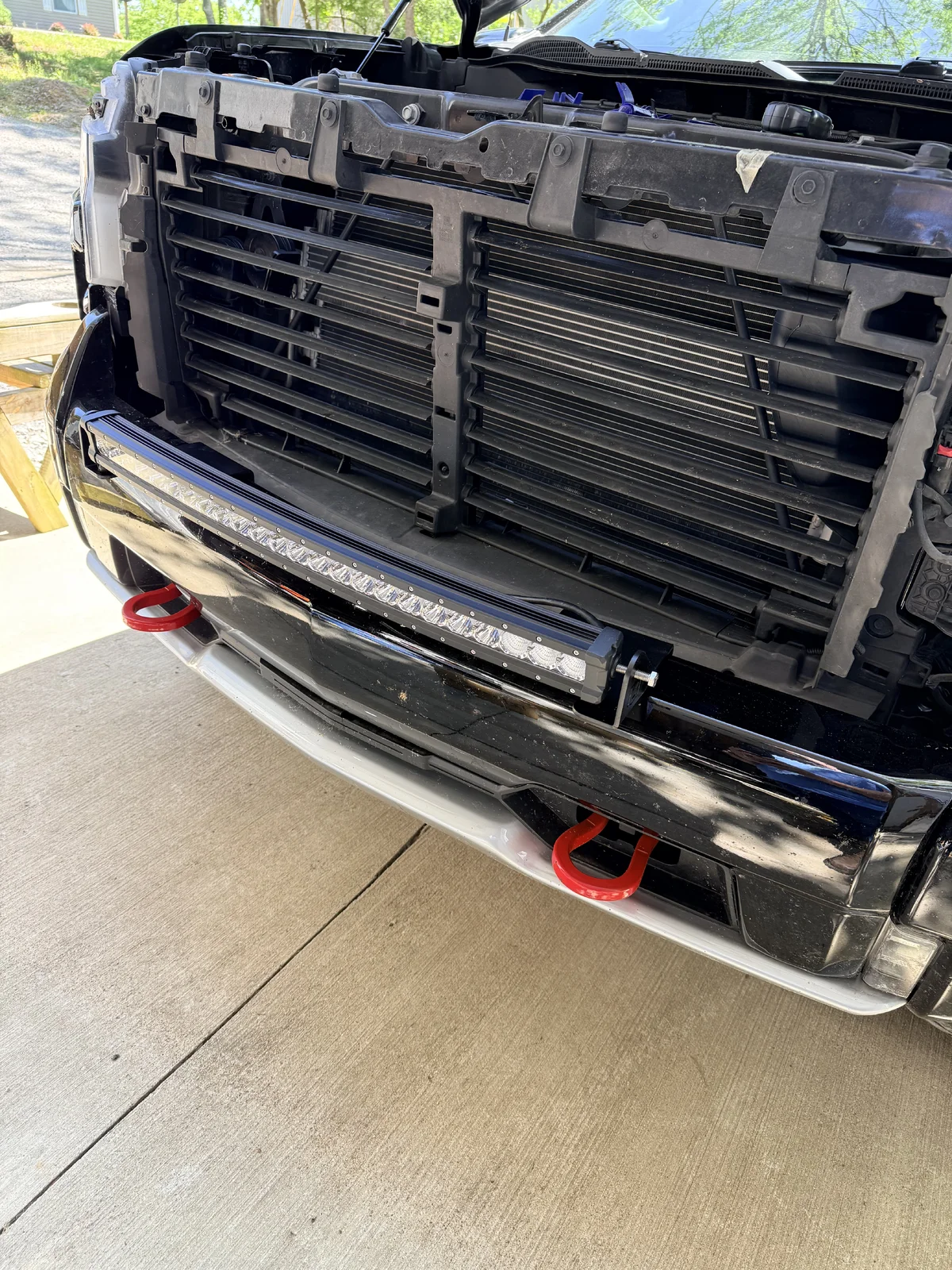

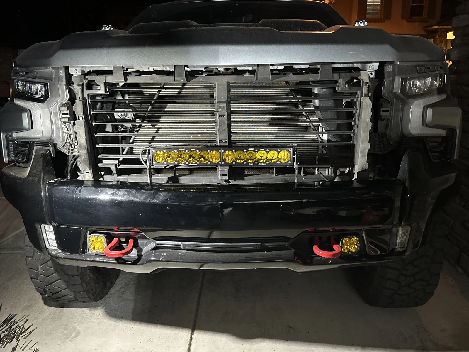

I’m working on an idea I had a couple of months back. Today is the first day I’ve been able to test fit. Trying to take photos as I go and it’s going to take a minor amount of fabrication but here’s a couple of teaser pics…

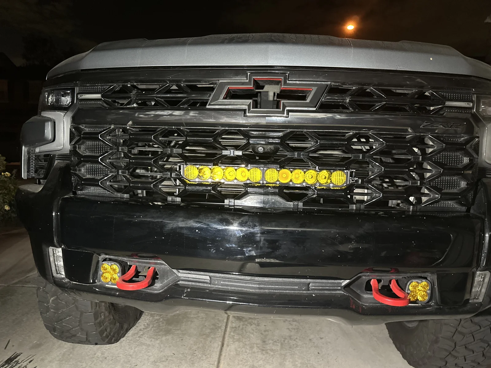

Here are a couple of pics with it installed

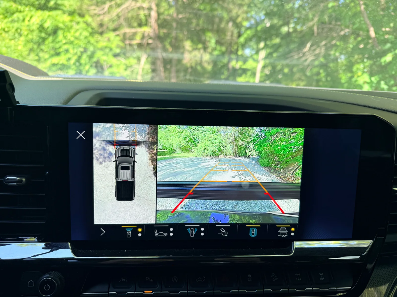

And here’s probably the reason why no one makes a front bumper bar mount like this:
The position of a light bar mounted across the bumper partially blocks right in front of the truck when the front camera is on.
Haven’t decided yet on keeping it on, but I probably will because I need the light at night more than I need the camera. I don’t think that camera is used for anything else, but I’m going to check it out.
Looks good to me!
Thanks Axe, I drove around with it today… the mount is really sturdy no shakes or jitters. The issue with the front camera doesn’t bother me so for now it’s staying on
You think you can relocate that camera to the bar above? I did that on my sxs both front and rear and it gave a better view anyway. All I had to do was drill a hole with a hole saw and it snapped right in. They make flush plastic plugs to fill holes.
I’ll look into that.

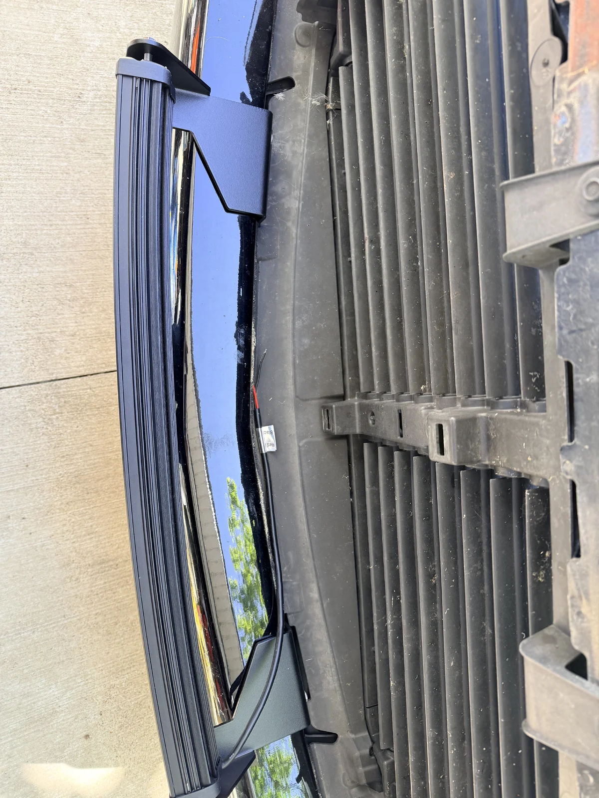

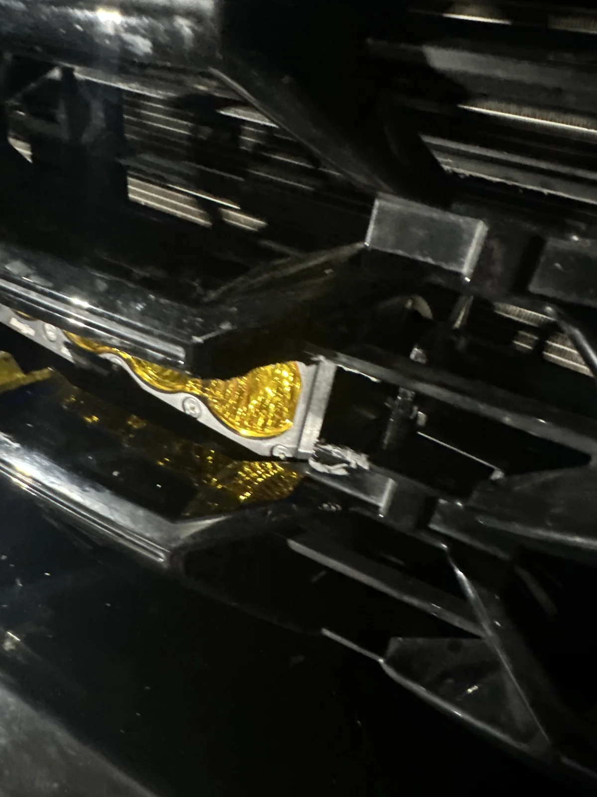

I got the brackets from zroadz.com, they are for 2019 and later non-ZR2 Silverado. I had to drill one hole on each bracket because the two bumper bolts are closer together. The factory outside bolts are just about perfect.
Swapped out the S8 light bar for a new OnX6 light bar, doubled the lumens. It fit but took some trimming on a couple shutters and cleaned up the grill cut outs so the entire light is clear. Mounts fit in the same spot which made it easy. Changed my ditch lights to the new Squadron 2.0 Pros as well. Love the backlight on them

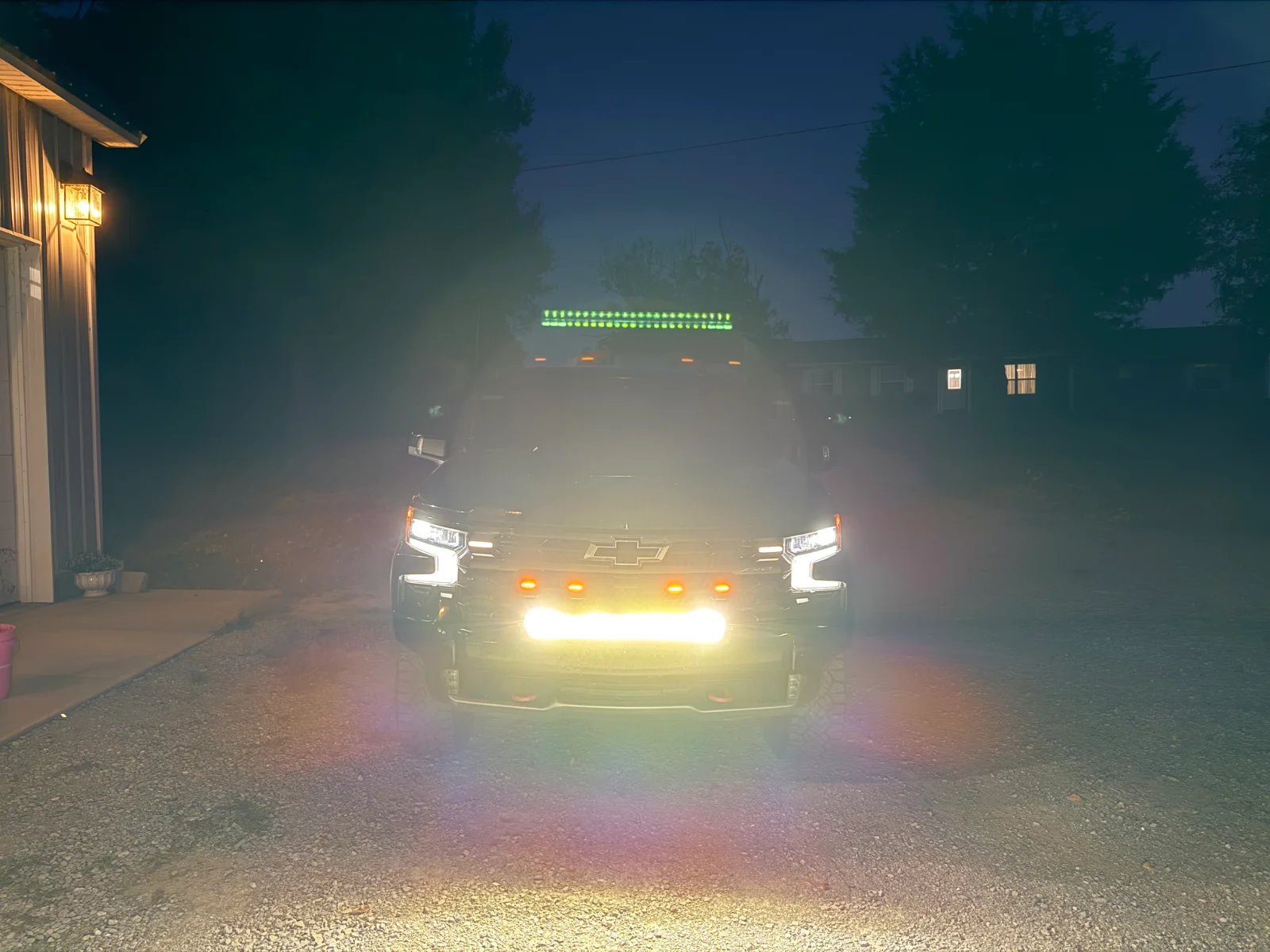

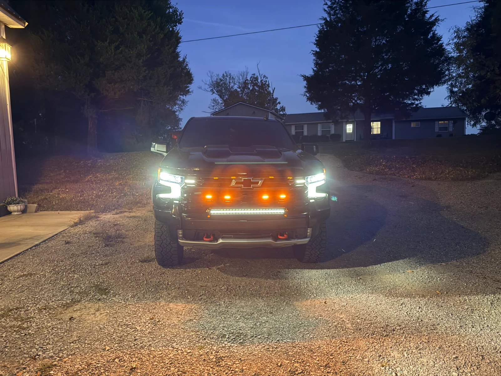

So over the weekend, I swapped out the single line curved bar for a dual row bar with a DRL. Still fit the Z-roadz brackets and the light throw is amazing for a sub-$200 bar
This is just the DRL:
This is with the bar on (ignore the green mirage at the top)
From inside the cab, low beams only:
High beams only
Light bar
I live on a lake and it’s two miles off the main road through farmland, so extra lighting like this makes all the difference in seeing deer. I’m pretty pleased with it.
