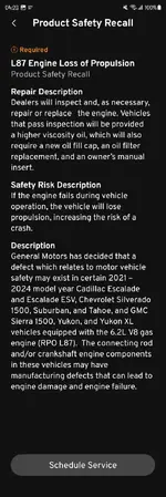

Here's what is listed in OnStar. Had to do two separate pictures to get the last sentence about bearing and rod failure.

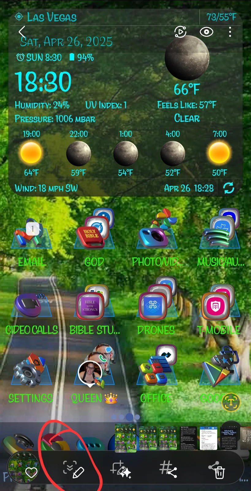

You can do one long screen shot....just hold the down tab before saving right after you start the screenshot.....
Like this.....
I'm not that clever! I just got a new phone. I ran over my other one. I didn't realize how bad my other one was until I got this new one.......probably all kinds of stuff I could learn......lol
