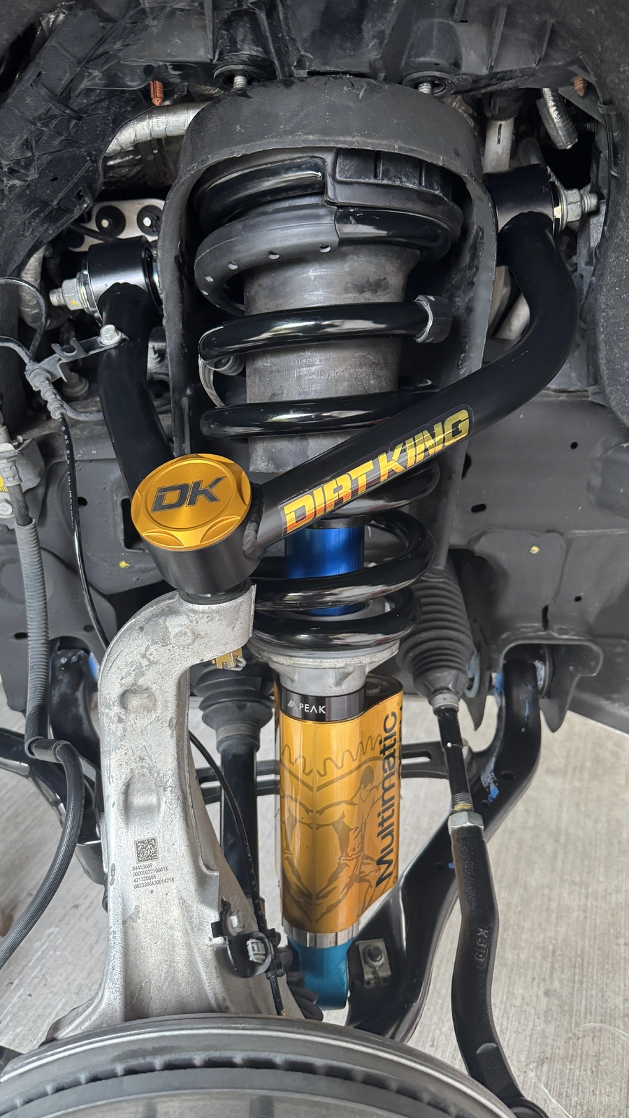

Before I bought the Dirt King UCAs, I sent an email to them asking about compatibility with the Peak 2.25” lift and the Multimatic shocks. Dirt King replied stating their tubular UCAs would work perfectly with this setup. One thing I’ll tell you that’s not mentioned in their UCA installation guide is the the removal of the service perch on both shock towers. To achieve the extra downward travel, those perches must be cut off. Cognito and Peak both have this in their instillation guides.

You will more than likely need at least a 3/8” spacer with stock wheels and tires to clear the Peak UCA. I ran a 3/8” spacer, then went o a 1.25” Bora spacer to push the stock wheels out a little more. Most seem to go with a 1.50” spacer. I chose the 1.25” to keep the tires just inside the fender well.

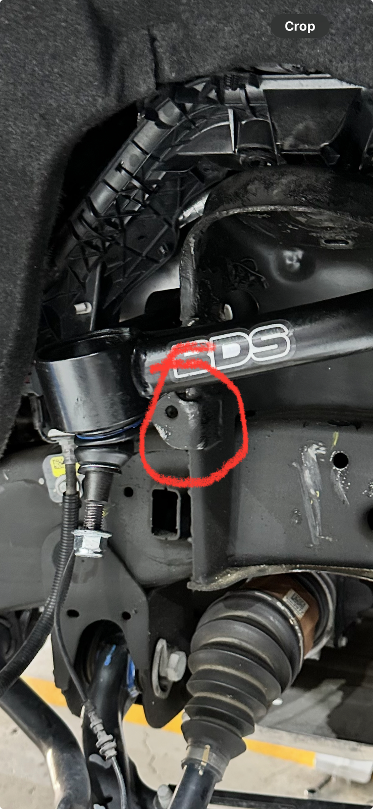

Unfortunately we don’t have cognito in Middle East, after deep searching i find BDS and rough country because after market uca ball joint is not popular here all most of the after market uca is uniball.
But if BDS not that good as dirt king I will wait.
Because the garage told me if i not going off road it’s better to keep it
And also after I installed the UCA with view days i find grease outside I don’t know that’s normal or not.
