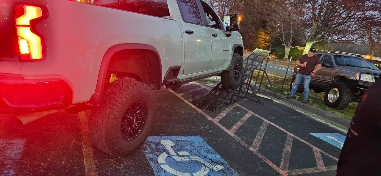

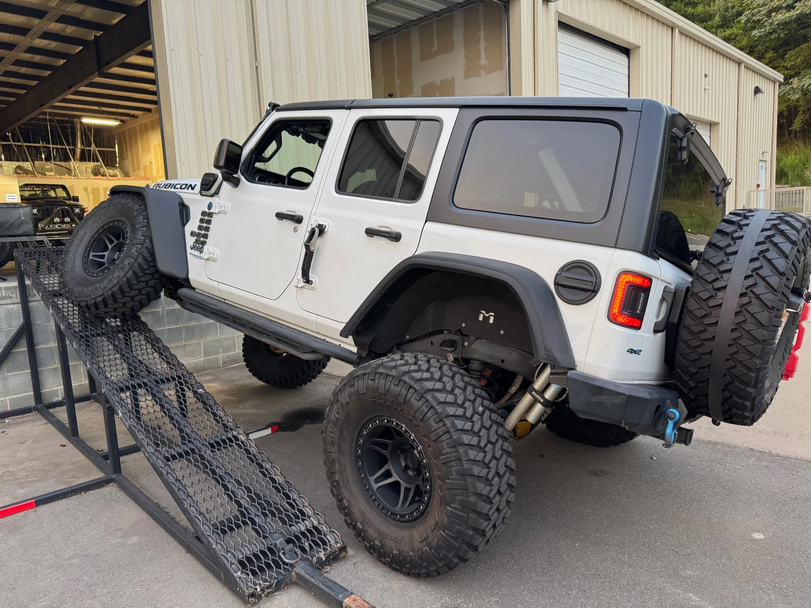

The rear normally isn't stiff enough to do anything off road and the rear seemed to flex fine on the ramp. A lot of Jeeps run quick disconnects on the links, but nothing wrong with just pulling the end link nuts and zip tying the sway bar out of the way.
Anytime you're disconnecting, you would want to air down anyways, so it's not adding any real inconvenience.
Connected, truck weight isn't sufficient to flex out the front:
Disconnected:

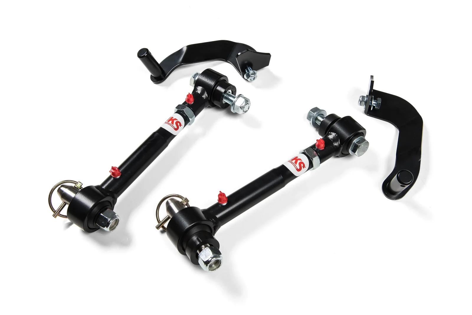

This is what the standard Jeep QDs look like, the bracket is for securing the link/bar out of the way:
