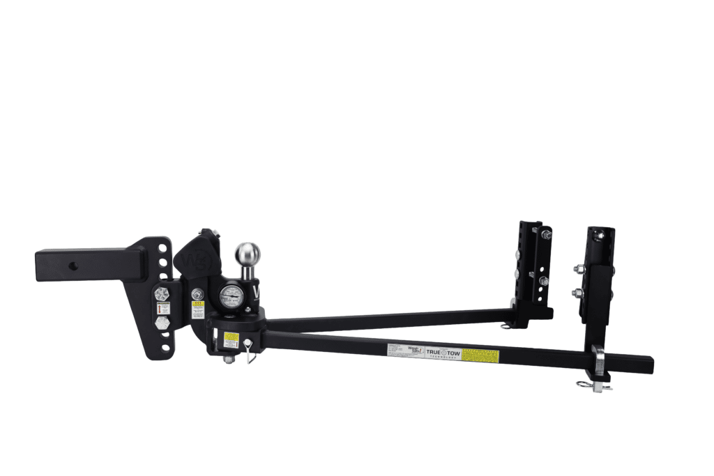

Tongue weight on my Trailer is 1500# Dry lol. With my KRX loaded, Trailer level and nothing else it drops down to about 11-1200#. I set my trailer a little nose down and with everything else loaded I'm at about 1400#. My Trailer's GVWR is with 1500# tongue weight. My hitch is the new style Heavy. I got it right about the time they changed them. Actually had to wait a little bit for them to become available after I ordered. You don't hear the spring bars while driving. When you are pulling in and parking you can hear them some. Specially if you have the windows down and you are on uneven ground turning sharp. But just normal driving on the road you don't notice them at all. The APP is easy. Once everything is setup, each time you hook up you just enter your current tongue weight and the app tells you how much pressure you should add to the bars. Takes the guess work out. If nothing changes you don't have to change anything. If you need to add more or take some off the bars you just loosen one nut and turn that bolt in front of the ball. It's a pretty neat setup.
Is this what you have? What drop height did you buy?
Yes sir, Drop height just depends on your trailer's height. My bar is just a 4", But for my trailer to sit level, I actually flip it over in the rise position, lol. That's why I got the shortest one so it wouldn't be in the way of the tailgate. But now I actually pull it with the nose down some. With my trailer level I don't quite have enough tongue weight with everything loaded. Some of that is because I removed the lead battery from the trailer's tongue. With no load my trucks hitch height is 26". So you just park your trailer level and measure from the ground to the bottom of the ball coupler. You subtract that from your trucks hitch height and that's the drop you need. My trailer is 28" is why to be level I need the bar flipped over in the rise position. Most trailers are more like 19". So probably a 6" or 8" drop would cover most.
Put some light grease on the springs and rails and it will articulate easier and reduce or eliminate the noise. You have to clean and regrease often cause it'll collect dust. Just wipe as much off as possible and spray it was some carb/brake cleaner.
I don't mind what little noise they make. The friction is what does the sway control part. Aftermarket companies make plastic wear pads to quiet them down, but still allow friction for sway control if the noise bothers you.
I've never heard mine cause I grease it. Mine's never swayed cause its set up right, mine doesn't bind cause I level it with bags installed on on day 10, not day 500.
Also if you are going offroad or off camber you can unhook the sway bars and use an HD rubber strap to tie them out of the way. The camper can then articulate more easily and wont bind up. Also works if you are backing into tight corners or spaces, like in the desert or woods.
No wierd gimmicky plastic kits needed if you think about it all bit. Towing is easy!

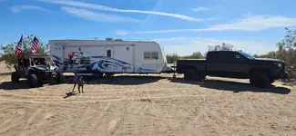

I just like TT better. I always end up hauling stuff in my bed. Not to mention 5th wheels can be a bit tricky to get right. Trying to keep enough bed rail clearance while still keeping the trailer level can be a challenge. All my friends with 5th wheels have hit their bed sooner or later. It's just really hard to avoid on toyhaulers where you aren't always on level ground. Especially because you have a over all height limit and trucks keep getting taller. So you can't always just lift the camper for clearance. People like them because they pull better. But as long as you setup your TT right, they pull good too. My speed is limited by the trailer tires and Johnny law, not because it's a bumper pull. One other big advantage to a bumper pull is if your 6 hours from home and your truck goes down. It's much easier to get your trailer home. You can just rent a truck from enterprise truck or even a Uhaul to drag a TT home with. A 5th is going to require phone a friend or a pricy tow fee to get it home.

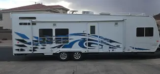

Great points my friend and thanks for the reply! I've been looking at the Brinkley TT online and this one may be worth looking at with the wife:

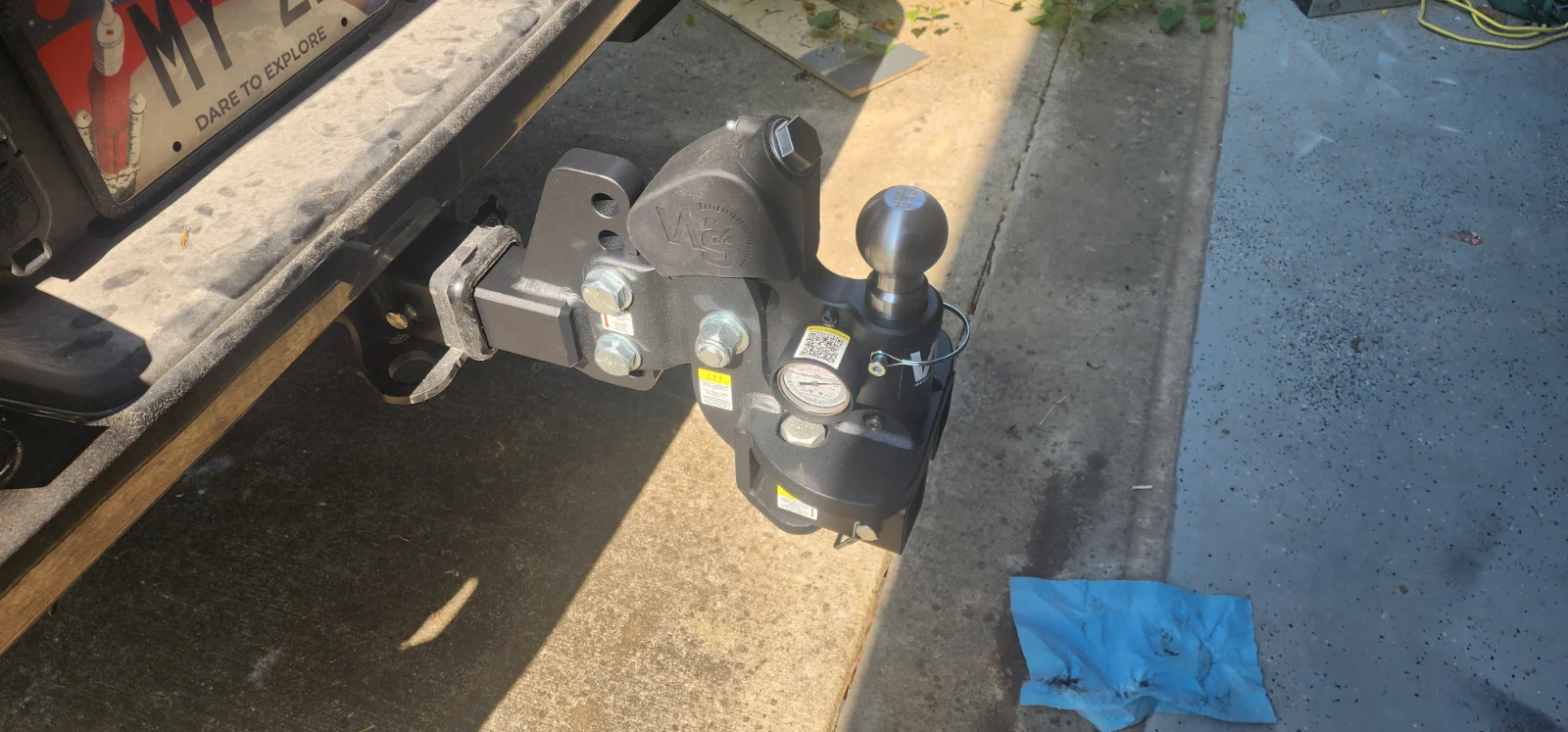

I just ordered the Propride P3 1400 hitch with the 2.5” hitch for my setup. I was going to wait but they had a $400 rebate for the 4th so I figured just to get it. Came to $3,655 shipped. Seems like there’s significantly more people using that than the Hensley’s and the Propride is rated to 20k lbs. I figure between that hitch and the airbags on my truck the setup will be just about perfect.

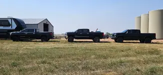

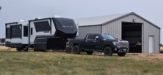

I know a guy with a 40 foot Brinkley that is four season rated and it cost a fortune. But he lives in it year round and travels for work, so he's got his Harleys in the back and he loves it. I think for him the extra creature comforts make it liveable. He tows this with a 3500 SRW. Here it is when he was doing some work for me last summer.
