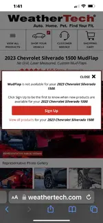

www.weathertech.com Great fit and OEM appearance.
I was curious to see what they look like. WeatherTech makes good products but currently they DO NOT make mud flaps for a 23’ ZR2. Their site actually asks if you own a ZR2 model.
