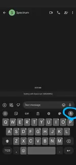

I see a lot of these radio cutting in and out along with the ac. I have noticed if your phone starts listening like google or Amazon ( even when my wife is browsing) if your phone starts listening it will cut the audio and turn the blower lower so the car can hear you better. Is this something you all have going on ?
Try and test it out. Start a text and click the speak to type button and it should cut everything down in the truck
Hope this helps

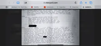

I recently took my 23 in for service, and saw the update codes for the splash screen and audio cut out fix. Had the dealership update it, and so far it works fine.IMG_3813.webp
