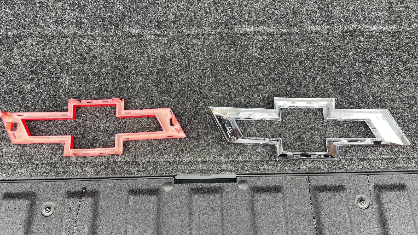

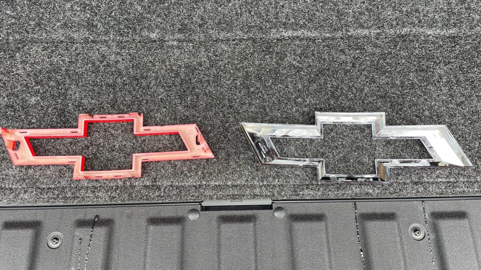

Nope. Patience and a trim tool. Be careful not to scratch the grille coating under the FlowTie. The red part of the FlowTie may try to separate from the chrome part and can probably brake if you get to aggressive.
Here’s a picture of the back of the two parts. The tabs that hold the FlowTie are on the red part.
I have been looking for an example like this! Thanks for the post. I wish they, or a quality aftermarket company made different colored inserts. Maybe a couple years and the HD hitting the streets will help something like that come to pass, would just be nice to have the option for the red insert to be color matched to the truck
