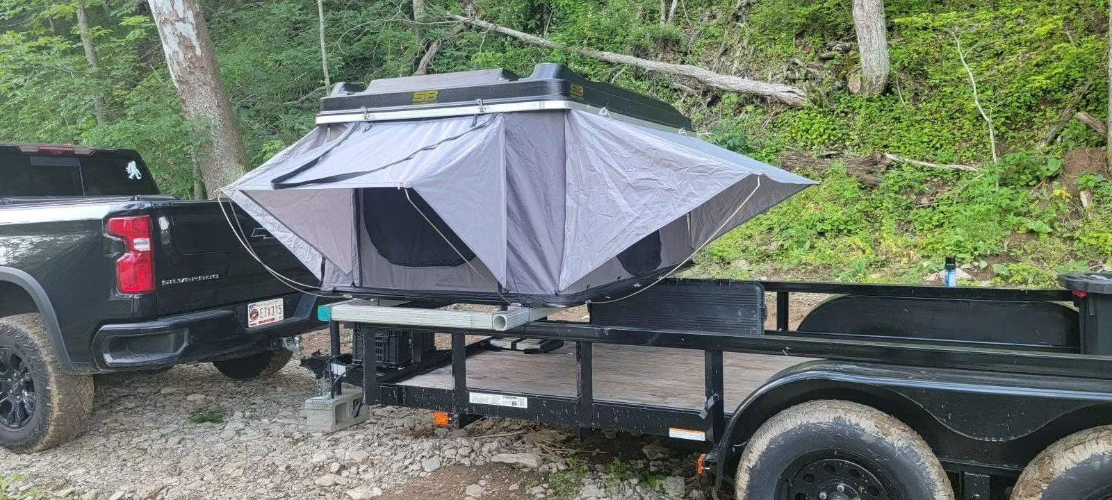

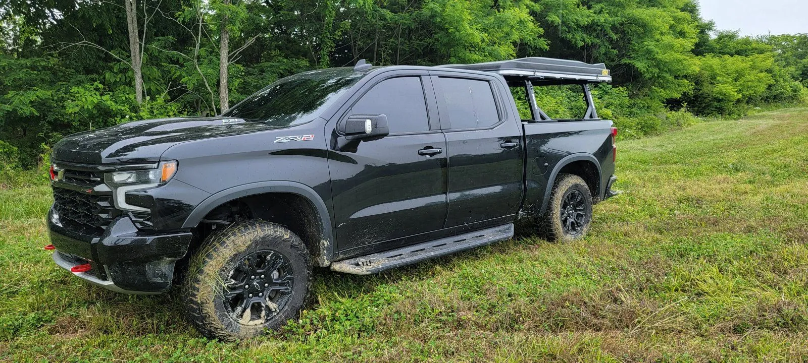

I installed a yakims Overhaul HD rack and a Smittybilt hard top rooftop tent.
I mounted the tent on my trailer, while I was waiting for the Yakima rack. I'm 5' 11", 210 lbs, my boys are 9 and 11 and there's plenty of room in it.
We're heading to Florida, Tennessee and Wyoming. It's all going to be overlanding. I'll post picks of our trip and inside outside of the tent. I have a SmartCap ordered but it won't be in until July.
