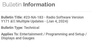

I have the at4x but I experienced similar issue with my puddle lights and I had them install the newest update for an unrelated issue and the update made the puddle lights much much brighter. I don’t know why or how the update fixed the lights but it was night and day difference after the software update.
What software update?
Unfortunately I don’t know. It was about a year ago. Since then I’ve had a few updates. If I remember right, it was when I had it updated with the new boot up screen to show at4x instead of the generic at4. That fixed the lights. The software updates on these vehicles are a pain and seem to have different results vehicle to vehicle. Plus the dealerships don’t seem to be on the same page when it comes to knowing what’s new and available. I would take it in and ask them to download the newest update. Beware though, sometimes new updates on these things fix one thing and break others…
