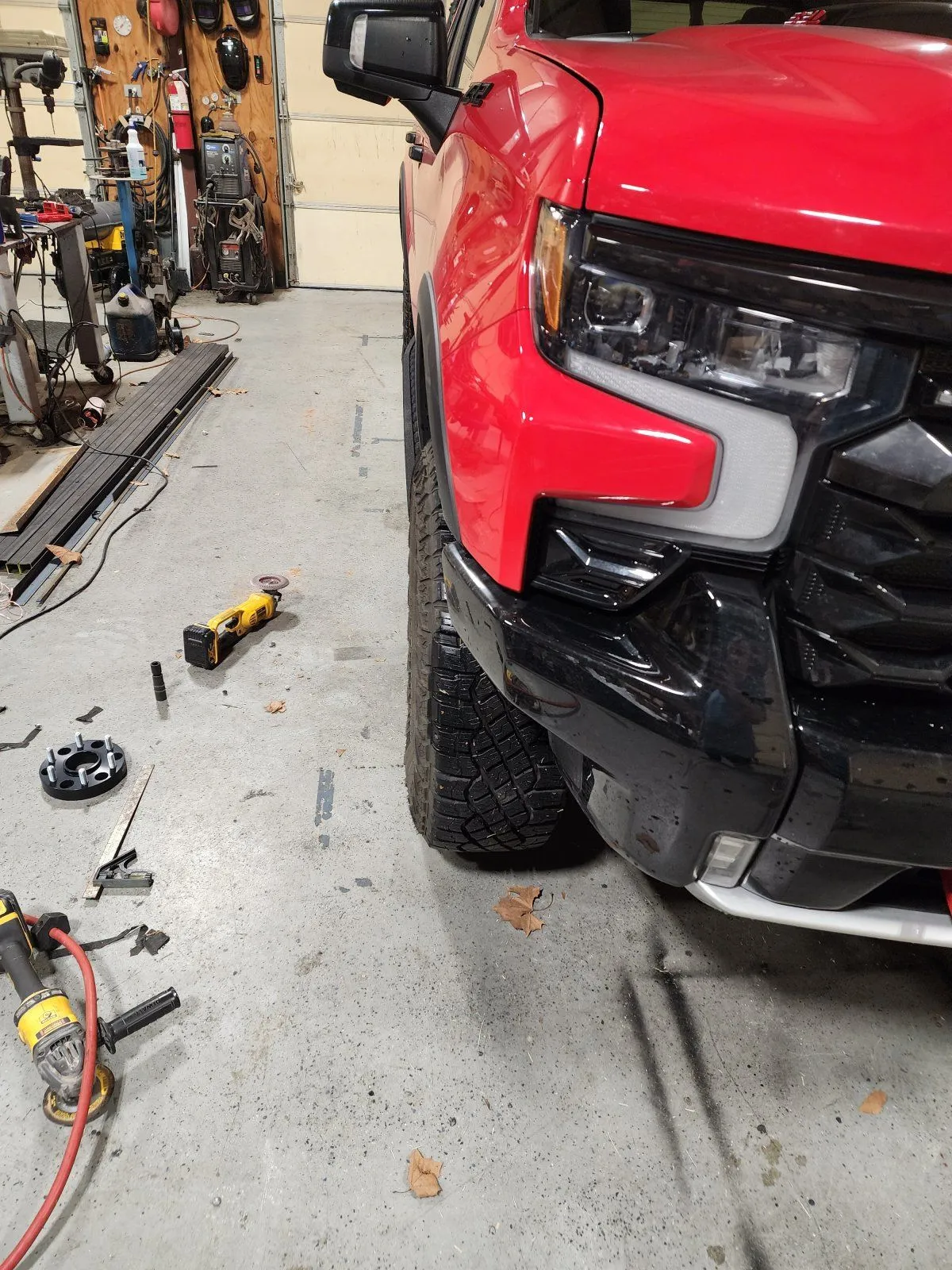

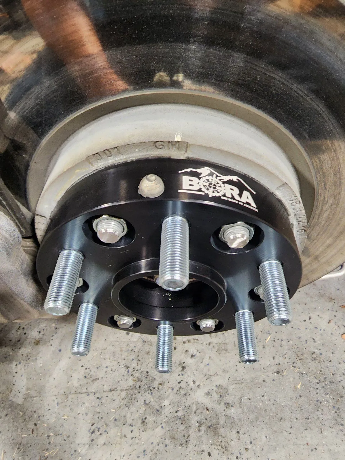

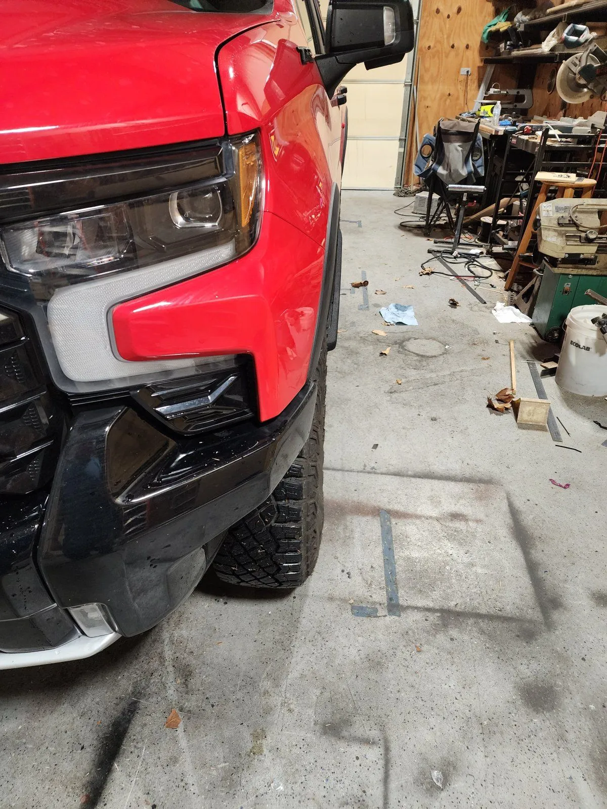

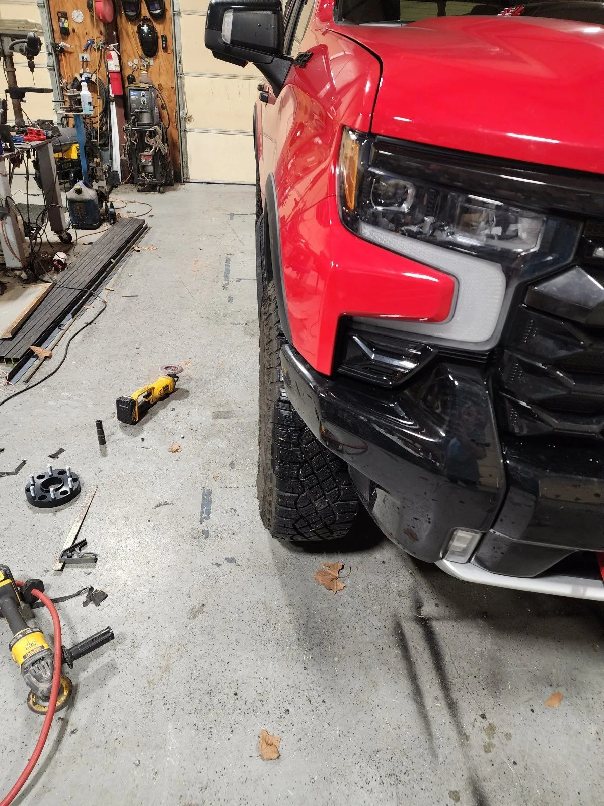

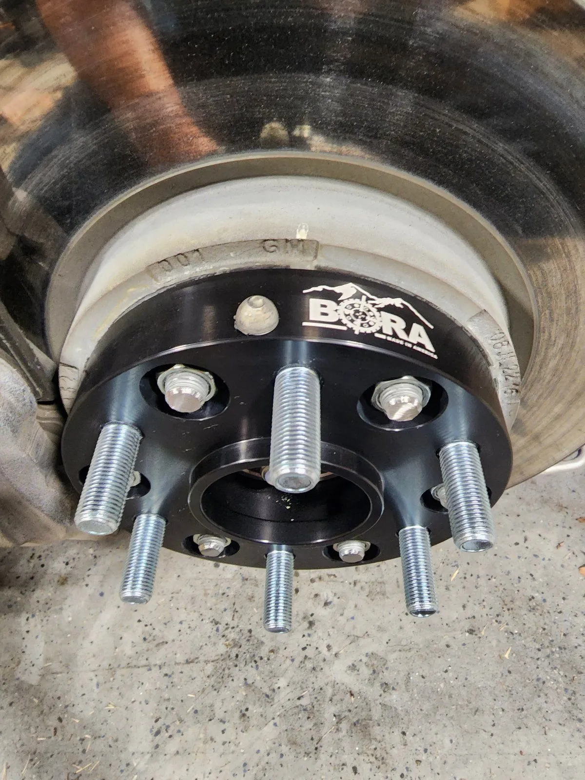

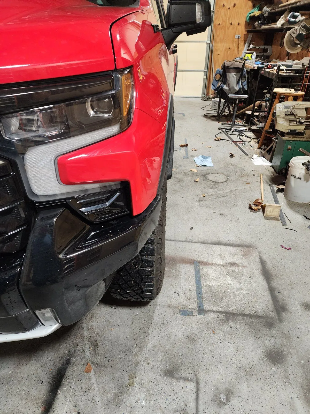

I put 1.25 spacers on my truck today. Really like the stance and the tires are still in the wheel wells. I did trim the studs a little, but no threads. Just the extra nub on the end. Pretty sure you could just grind them down a little if you didn't want to cut them. Really didn't need much.
In the pictures the drivers side is stock passenger has spacers. You can see how much of the stud I removed.

Exactly the type of look I go for. 1.5’s are just enough to be too much.
How’s the clearance? Thinking of going with 285/70’s when my Goodyears wear out. Just a touch larger. 33.7-34 depending on what tire it is.

Clearance is good. Nothing touches anywhere. Nothing touches when flexing the suspension. You actually gain a little clearance from the Upper control arm because it pushed the wheel out a little. Not sure if you have noticed, but stock the tire is very close to the UCA. I'm still on stock tires, so I can't say how it is with larger tires.
