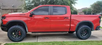

I have a 22 ZR2 with 35x12.5x17 with a 0 offset wheels. Had some rubbing issues at first but made some cuts and removed a bracket and made more than enough clearance for the 35” along with a 1 1/2” leveling kit from Rough Country.
Soon going to be trying to stuff some 37” on here but also going to try peak suspension new 2 3/4” leveling kit with there new UCA for the Silverado ZR2. But am going to need a block to lift the rear end.
Anyone have any suggestions on witch one to get?

What brand tire is that? They look rugged.
If your gonna run 37s, why not go with the BDS 4 inch lift? It seems like that would give you more clearance, but may not resolve the issue of narrow wheel well width.
They are mickey thompson baja legend exp mtz
Those are nice looking tires.
I think it's just MTZ, the EXP is a different tire, not as aggressive appearance.
I don't think there is any chance of you fitting 37" tires with that set up. The Peak kit you are referring to is 2.25". I have that kit installed. I went with Ready Lift 3" blocks and u-bolts in the rear along with Cognito UCAs. I had to space my bumper forward 5/8" and cut the bumper some. I also removed the rear bracket and pulled the liner back just to clear my Toyo MTs 35/12.50r20 on 20x9 wheels with 0 offset. I just don't see a 2" taller tire fitting. I attached a pic of the rear blocks I ordered from Rrady Lift. I believe the part # is66-3003. My front and rear fenders measure 42 7/8" from the ground. It is dead on level.

I considered going with the rt trails but they ran small for 20" wheels and I have always wanted the Toyo MTs but always went with something else. This time I said I'm just going to do it.
I went with the Cognito sm (sheet metal) ball joint control arms because of the sturdy build (fully boxed welded and maintenance free press in ball joints. Peak's are tubular style and uniball. Cognito sells both styles (sm vs tubular) and they said the sm style was stronger. Also, I live by the coast...lots of dirt, dust, salt, and rain which will wear out uniballs.
Yes it will rub in the rear corner of the front fender wells with 35s. The bracket removal and a good bit of trimming is required.
I've ran the boxed Cognito UCAsfor about 10 years on other HD trucks. Held up well. I also ran their extra braces off the idler arm and pitman arm, which made for a lot better life running large MTs.
I run 295s on my trucks. With 20 inch rims on my HD they are just under 35 inches but I can run 80 psi for towing. With the 18 inch rims on ZR2 they are only about 34.5 inches. With trimming bumper corner and plastic fender well protector, I don't rub but still close in rear.
