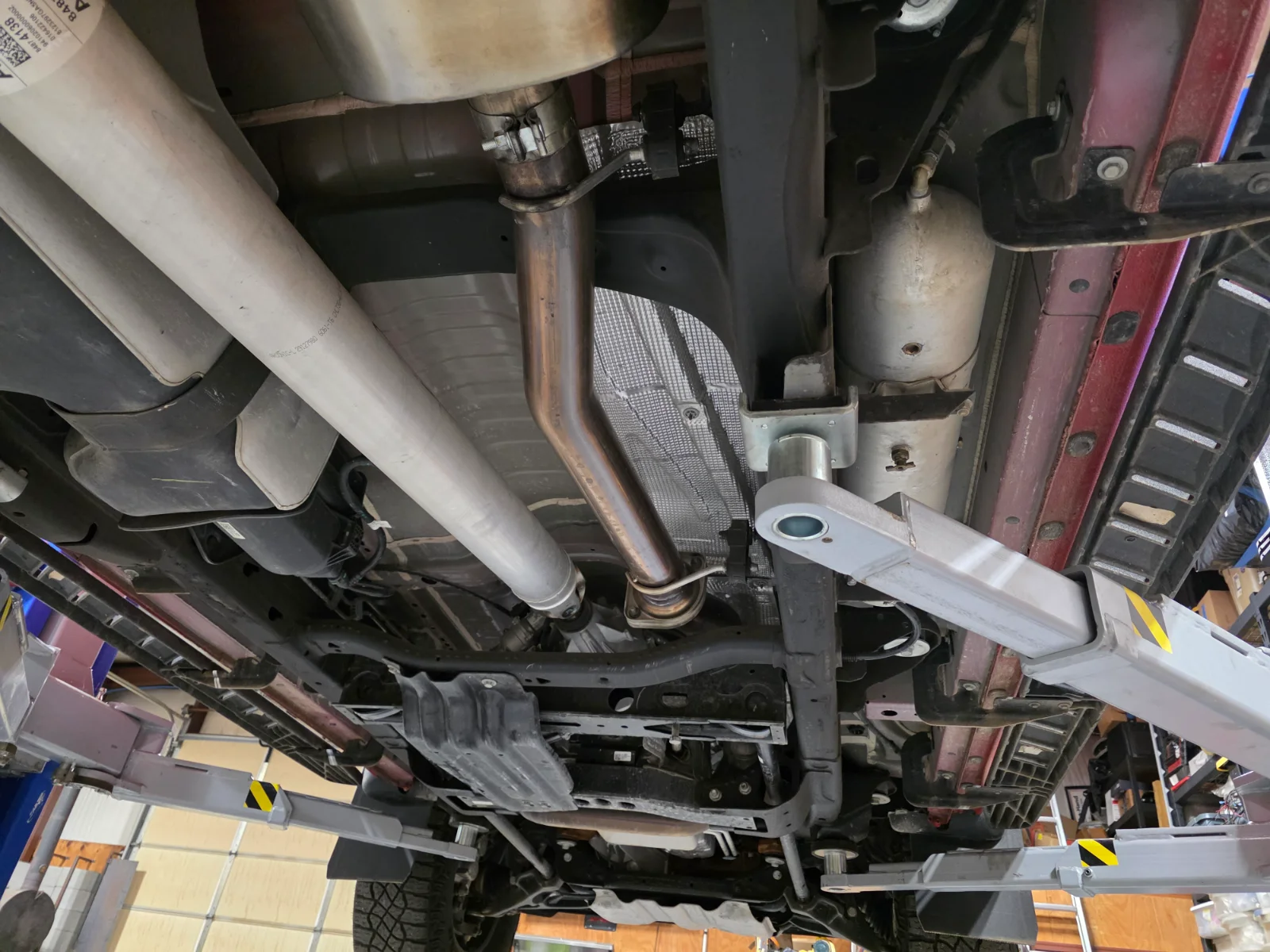

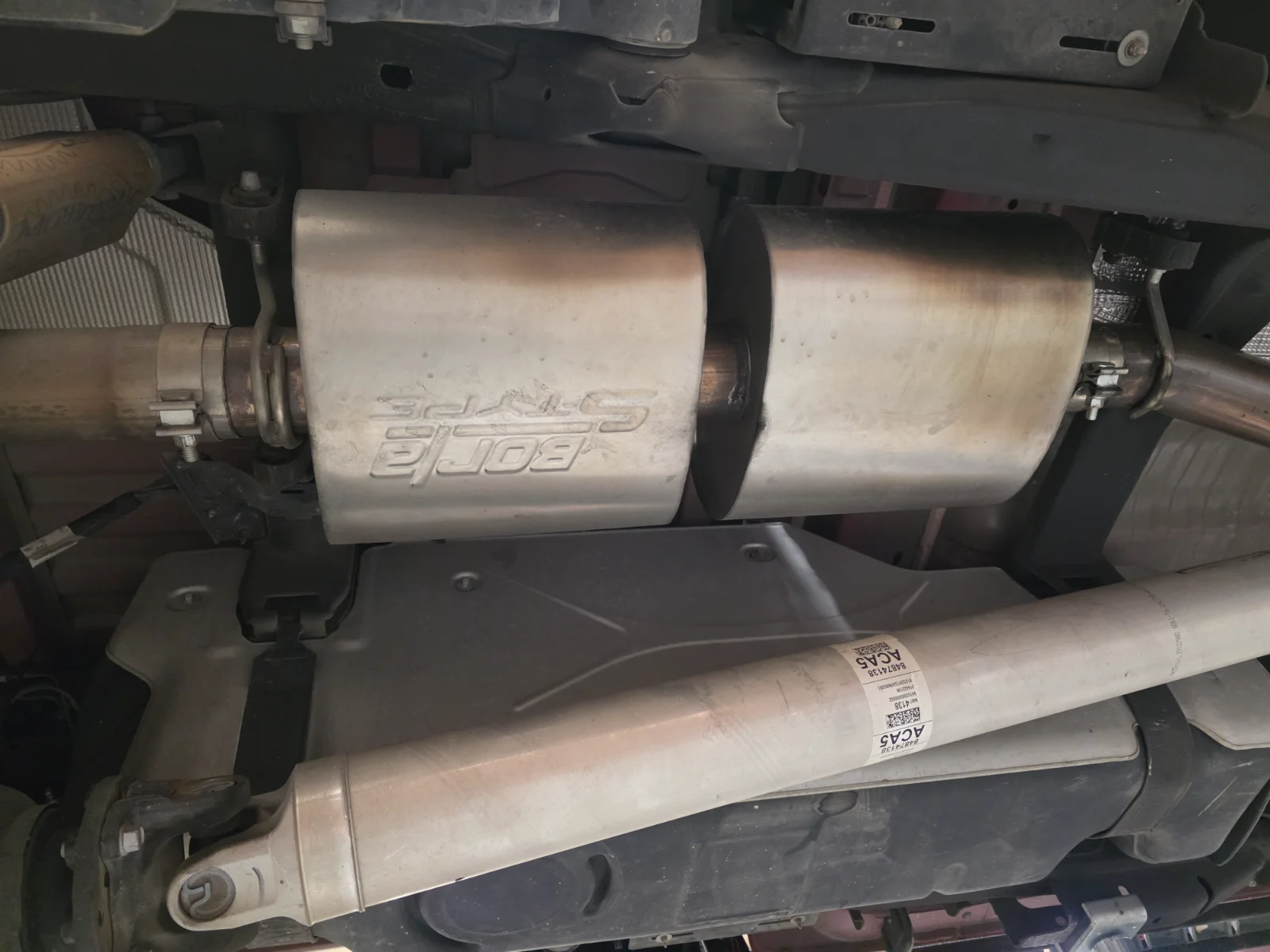

Yeah, so I ended up cutting out the 3rd cat and replacing with the same 3 1/2” pipe, removed the factory muffler and went with a Borla 3 1/2” truck 24” muffler, I cut the tailpipe and dumped it right after the rear axle. I also installed MSD’s blaster coils, Moroso Ultra 40 8.5mm wires and a set of AFE stainless steel headers…. No lie, 35-40% gain in MPG’s and not too loud which is what I wanted. I don’t like loud “Takuache” annoying exhaust. Truck runs beautifully, I wasn’t looking at increasing horsepower cause my intention is to not race this 8000lb tank but to gain its full power potential 🤙🏼
Forgot to mention I also installed an AFE cold air intake and swapped my mass airflow sensor with a JET Performance MAF
