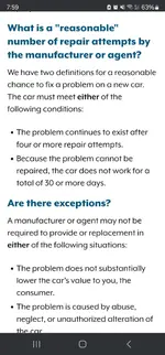

Hydraulic Lifter failure in cylinder deactivation lifter. 2017 z71 6.2. Max towing package 3.42 rear end. Failed at 11000 miles idling in driveway around start covid. GM repaired everything to specs and procedures. Full set of new wear parts, cam, pushrods, lifters, oil
stuff. Exhaust gaskets. Everything listed in book to avoid issues. Retuned motor. Ended up 2 mpg better on highway. Even paid 2.5 months of my payments
About 1500 because they had to wait for parts. Traded truck at 47k miles and never had another issue. This is how they avoid recall. I heard a lot of dealers doing band aid jobs. When push rod seized and bent it dinged cam. Everything needs to be replaced for proper wear per GM. Fortunately I was under warranty. Fortunate I had a good dealer, set me up with GM rep to resolve issue to my satisfaction.
