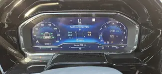

Yeah the ambient temp thermometer is never right, reads way high. It hit 118 today about 5 PM, but when I took this picture it was only about 113. After about 1.5 hrs of driving it did drop about 5 degrees.
