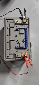

I tried to rescue this turd, but it just wasn't gonna happen. Pulled the "maintenance free" plastic cover off the battery, which was held in place securely by adhesive. Turns out you can maintain it and the caps were just soft plastic caps held in place by the cover.
Every cell was low on electrolytes and the specific gravity was way off. Added some electrolytes and charged a few more times with a couple chargers. Battery would sustain 13+ Volts, but it just wouldn't handle a load. Recovered about 150 CCAs, but still 600 short of spec.
I guess it was purchased about 6 years ago in 2017, so pretty good life. Had to cough up $300 for another one. Probably another $750 for the trolling motor batteries.
