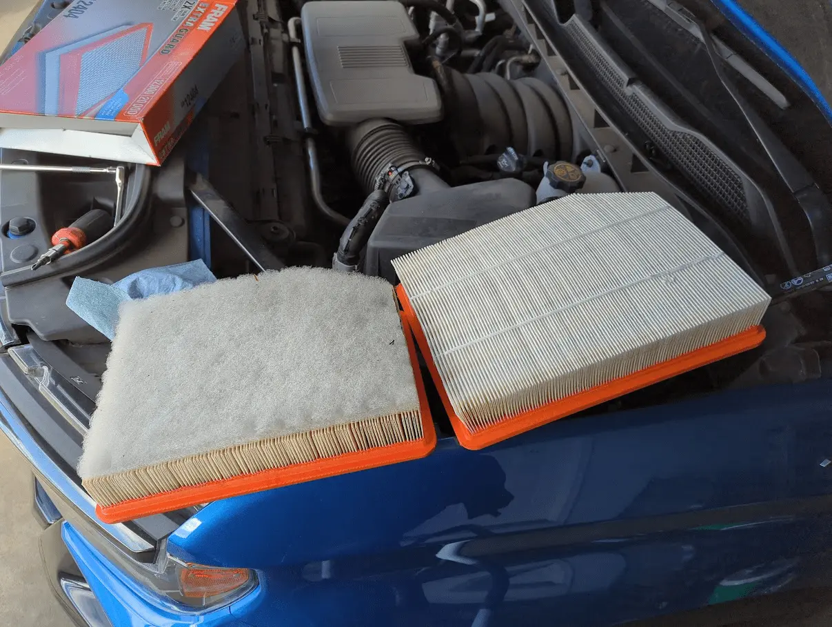

I ran into a bit of a weird anomaly while doing my oil change today. The first service was free, done by the dealer where I bought it, as each truck comes with a free service. No big deal. I normally do my own basic maintenance, as I'm sure many of you do. The oil life was down to 15% or so, so I figured I'd get that out of the way. The air filter was only at 55%, but figured it wasn't too expensive, so I'd change it too. Did the cabin filter while I was at it. Why not.
So I get everything done but the air filter, and I open up the box and pull it out and notice there's a pre-filter on it. The new one from Fram does not have this... and neither do any of the other brands at the auto parts store. I went ahead and put the Fram in, but I was wondering if anyone knew what the actual part number was, or if I need to come up with my own prefilter media and cut it to fit? Seems unlikely, but I'm not ruling it out just yet.
It doesn't really look like it in the picture, but the 2 types of filter media are glued together on the AC Delco. Factory AC Delco on the left, Fram on the right. The pleated parts are the same depth, and they both have about 100 or so pleats.

I use K&N filters. Either the oiled or dry, your preference. I figured the pre filter is why GM says it has a heavy duty filter.
That pre-filter isn't really doing much filtering, except for coarse material. It'll prevent the filter pleats from plugging up due to bugs, sand, leaves, etc. If you change your filter frequently it won't matter so long as you got a decent filter.

I think you're on to something AXE, there were quite a large number of little bugs in the pre-filter before I banged them into a shrub... I didn't figure it was doing too much, but I'll get the actual right one in there next time.

Here are the 2 air filter part numbers.
ACDelco Part # A3244C (Heavy Duty w/fuzzy stuff)
ACDelco Part # A3246C (w/o fuzzy stuff)
