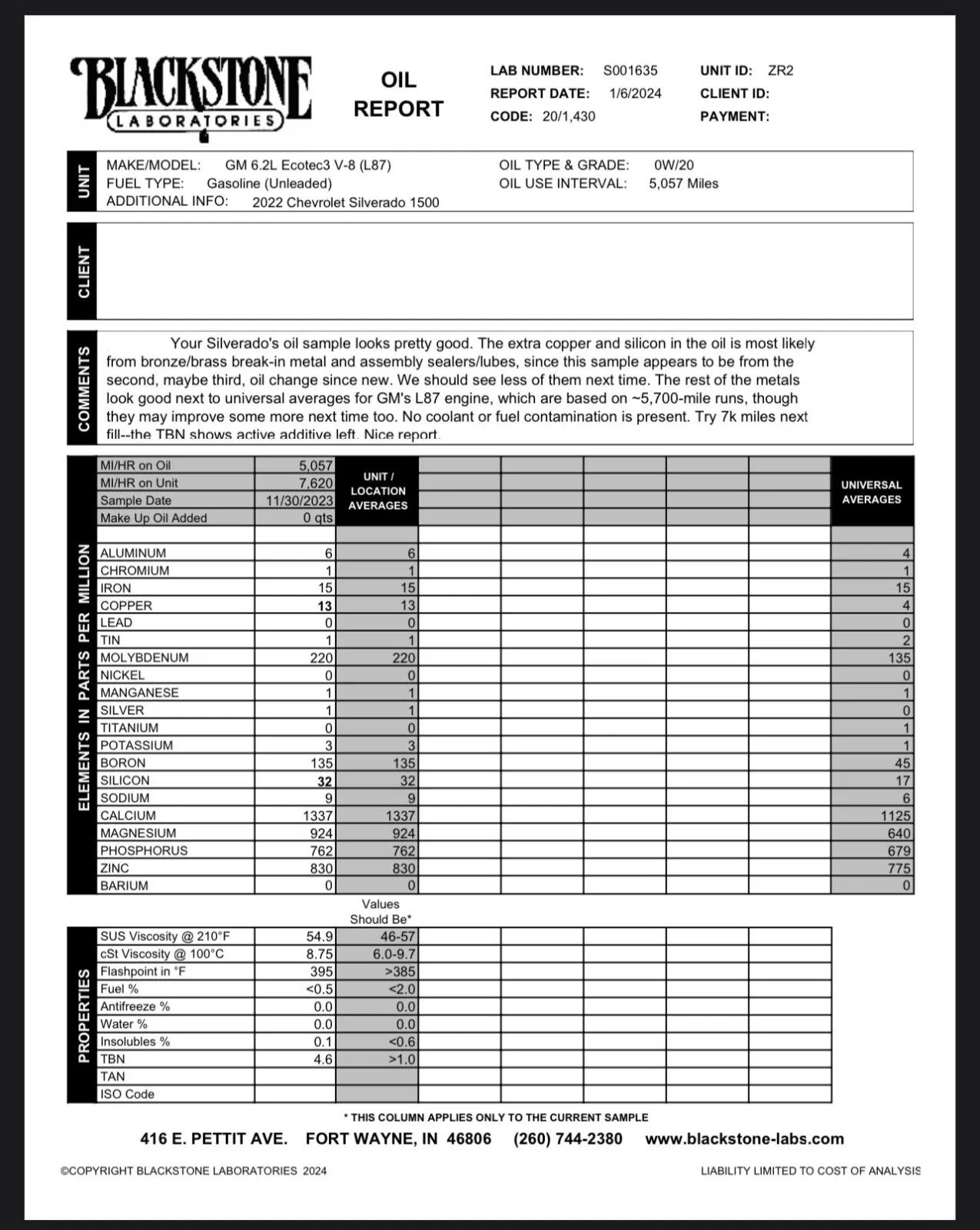

I got the results back for the 10K miles oil analysis on the ZR2. One key difference on my 22 ZR2 is that this change was done at 2k, and was the fourth oil change (1500, 4500, 8000, 10000).
A few differences include higher iron and lower copper for wear metals. Lower molybdenum for the additives.
Looks like both are similar in terms of average wear, so I'll probably feel comfortable running 5k intervals, which seems to be about 70% +/z

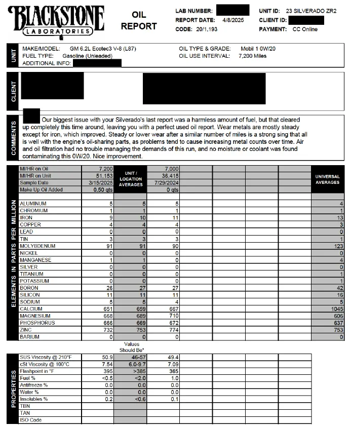

Got my first lab report the other day on the baby max. I did the first oil change at 2,469 miles. This one was done at 6,686 miles. I plan to do oil changes every 5,000 miles in the future, unless the lab reports dictate otherwise.
Got my second report done and all seems to look good. I'm pushing 51k now and haven't babied it at all. Letting the suggested oil life from the gauges guide me and getting about 7k between changes.
Those are some great numbers, any time you can stay below 10 parts per million in wear metal it is great, when you are 5 parts or lower that is fantastic, that thing broke in and is wearing great, I’d stick with the M1 for sure cause that motor likes that formulation.
