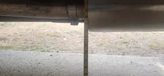

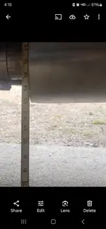

hope this helps. its front pic.

That is helpful. If you are measuring from the ground, then it looks about the same as mine and red454s setup. That eases my concern that I might have installed something wrong. Thanks all!
i also looked at your photo and compared to my muffler. imo, they look the same. muffler is pretty well tucked in there. i think yours is fine. whats your opinion on the Borla? i think it really wakes up my ZR2. its not the "S" type shotgun blast on startup and when you punch it, she growls with no drone at speed.
